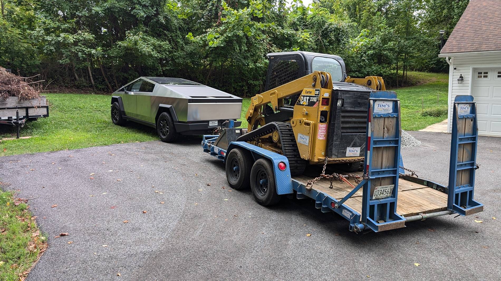

Mine hardly has a drop but when I left the rental place, the excavator's trailer looked low enough to hit speed bumps. I flipped the hitch at home for the trip back.
