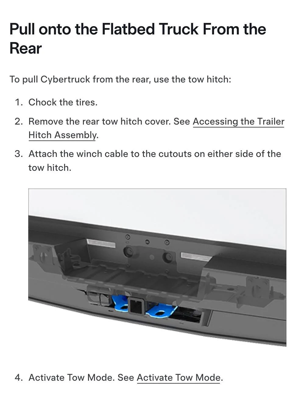

I’m curious about one important thing. How will a tow truck driver load the Cybertruck onto the flatbed without these tow points? Or do you think you’ll never require the services of a tow truck notwithstanding all the posts to the contrary on this forum?
May 27, 2024
4,652
5,652
Winching from the rear is fine

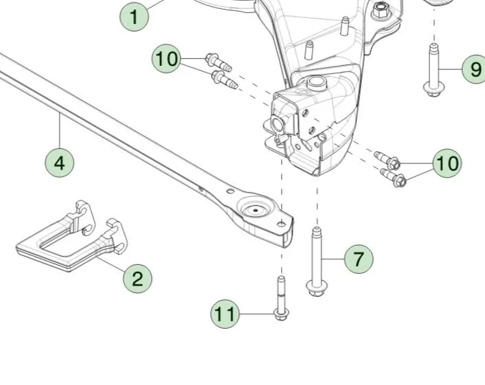

FWIW, the parts catalog and service manual also call out covers that go where the front hooks are in place of them. Haven't seen a tow hook to go with that setup though...
