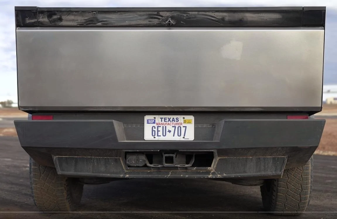

Has anyone seen the rear end well enough to tell what is needed for towing?
Do we need just the hitch ball? The tongue and ball? The whole assembly?

I think that was a prototype. Here seems like a current one.
X/twitter linked to picture
So you'll just need a ball mount and a ball. This photo shows a hitch pin in the receiver, but if the truck is delivered with the pin you'll probably want your own locking pin, too.

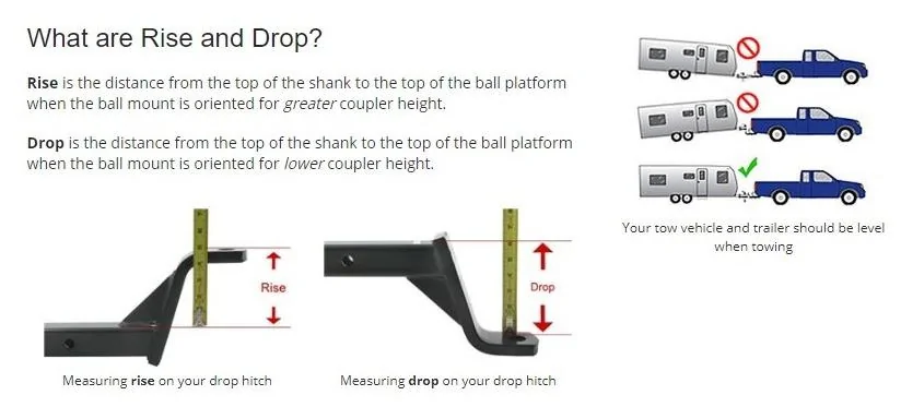

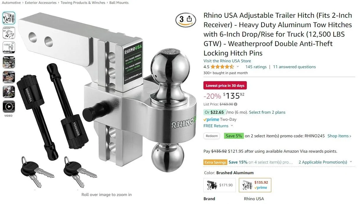

Wondering if an adjustable one will be useful ... considering the adjustable air suspension.

Good catch about the adjustable ride height. I might just adjust the ride height to match my existing ball mount rise/drop and use that $135 for more towing classes. :cool:

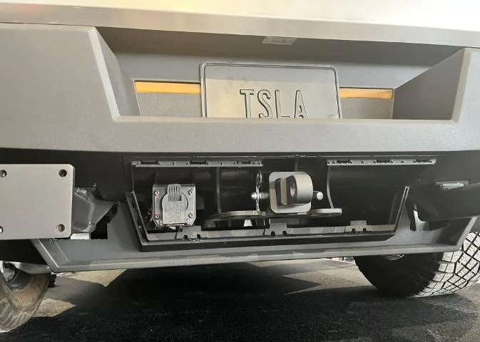

If you haven’t seen the pic of the Cybertruck with the Christmas tree in the back it is in the Ekectrified video this evening at about 4:48 and clearly shows the hitch area.

Saw this nice view of the hitch in youtube vid. Also, chain hooks up and 7+4 pin connector

5 bolts on each side to the "frame" it appears.
Yeah, saw that and was wondering how that stacks up / will hold up with 11k....no idea what my 2500 has holding the hitch on.. maybe will take a look this weekend.
