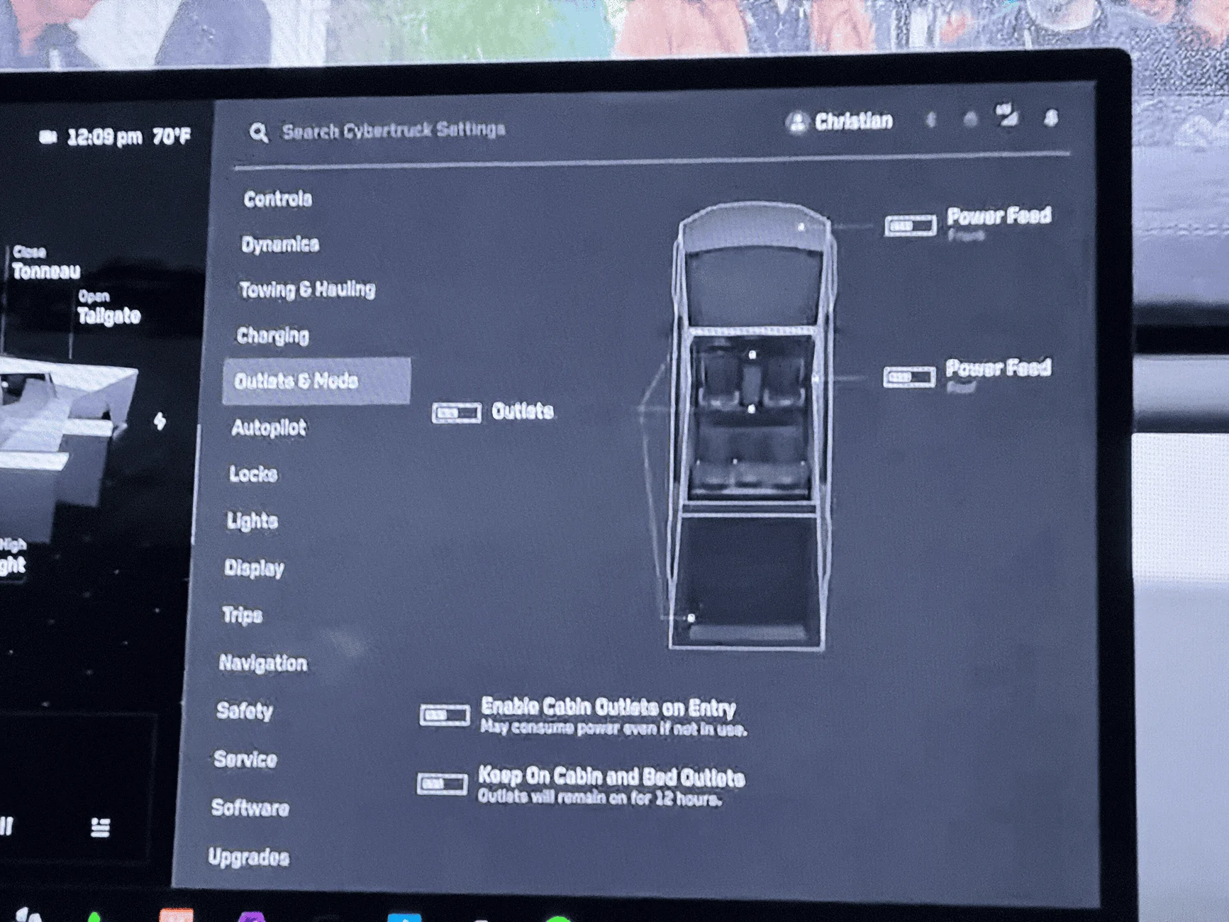

Can the Power Frunk 48V Power Feed be set to turn OFF/ON with the Truck's Wake/Sleep Cycle?

would you be able to send me a few pictures of that?
Ok, here we go, it's in a very tight spot, so kinda hard to see. The 120vac line just goes in between the trim, around to the front, and taps the console outlet.
Thank you! so you tapped into that console outlet such that the console outlet is still active and you're powering your radio device?
Correct! Just like how a house is wired, a bunch of outlets in a row starting from a GFCI or breaker. As long as the entire row (or run) doesn't exceed the breaker current, then you're good.
