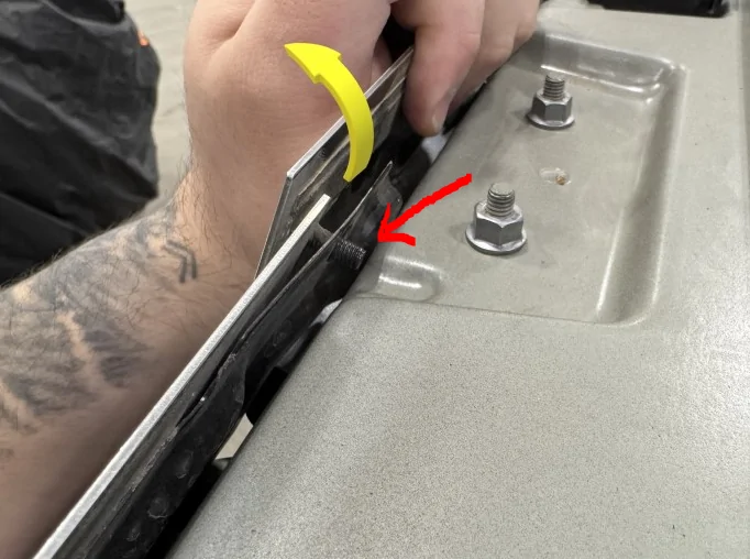

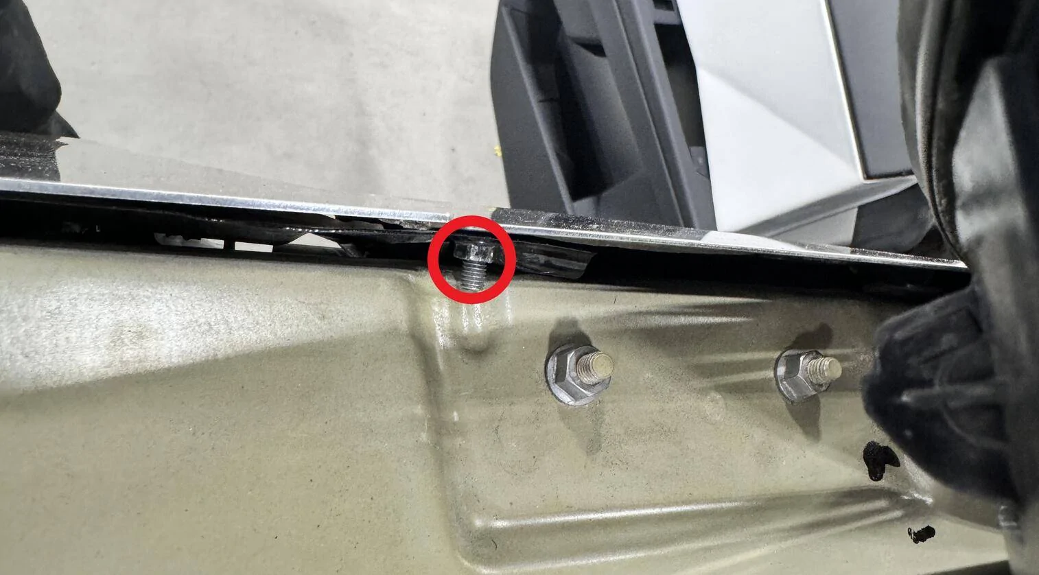

Anyone know the details of what changes they made to the cant rails?
Per recall filing, different adhesive and they are welding the front stud to the stainless piece instead of the carrier bracket. So it will have a direct mechanical attachment point.
