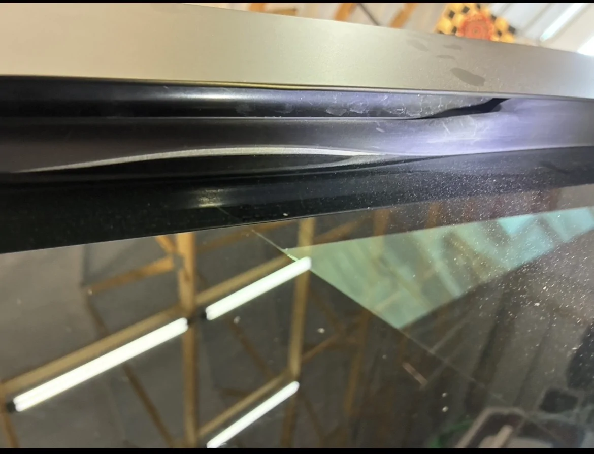

They issued a loaner for me in advance. My service in on Monday and said to be completed on Tuesday. I’m also having them fix this window seal that was installed wrong and they better not charge me as it a defect. You can clearly see the contrail metal squishing on top of the seal. Then an odd rattle that’s been happening for over a year. Happens over bumps as it sounds like a loose air compressor or something in the back. The verbiage about charges in the app scares me but we will see.

I went in hoping to getting the PCS proactively replaced and they “replaced” the cant trail. They didn’t replace but applied updated glue on it. My wrap was still on.
And no, they didn’t replace the PCS.
