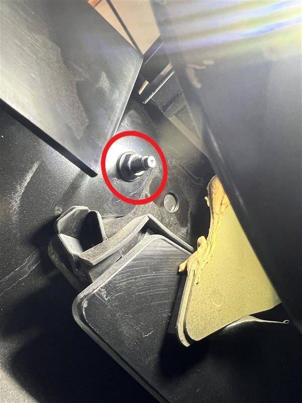

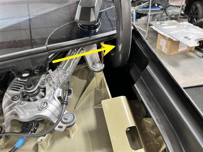

It has two studs, one front and one rear. Front seems more important, probably changed both?
Yes, they changed both.

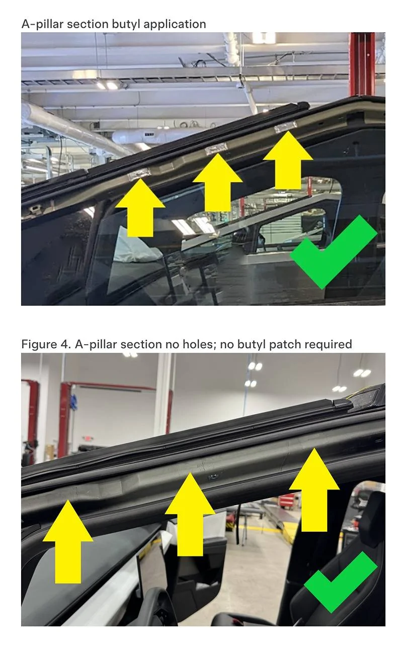

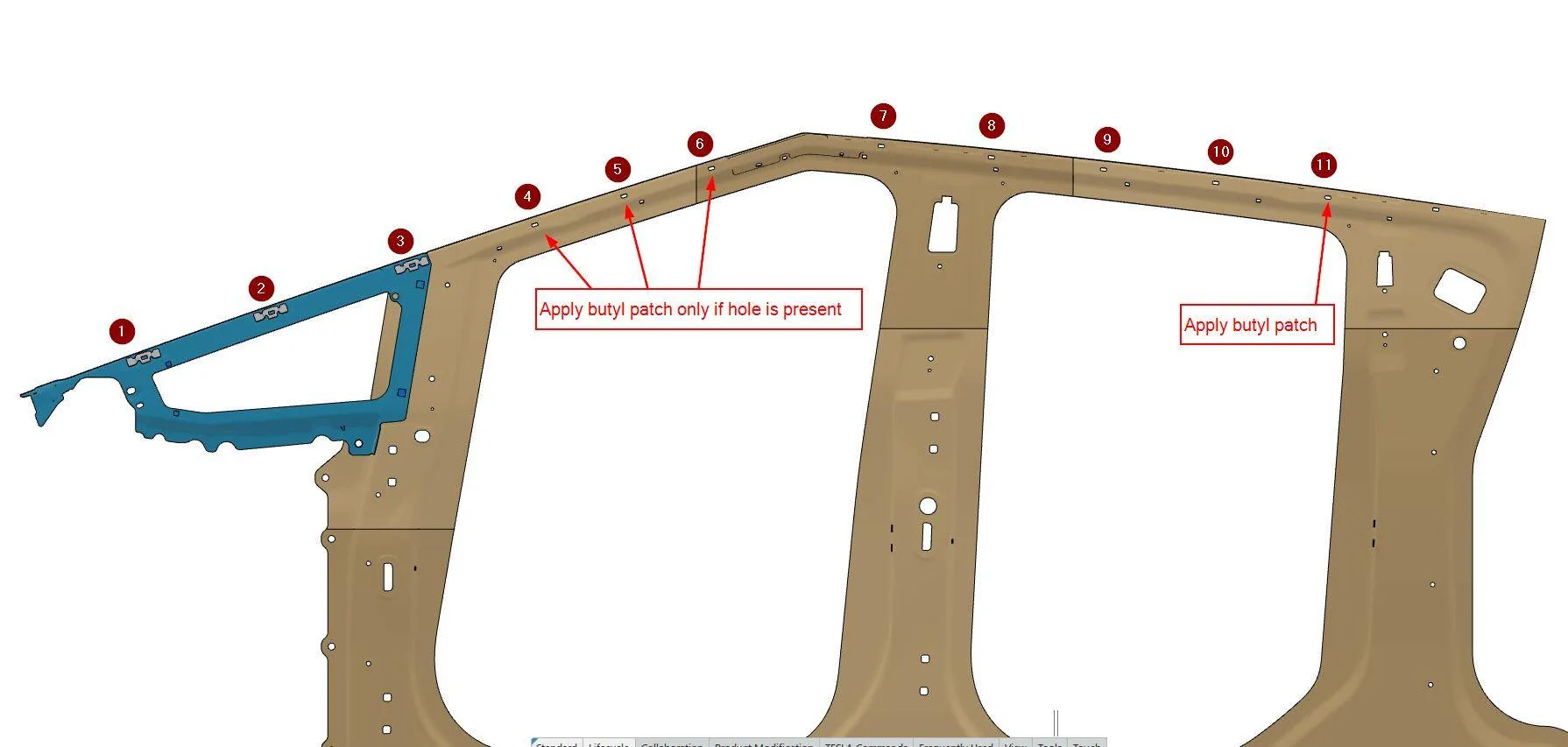

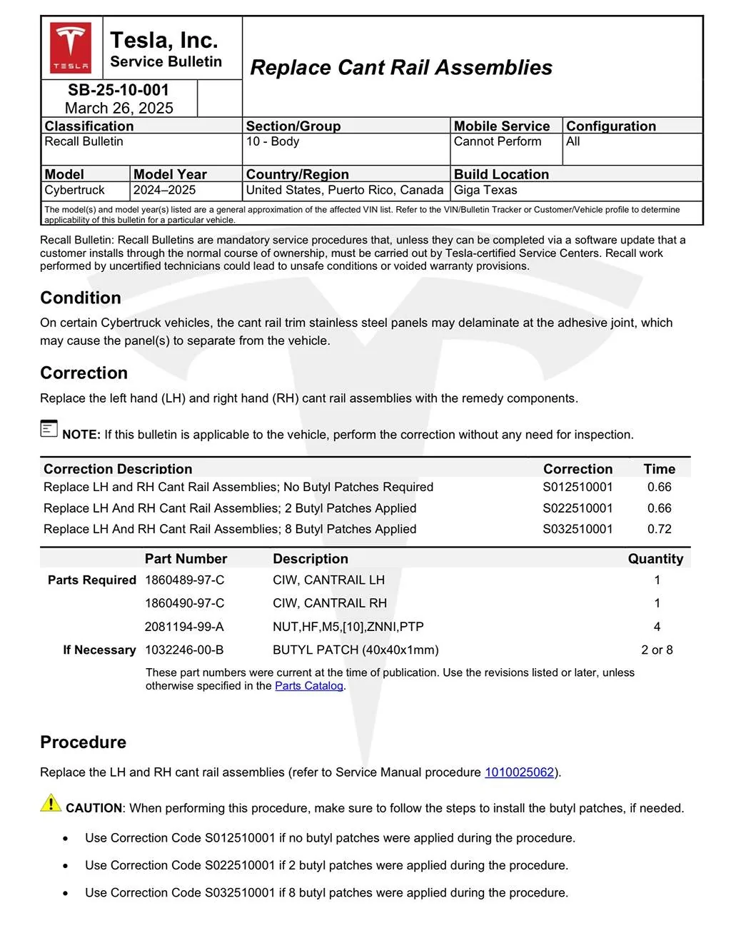

Why are there 3 different option to fix it?
  • No Butyl Patches required
  • 2 Butyl Patches Applied
  • 8 Butyl Patches Applied
There were differences in the manufacturing process since the truck was released. Some have holes in the cant rail, some done. If it has holes, then it’ll require the butyl patch to be installed over the hole.
May 27, 2024
4,618
5,621
Was there a change in manufacturing techniques? Or is it how bad it's gotten? Or something else?
The frame went through some changes, the patches seal the holes under where the cantrail goes. I think these were originally for additional fastening clips. Some frames only need the rear most hole covered (on both sides), others need the fronts also.
Tesla Cybertruck Cant Rail Replacement Fix - Service Bulletin (SB-25-10-001) published yesterday GUID-EA46AE34-C06D-4289-80BE-159CCFF13FCA-online-en-US
Tesla Cybertruck Cant Rail Replacement Fix - Service Bulletin (SB-25-10-001) published yesterday SmartSelect_20250329_075427_Firefox
