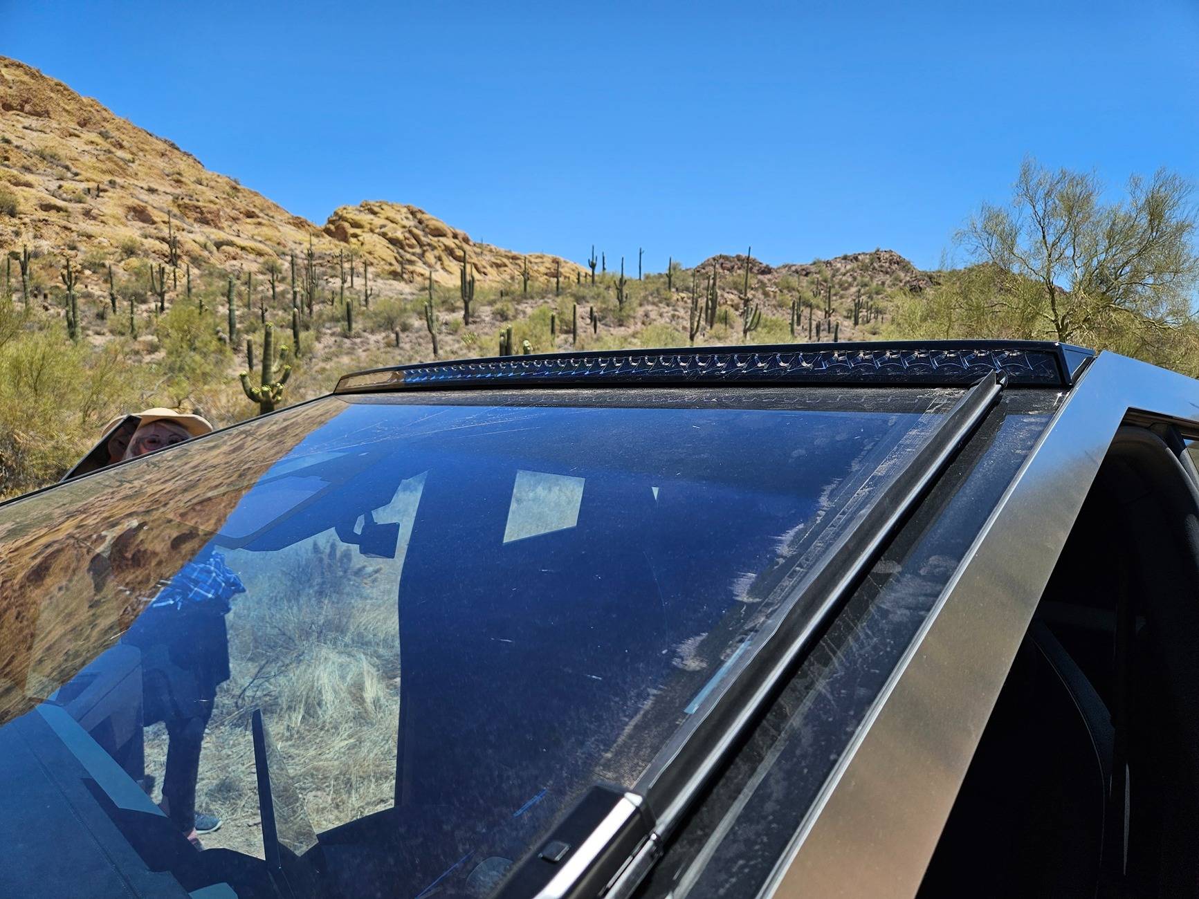

They replaced mine already- I had a service appointment to install my light bar and a few other things. I told them the drivers side Cant Rail looked like it was misaligned and coming loose. They said it wasn't recalled yet ...but they went ahead and replaced them...I had the truck wrapped 8 months ago and now its two toned..What do you all think? Leave it or re-wrap?
I would wrap it to match...that's just me.
