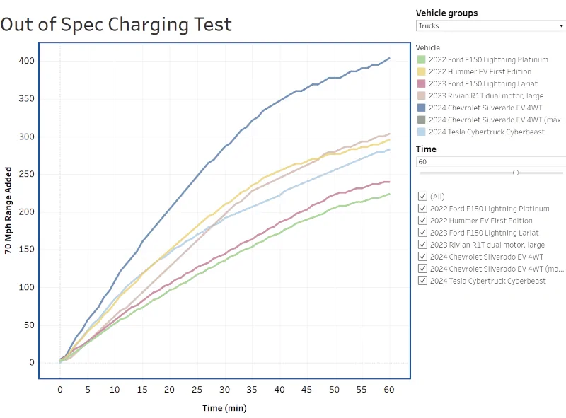

Telsa badly needs actual V4 chargers. They are trying to pump 500A over 400V and that's a recipe for heat. Out of Spec managed to charge at 800V on an Electrify America charger, but had to use an adapter salad. Speaking of which, I need that recipe. CCS to NACS with a NACS breakaway adapter?
Good thing Elon just fired the entire Supercharger team. /Sarcasm
Update, Kyle from Out of Spec just gave more details on the adapter setup he's using in their latest video (1k mile trip to California). He says he's using the Telsa OEM CCS adapter and EVJect. The adapter manual doesn't give me a current rating (says up to 500V), but the description says it can do 250kW which would put the current somewhere around 500A. Kyle thougth it was being pushed beyond it's limits at over 300kW that he was charging at, but said temperatures were acceptable.
If it's really rated at 500A, it'd be easily able to reach 400kW charging at 800V.
