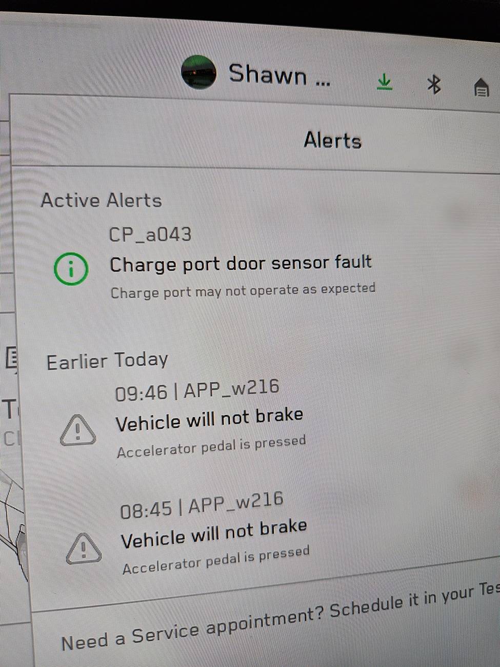

Do you have this message? I do and have been having problems with my charge port door.
Tesla Cybertruck Charger release not working 1000011715
