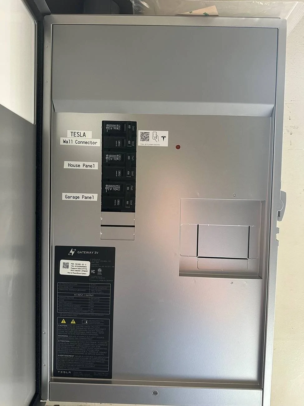

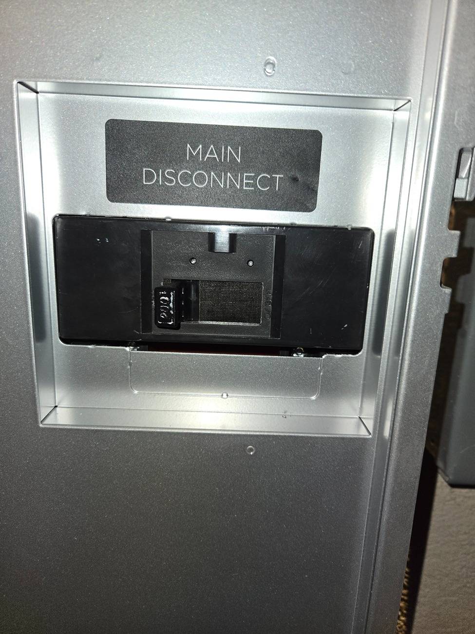

Norm

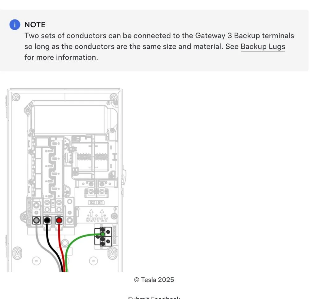

I don't think that they installed it correctly. Since they didn't connect the in coming power using a main disconnect breaker, they might have bypassed the internal, automatic disconnect switch that is used in a grid down situation. Could you take the panel off your gateway, take some pictures and post them so I can see how they routed the incoming and out going power lines?
Is your (House Panel) and your (Garage Panel) rated at only 100 Amps each?
My entire main panel (whole house) is backed up by PowerShare as well but my main panel is 200 Amps so they installed a main breaker in the blank spot that that's not being used in your gateway.
Tesla Cybertruck PowerShare Gateway New Install not working! 20250209_053645
Tesla Cybertruck PowerShare Gateway New Install not working! IMG_20250209_053303
May 27, 2024
4,730
5,786

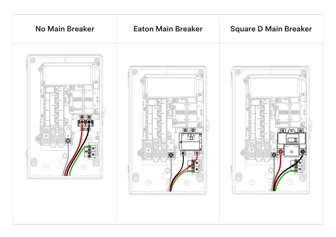

The power input doesn't require main breaker.
The transfer switch could be bypassed if they did it really wrong and used the double the output lugs. However, given the lack of a main breaker there must be a disconnect between the meter and Gateway.

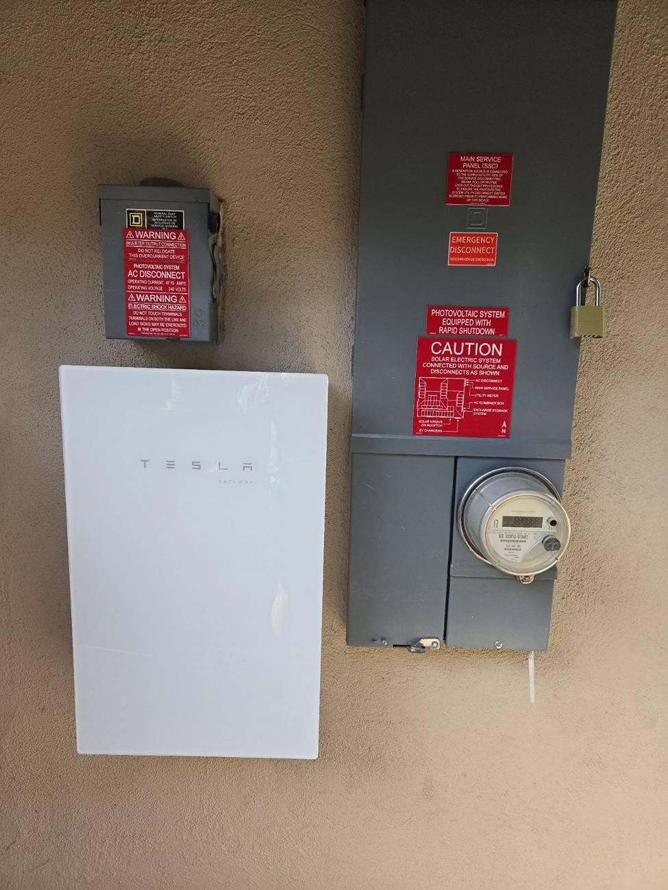

Tesla Cybertruck PowerShare Gateway New Install not working! SmartSelect_20250209_101244_Firefox
Tesla Cybertruck PowerShare Gateway New Install not working! SmartSelect_20250209_101544_Firefox
rjbonds
Randy
Jun 4, 2021
Brea, CA
CyberTruck Tri-Motor
PA
Copy that, but given the fact that the installer said that the solar panels would be feeding the grid if the cybertruck was connected makes me think that it was not installed correctly.

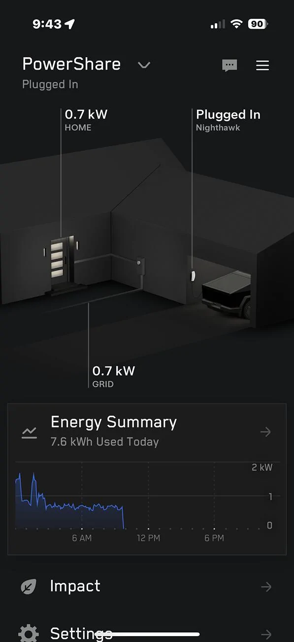

When you have time could you please post a screen shot of : PowerShare showing in the app, and when my CT is plugged in
And a pic if you have seen one of:
switch in the charging section of the setting on the truck to enable PowerShare has yet to become available
Would be helpful to all so we know what we should be looking for on the app when this is working. Thanks in advance

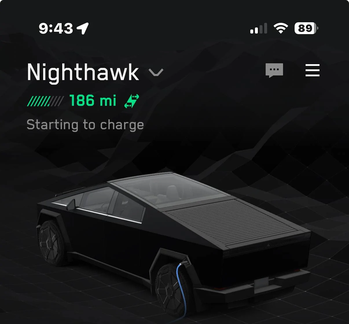

Sure. I done have the switch in the charging section of the truck yet. The PowerShare shows up as a “Site” in the app, swiping right or left can get you there.
Tesla Cybertruck PowerShare Gateway New Install not working! IMG_0527
Tesla Cybertruck PowerShare Gateway New Install not working! IMG_0528
Oh, I don't see that in the post.
Could it be the setup is
Meter->Enphase with service disconnect breaker->Gateway->two panels?
rjbonds
Randy
Jun 4, 2021
Brea, CA
PA
That possible but they should have moved the solar panel feed to the house side of the Tesla Gateway.
