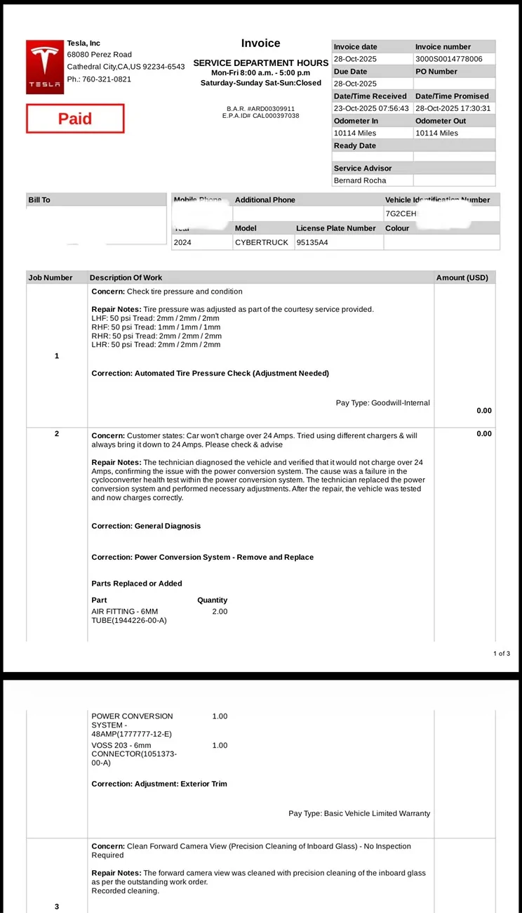

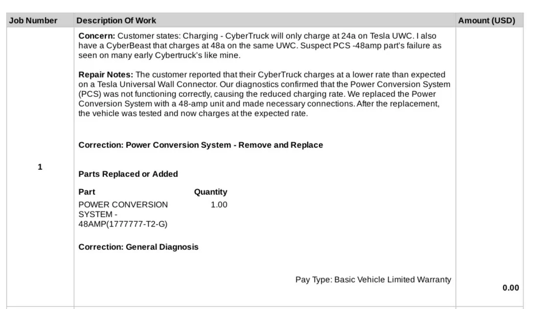

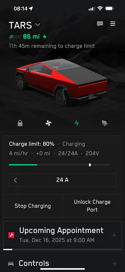

Yep, mine does this.
Preconditioning triggered a charge cycle:
Tesla Cybertruck Charging reduced to 24 A. AISelect_20251211_100125_Firefox

this should be a recall.
