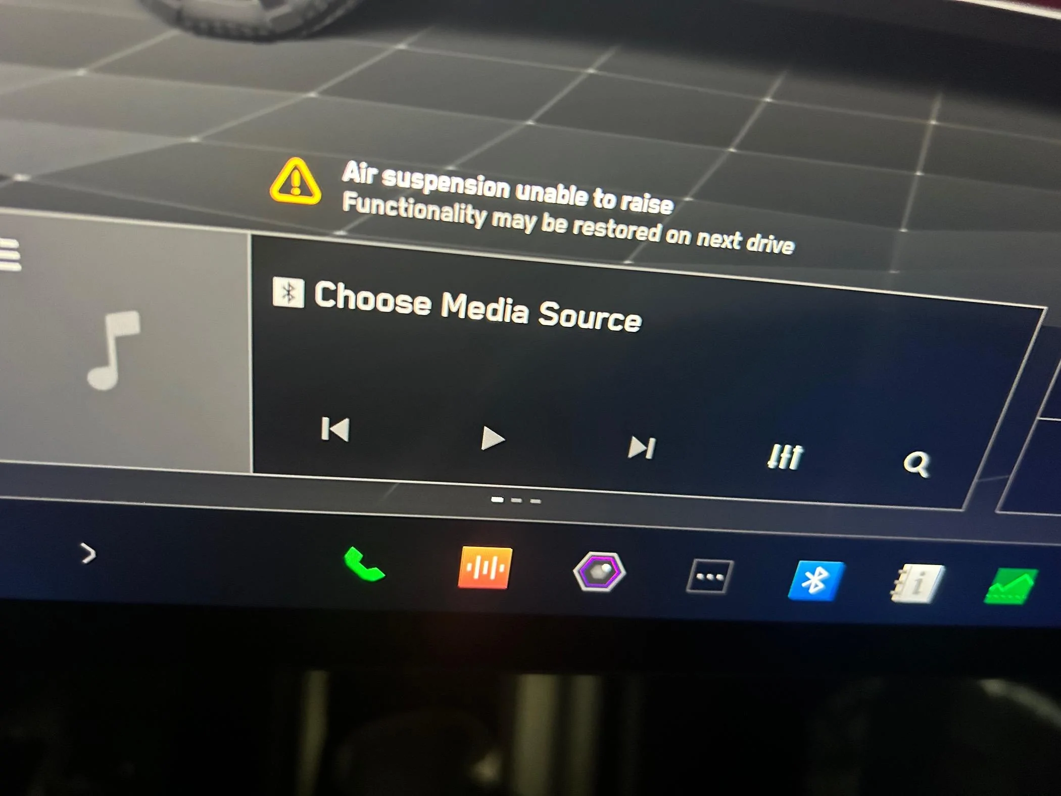

Hello Tesla,
I have been a very long customer of yours starting with the Model X. I am sad to say within the first week or so owning the Cybertruck, I got an error stating the suspension can not be lifted or lowered. Now I feel like I am driving a tractor and not a 100 k truck. I then set an appointment with the nearest service center and they can get me in a whole months and half later. I would expect to be serviced a lot quicker as the manager at Indianapolis gave reassurance. I am going to continue driving as is because I don't have a choice I have spent all my money on this truck.

Hello Tesla,
Ouch! That is unfortunately. At least with our issue regarding the suspension alert, our truck still functioned fine on that end. And has since been resolved with the first service center visit (albeit after a couple of months waiting to get the truck into there in the first place). Seems like a long wait to get a service center appointment is pretty standard now with all of the staffing issues Tesla is having. Better hope they fix your issue the first time unlike with one of my issues. Can you imagine waiting months to get into the service center, have them work on it, tell you it's fixed, you take it home and immediately see it is not fixed, reach out, and them tell you it'll be another several month wait to be seen again?
Yeah.... That's my situation right now. :(
