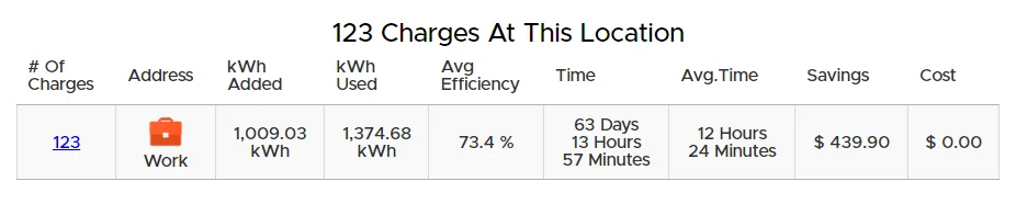

Back when i actually went to the office and i level 1 charged:

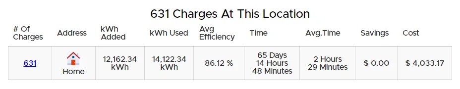

when i am home level 2 charging:
Tesla Cybertruck Home charging Cybertruck using Tesla Mobile Wall connector? 1711629640225-2q
level 1 charging is more wasteful,
lets just assume the thermal system (pumps, heatpump, pack heater, etc) consumes 500 watts, that is 500 watts not going into the battery. Example math:
16 amps x 120 = 1,920 - 500 = 1,420 charging watts 74% efficient
16 amps x 240 = 3,840 - 500 = 3,340 charging watts 87% efficient

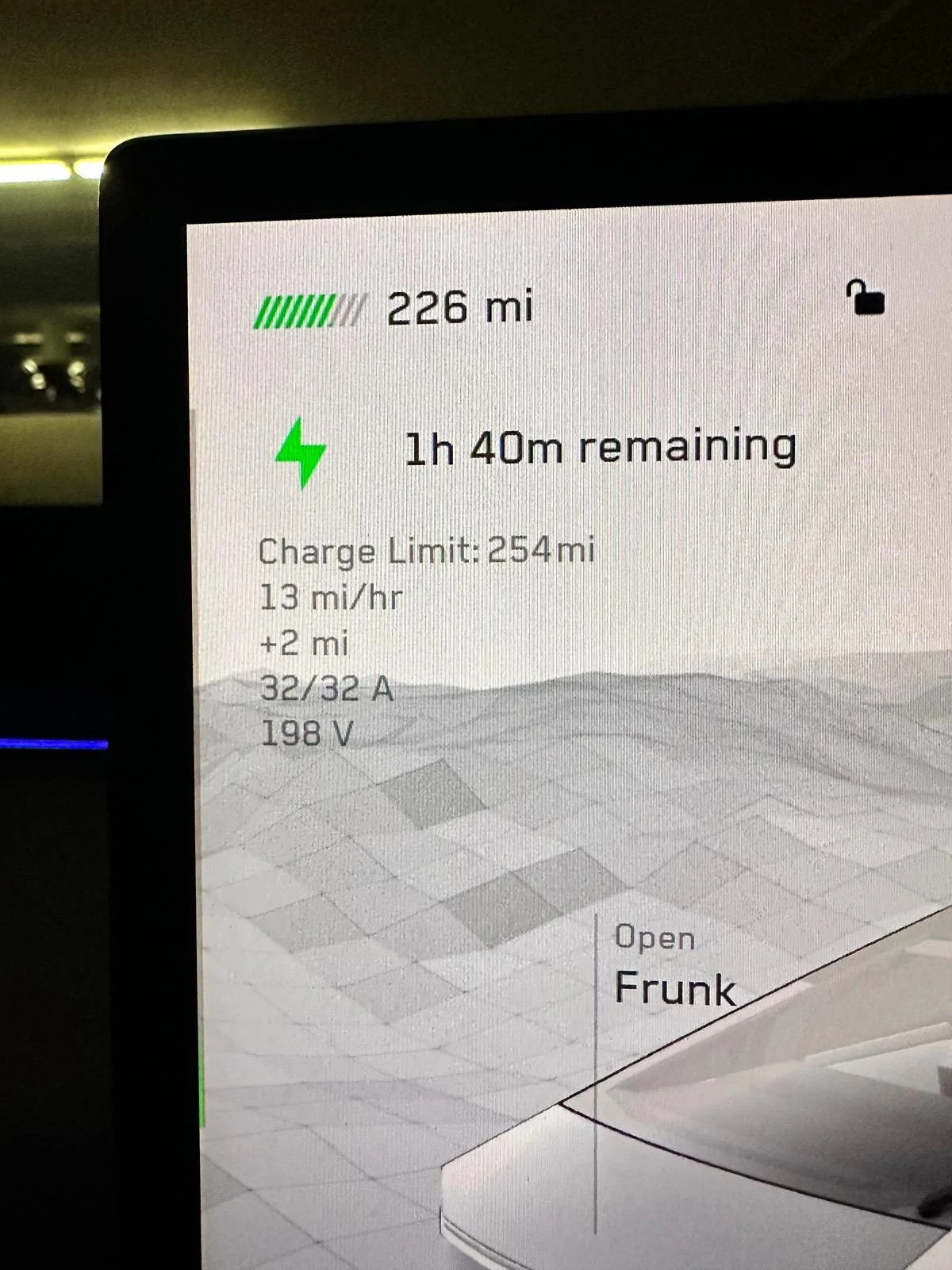

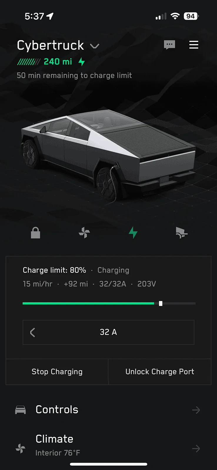

We have two different chargers at our condo and both times I was getting 13-15 miles added per hour.
is this in line with what everyone else is seeing on 32amps? Our model Y long range gets over 24 added miles per hour on the same chargers.
It's showing 198V and 203V. That's going to cut your charge rate by around 17% versus a 240V connection. Do you know if the power at the condo is 208V (three phase wye)?
Can test by reducing the charge current and checking the voltage. If it stays around 200-208, that's okay, if it rises to 240 there is an issue between the transformer and the vehicle.
Cybertruck will add less miles per hour of charging than a Y at the same charging power level due to its higher Wh/mile consumption.
