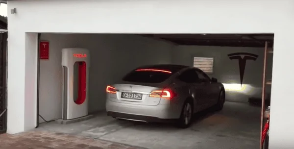

How many people have electrical service with 100 amps of extra available capacity? VERY few I'll bet (I'm sure I'll quickly hear from a few people here who overbuilt their system. But that was probably a mistake) The electrical upgrade needed to add a significant amount of current to boost your CyberTruck connector would almost justify installing your own DC fast charger instead. There are so few people who need it that it would be rare for anyone to upgrade their Level II connector.
200-225A main panels are exceedingly common in newer construction and lots of 3500+ ft2 homes have dual 200s or a 400A commercial style box. Theres enough top end room for a 100A breaker in more homes than you realize BUUUT that might change over time as more and more people use electric for heat, hot water, clothes dryers, and ranges.
as far as increasing the service amperage from the street, thats expensive but a good percentage of people adding in a 60A breaker on a 100A main thats utility limited would have to spend that regardless and vs bringing in a DC pedestal, still much much more cost effective especial if service is flying in overhead
