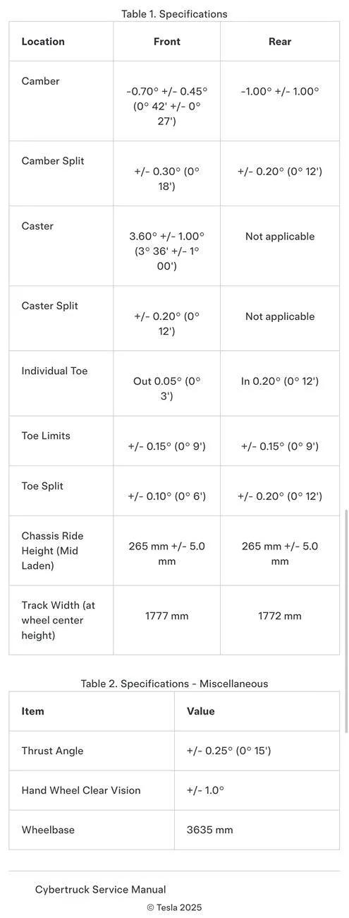

Some will say, close enough but if the machine can be calibrated and used to deliver higher precision then I will use it.
0.01 deg = 0.6 min
0.004 deg = 0.24 min
The thrust line went out at 0.02 degrees (1.2 minutes), if the technician saw that and cared, perhaps they would have shot for a better number. If the front was displayed in deg/min, the tech might have paid more attention to the big number rather than just squeezing it into the “green”
