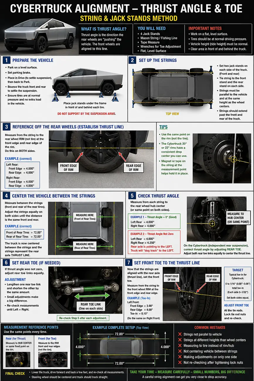

How do you measure the thrust angle using these tools?
That one is a little more complicated. Involves string and jackstands.
If you do the string and jackstands method you can get the toe angle sorted at the same time as the TA If that’s something that interests you.
AI Generated - maybe @mrcarcrazy can proof read and recommend corrections. If this is total BS, let me know and I will delete the post.
Tesla Cybertruck 3rd party alignment CT Alignment - String & Jack Stands Method
