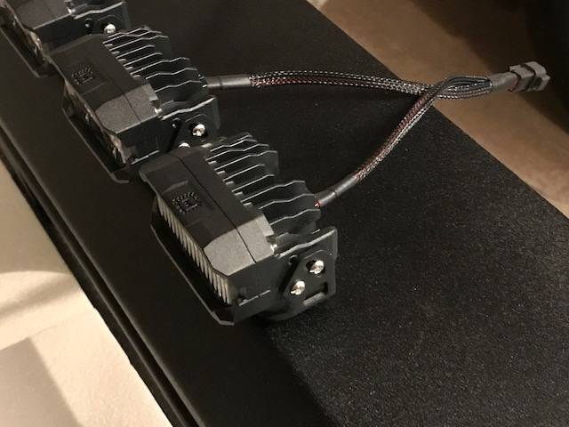

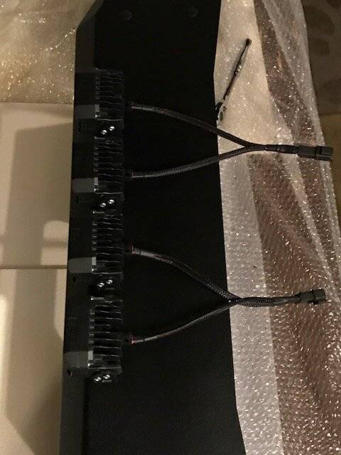

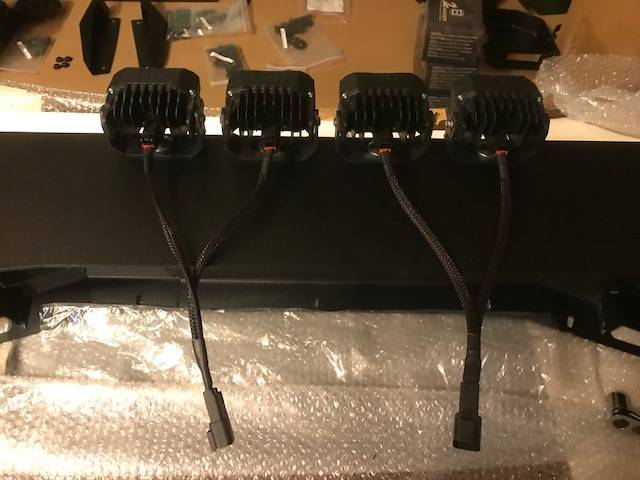

Looking at T-Sportlines pictures they appear to be mounting the 2 banger Morimoto's lights with one bolt each. I circled one in the picture. Morimoto does sell a link kit so you can make a lightbar (bangerbar) out of them and have mounting points only on the ends.
https://www.morimotohid.com/Links-Mounting-Accessories-BangerBar-Single-Row-2Banger?quantity=1
You'd have to buy 3 link kits $105. If you went that route the two middle holes could be used to route the wires under the lights rather than the back of the bumper. Each light comes with a mounting bracket which 2 could be modified by cutting one end off. A file and some black spray paint and who would know. I put a red line on one of the pictures. That way the slot on both sides will allow for positioning. Morimoto does sell an end kit at the same link but the holes would not work for mounting.

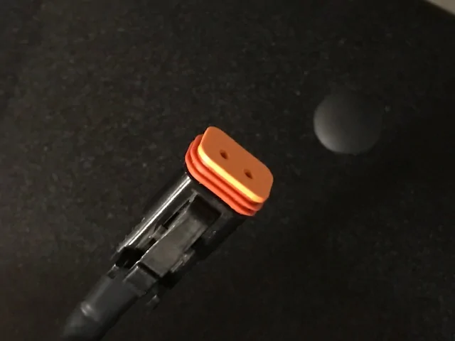

I like this idea. The mounting holes are too small to feed the connectors through, so I need to see if the connectors can be disassembled to feed the wires.
I also wonder if there are right angle connectors, so that the wires would run to the side rather than straight back.
I haven't seen 90 degree connectors for these, but that doesn't mean they dont exist!
Yeah the hole would not fit the connector but the Morimoto lights use a standard DT connector. There are many for sale on Amazon like these. I bet the holes are big enough to feed two pair of 14-16 gauge wire through.
https://www.amazon.com/JRready-Waterproof-Connectors-connectors-Connector(ST9020/dp/B09MM9VGNZ?th=1
Then splice and dice out of view and the bare wires could be hidden in wire loom or shrink wrap.
https://www.amazon.com/s?k=mesh+wire+loom
https://www.amazon.com/JANDECCN-Terminal-Splicing-Connectors-28-12AWG/dp/B0BWTF8QZW?th=1
