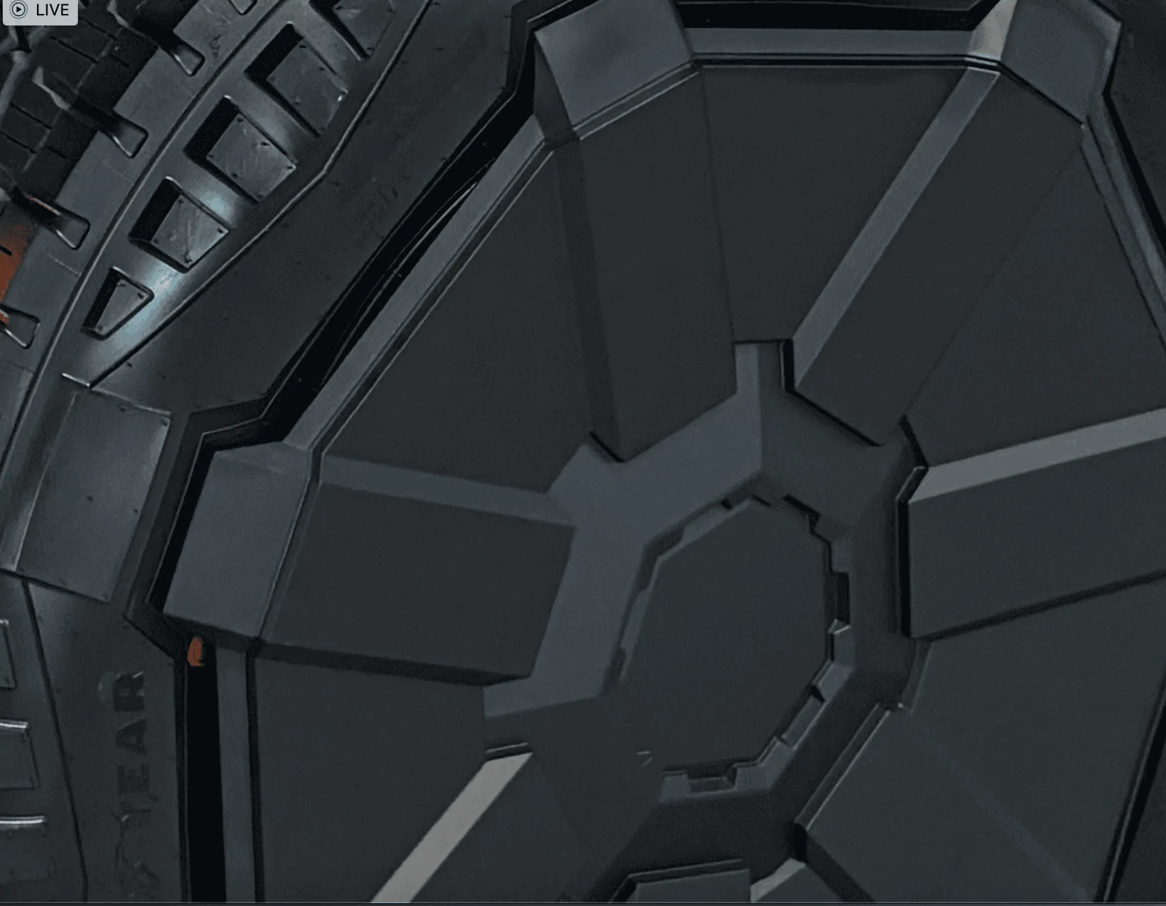

Was it the local Tesla that told you that? I asked the technicians (three of them looked at my wheel covers today) if they had heard about a recall again and they said no. They also said that a lot of times people coming in hear about recalls before they do (which I thought was odd).
Yeah, it was at my local southern CA Tesla dealer at their showroom when I was picking of my CyberBeast a couple weeks ago.

Picked up my beast with AT + covers 8/24. They've stayed on so far, hopefully it was a fluke for you. Fingers crossed
The new Cyber AT wheel cover still extends well beyond the rim to go over the rubber tire. When you hit a pothole hard enough, the tire will bulge out far enough to pop the wheel cover off. It will happen by design.

The newly designed wheel covers were on my Beast delivered last week in Raleigh NC. The service center said they were the first they had seen. I noticed two were not seated properly all the way and had to bang them tight with my hand clenched. They have not fallen off so far. Will update here if they do. I will be putting them through some rough forest service road driving this coming week.
I have the AT tires.

Obviously Tesla did not do it on purpose. It was poor engineering. The original problem was pretty obvious that the cover sticked out too far to rub against the tire. They pulled it back but it's still not enough. When you hit a pothole or go over something (curb, rocks, etc.) hard enough, the rubber will flex and bulge out far enough to pop the cover loose. It's unintentional but the current design asks for that to happen.
I am really thinking (and hoping) that was the case for mine - that they were not seated correctly. The service center said they don't check those before you pick up for delivery. The truck is however it came off when it was dropped off. So, perhaps I just did not do a good enough inspection at delivery. Everyone else should just really make sure they are all on properly.
Mine have not fallen off since I was at the service center earlier this week and I hit some similar road conditions.

Update: I've driven over 1,000 miles since the wheel covers came off and at this point, I think it was just an issue of them not being installed properly and I didn't check them when I picked up the truck. The lesson then is to probably take all the covers off and make sure you put them back on as the instructions describe. Kind of a pain, but so was chasing down two-wheel covers off the side of the road.
