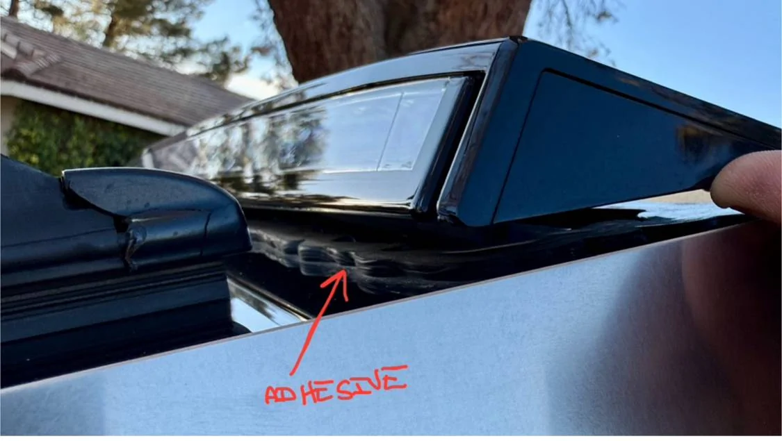

Anything with glue or adhesive is really a silly idea on these trucks. The heat in sun light warming it up. The cold in winter. The high wind lift at speed. This is a stupid design. They need a bolt on option. They will all fall off eventually.

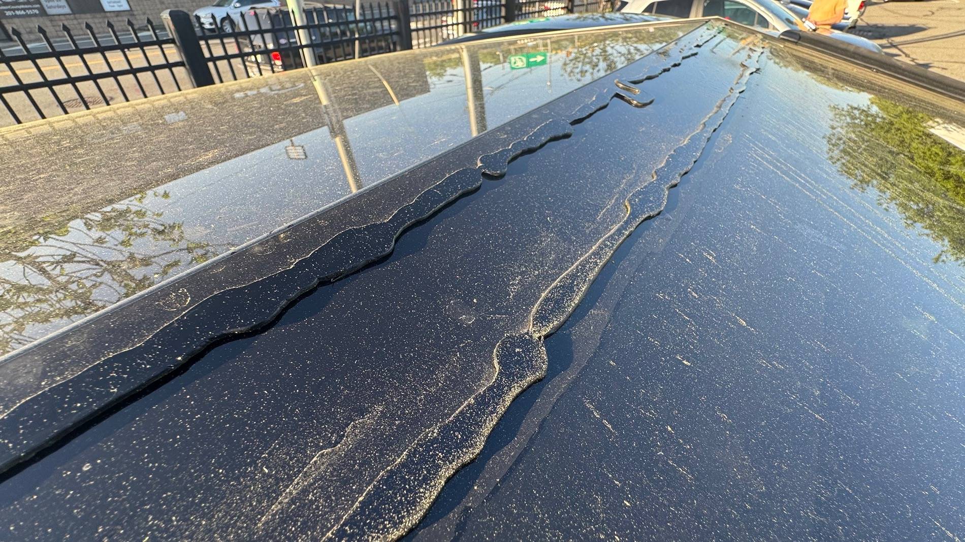

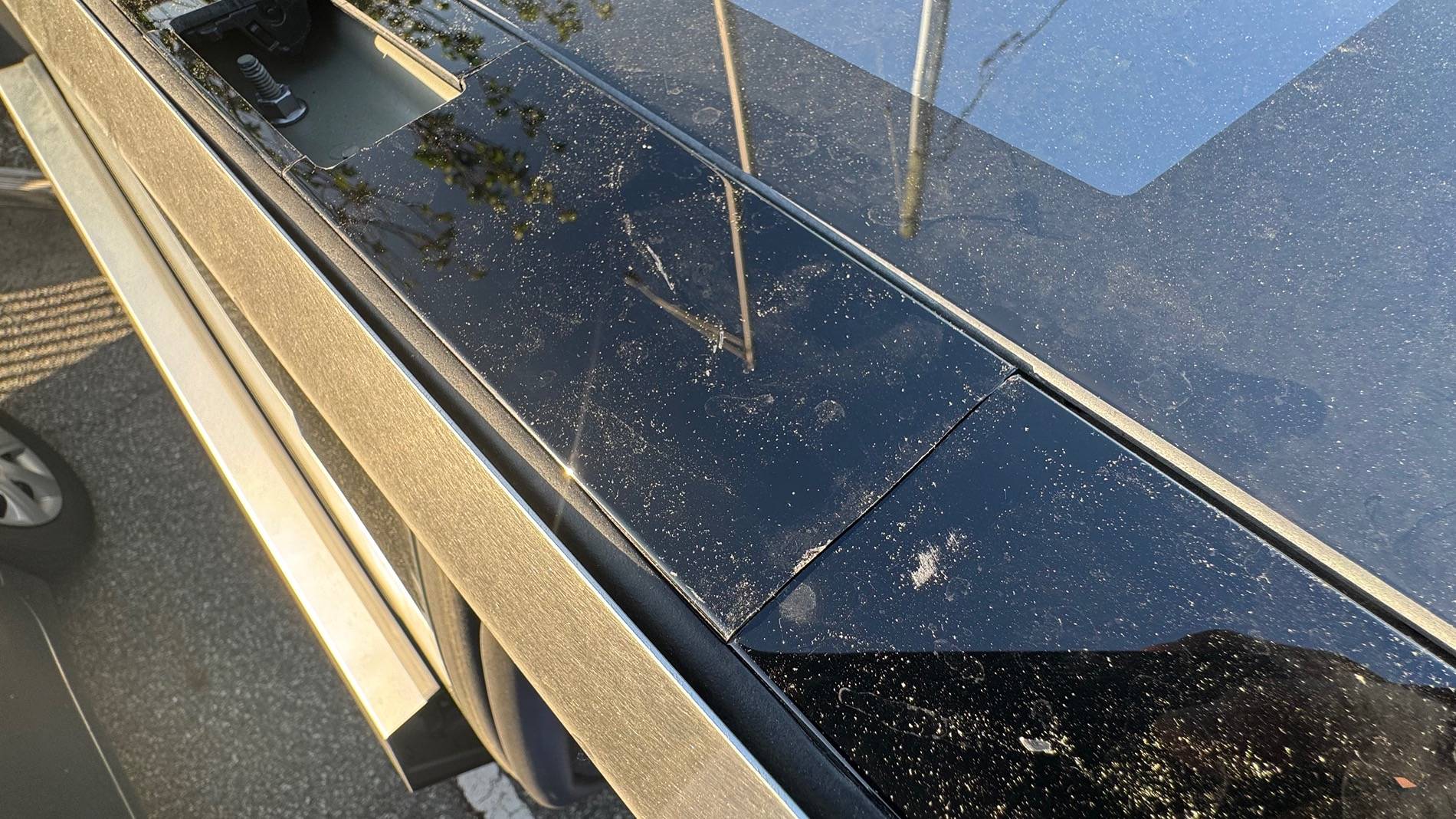

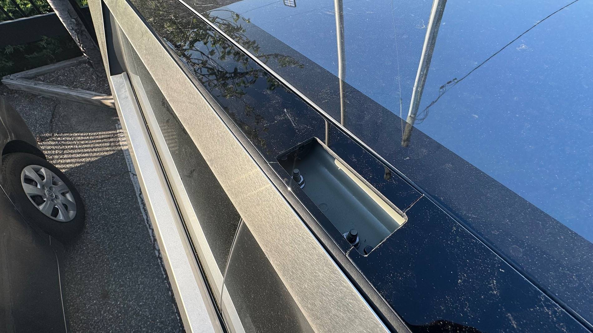

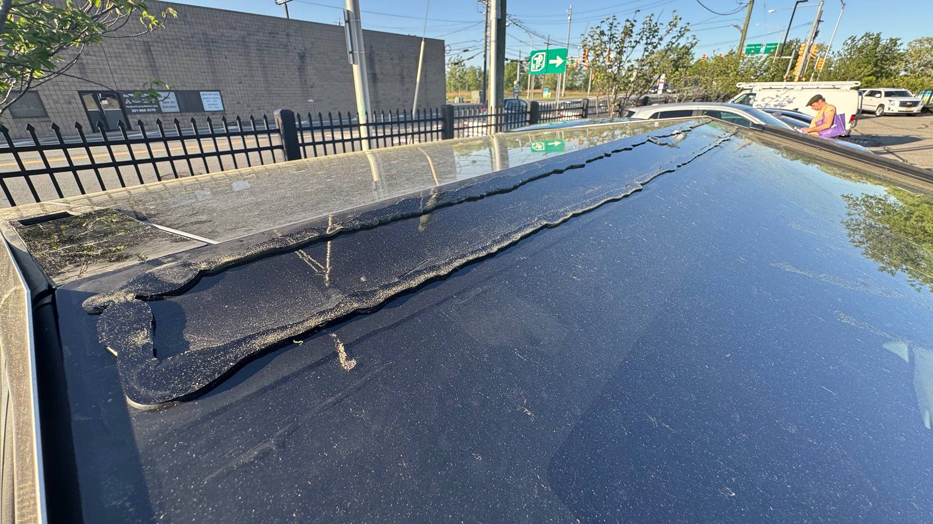

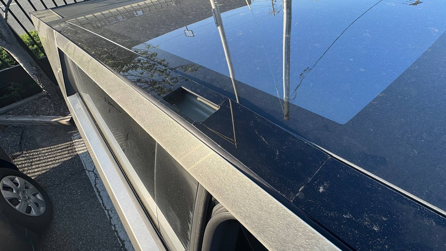

Need advice. My factory OEM Lightbar just flew off my truck while driving on the highway. Luckily no one behind was injured nor did it cause any damage to any vehicles behind me but the Lightbar is pieces across the highway. In addition, where the harness feeds into the car on the driver side, the plastic rail broke into pieces. I was able to “snap” into place. The Lightbar was installed in February of this year.
Question? Is this a Tesla responsibility as the adhesive didn’t work? Or is this an insurance claim?
If Tesla responsibility, do I set up service through the app and explain details there? Or do I pay a visit to service center. The service center that installed was Springfield, NJ SC.
This sucks!!!

Waiting on version 2. This light bar is crap. It looked horrible sticking to the windscreen. The ugly and un- even adhesive bead was visible due to the huge gap underneath the light bar. The wind noise was loud. It should have a molding between the glass and the frame of the light bar help with the wind noise and prevent the air from going underneath the light bar and prying it off the windshield.
