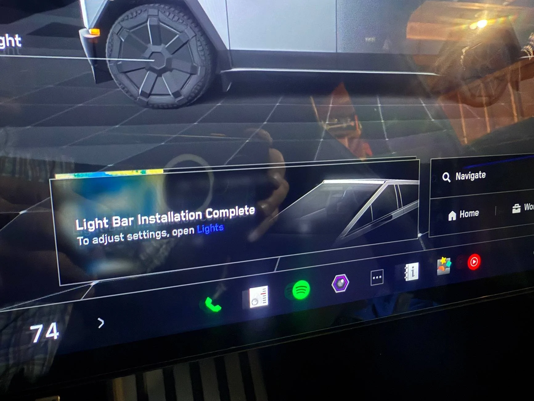

Absolutely understand. Perhaps the reason why no retention form is for removal of device if needed. Also less internal strain on the polymer of the housing so the creep due to thermal variance occurs at the adhesive base interface. It’s perhaps engineered micro dampening at the molecular level. Great news my bar is installed. I hooked up the light after said power disconnect and it works great. The SC confirmed use of BOTH distinct primers on the appropriate surfaces. Cheers to a fellow tooth carpenter!!

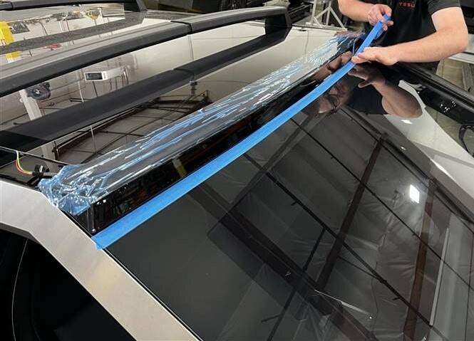

I was supposed to have my lightbar installed on May 30, but the service advisor said a new primer is specified and that is backordered till July.

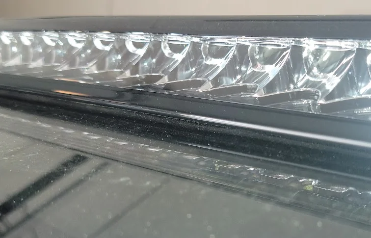

Good to know. I just got mine done on Wednesday and was not impressed to find that they didn't even attempt to clean the surface of the windshield. It was pretty filthy with dirt collected in streaks from the rain off the wiper. They just glued it in place on top of all that crud. :mad:
Tesla Cybertruck Lightbar flew off while driving on highway!! 1748708439309-fn
Tesla Cybertruck Lightbar flew off while driving on highway!! 1748708488049-74
May 27, 2024
4,521
5,499
Huh, there should at least be a clean line where the tape was

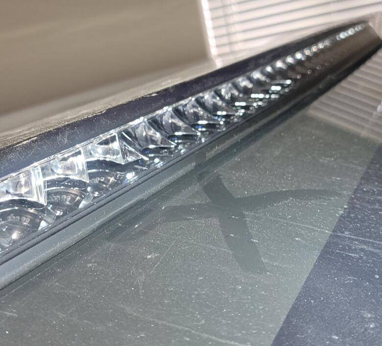

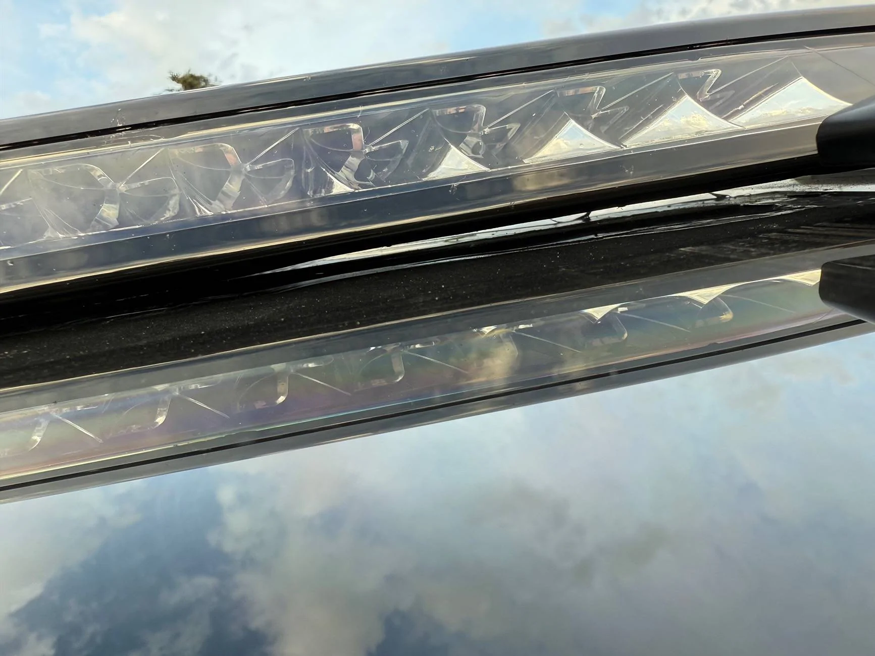

Got mine installed on 5/8. I’ve checked a few times to make sure it’s still solid and I just noticed that it’s starting to lift off the windshield on both driver and passenger side. Service appointment made.
Tesla Cybertruck Lightbar flew off while driving on highway!! IMG_5664
Art138
Art
May 25, 2023
1,184
1,088
Weston,Florida
MYP,Ford GT & FS CYBERBEAST
It would be interesting to ask if they used the new primer/adhesive.

The service center guy in my city told me it was actually two separate adhesives. One for the bar and one for the glass.

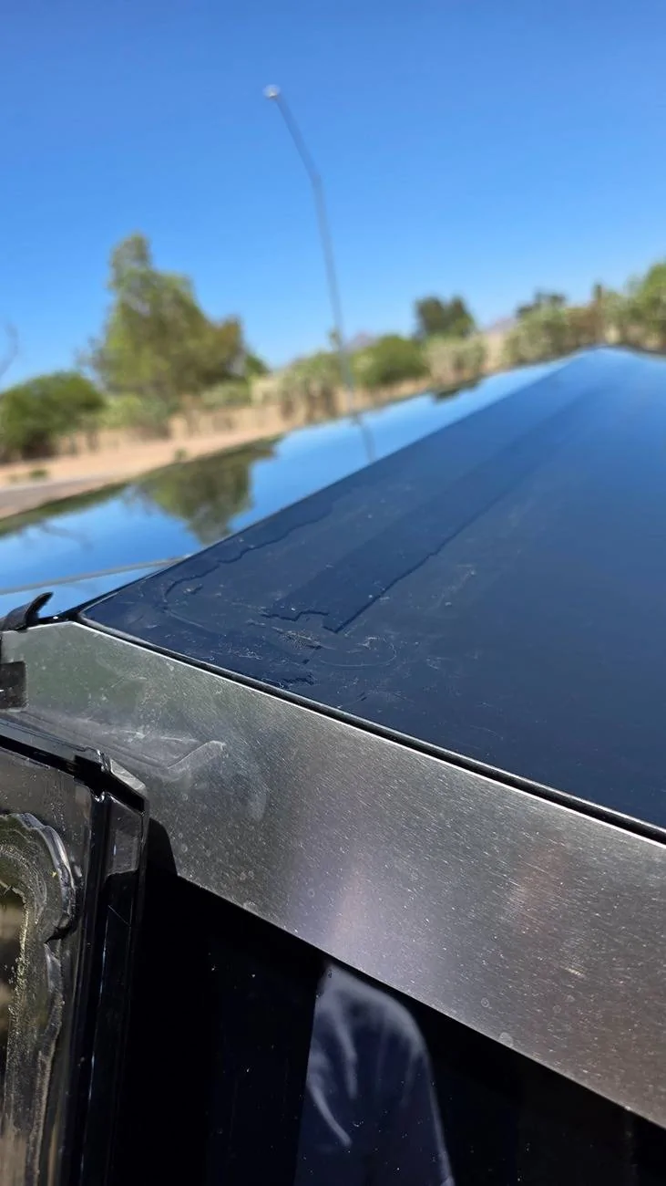

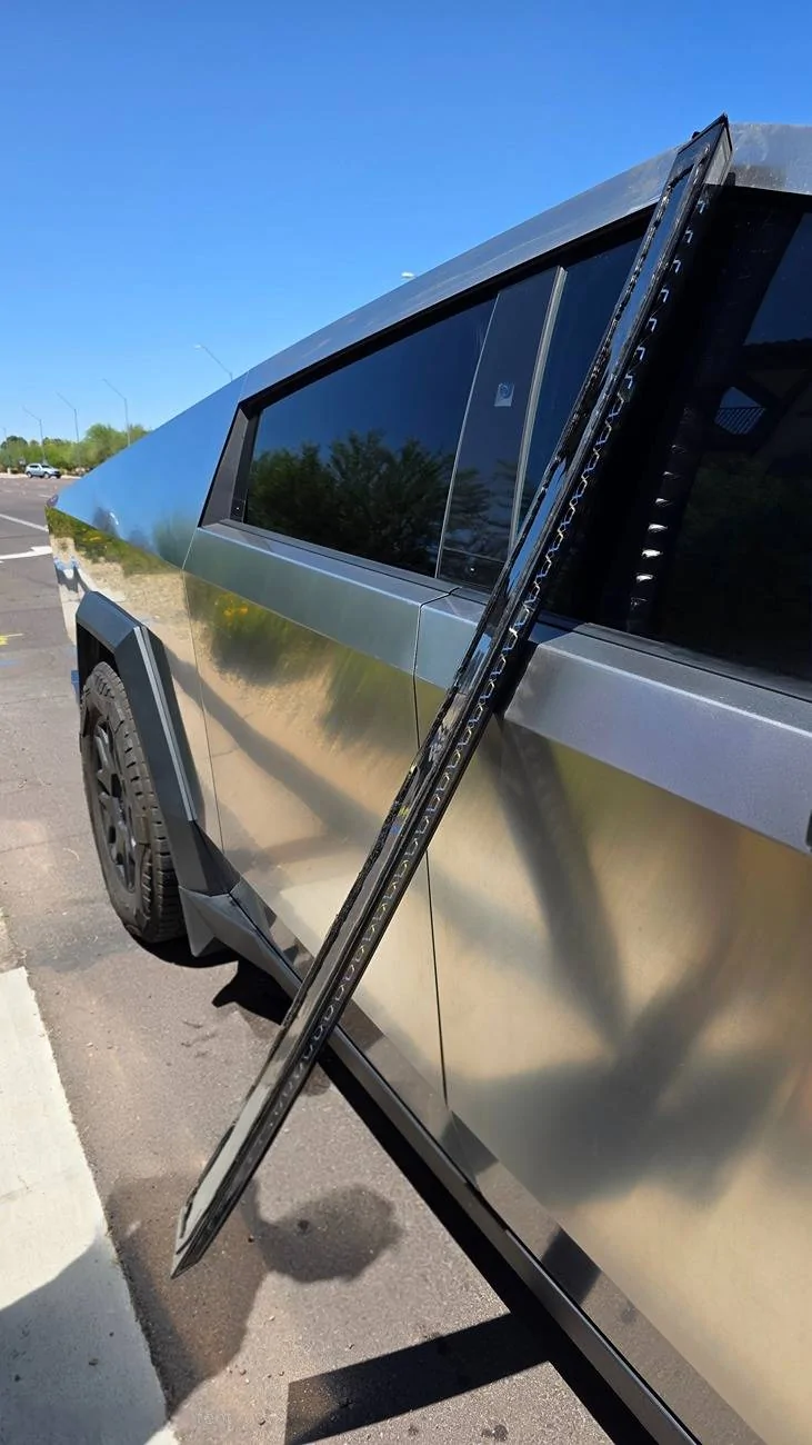

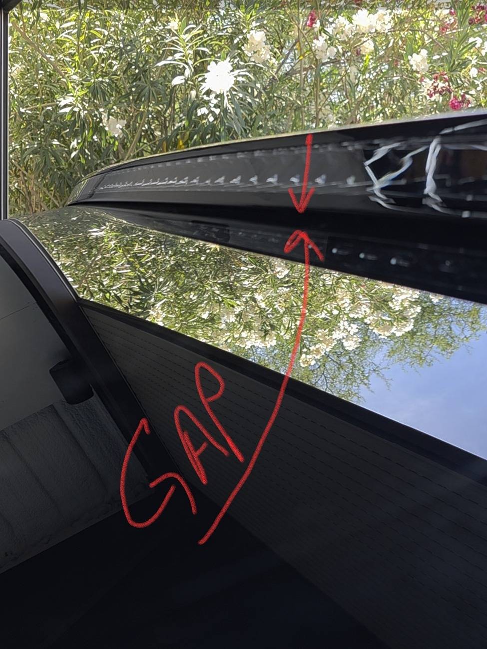

Another one bites the dust..Didn't even last a month in the Arizona heat.
This is the worst design and unacceptable.
Waiting on version 2. This light bar is crap. It looked horrible sticking to the windscreen. The ugly and un- even adhesive bead was visible due to the huge gap underneath the light bar. The wind noise was loud. It should have a molding between the glass and the frame of the light bar help with the wind noise and prevent the air from going underneath the light bar and prying it off the windshield.
Hoping new design has brackets.
