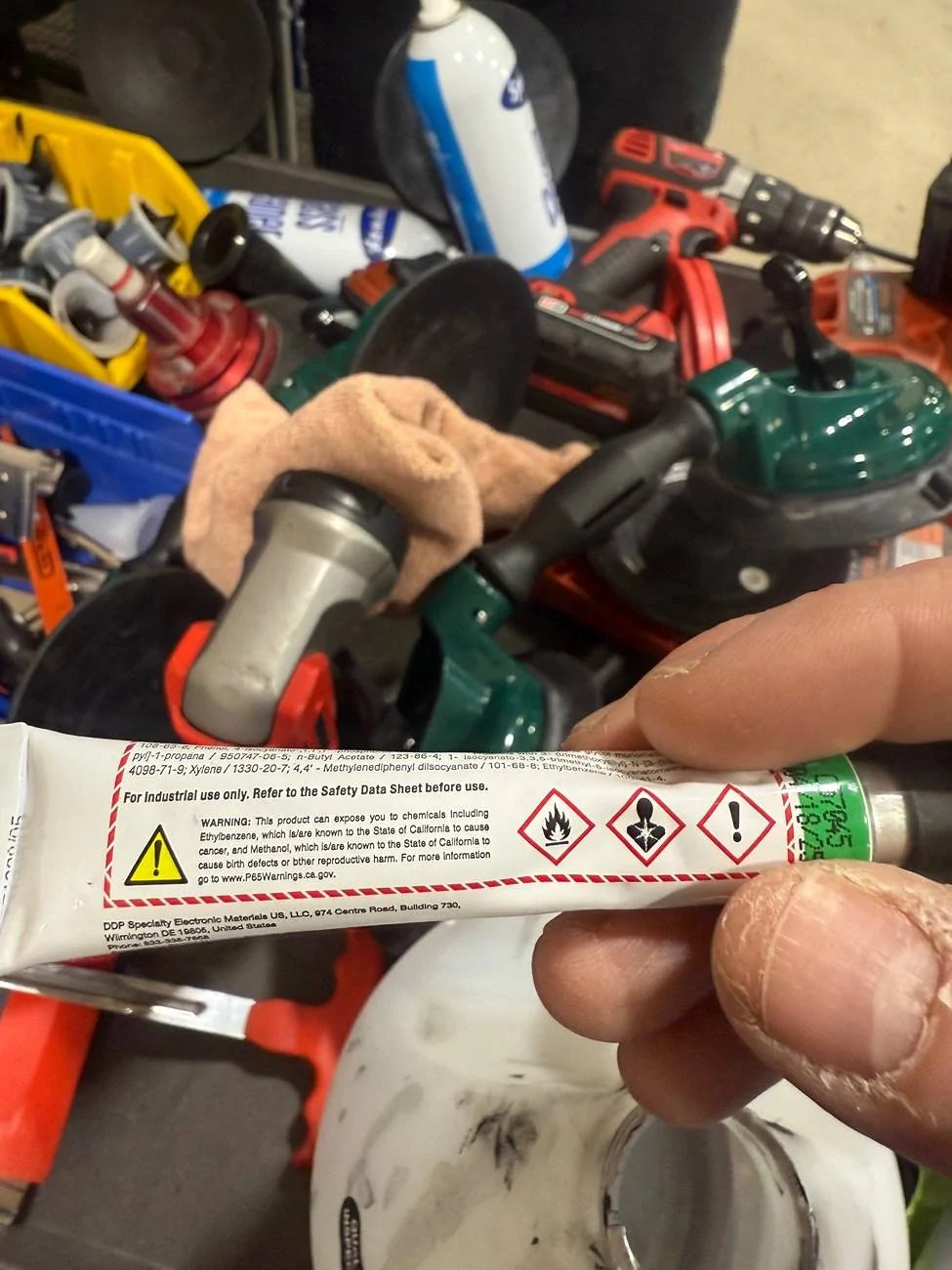

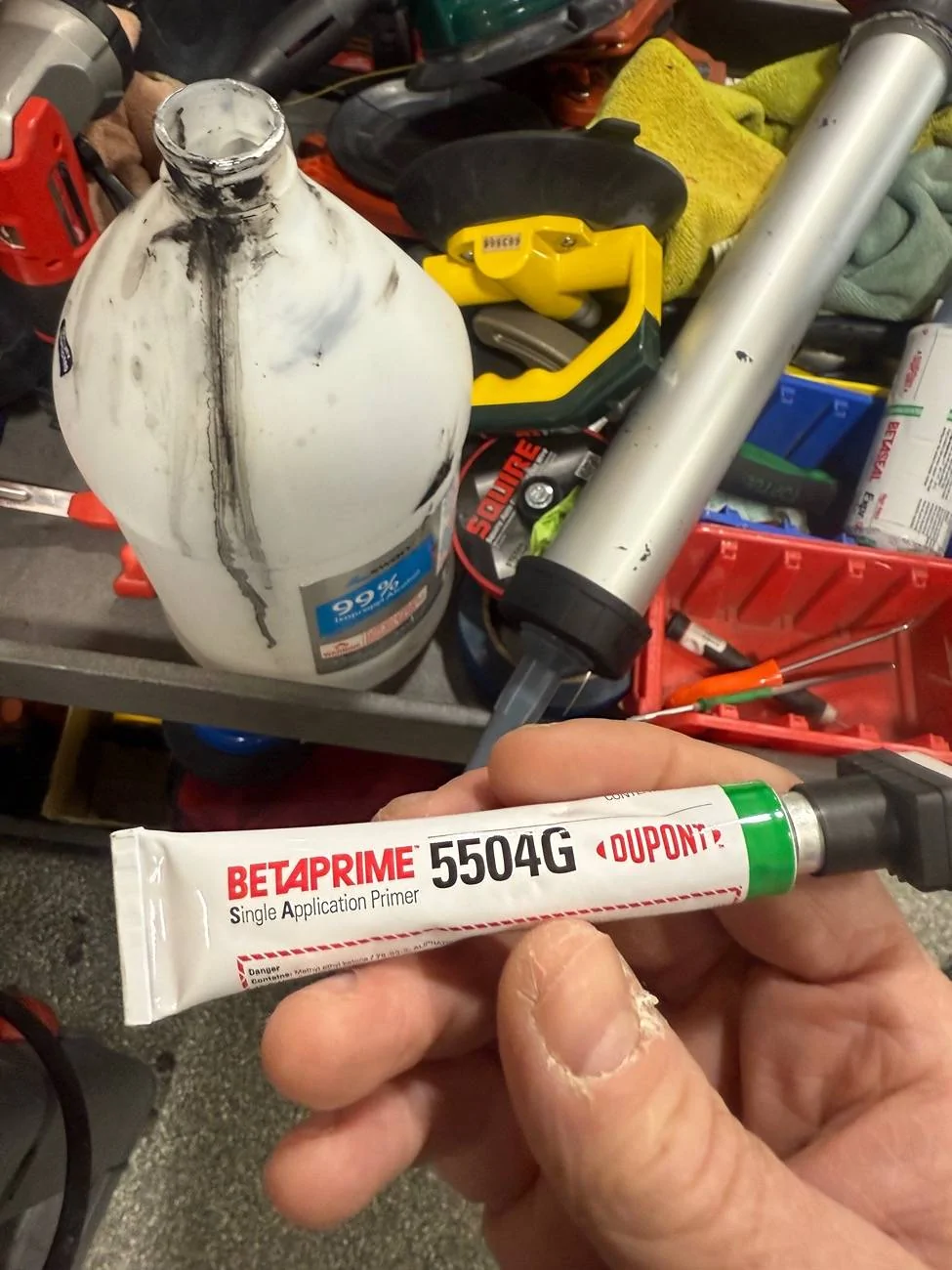

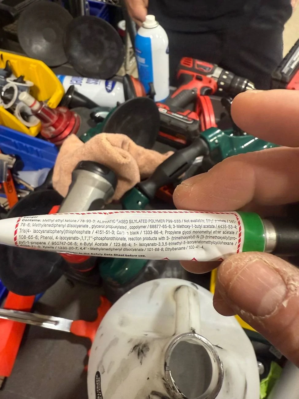

Mine is being installed as I type this. I did take the time to talk with the SC tech. Very helpful and even showed me the “primer” for the side of the light bar. Confirmed there is no mechanical sanding or other micro mechanical prep aside from the primer as noted in the pics below. I will look into to finding out what the light bar spacer/substrate is made of. It is of keen interest to be sure to figure out modus of debond. As a very long shot of why, I know certain adhesives can be “debonded” with electric current….. so it would be fascinating to find out if the chemistry would lend itself to store charge and once a critical charge level if that effect decreases bond strength. Is that large surface area of windshield glass acting as a capacitor of sorts? Just thinking outside the box. Looking forward to the completion of the install! Cheers to all.

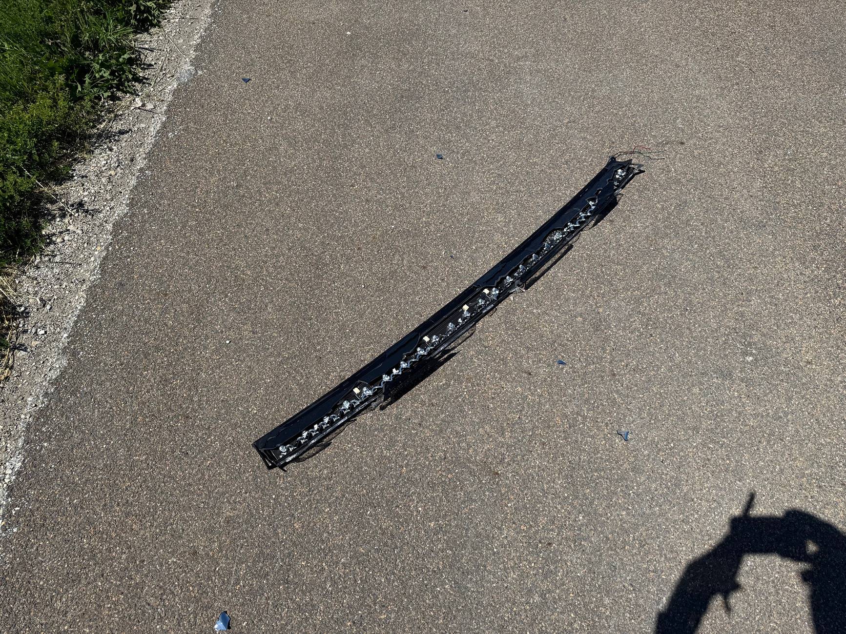

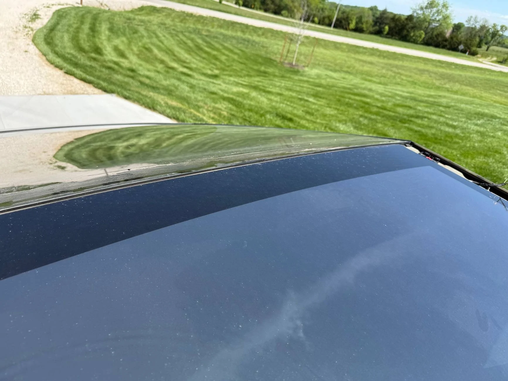

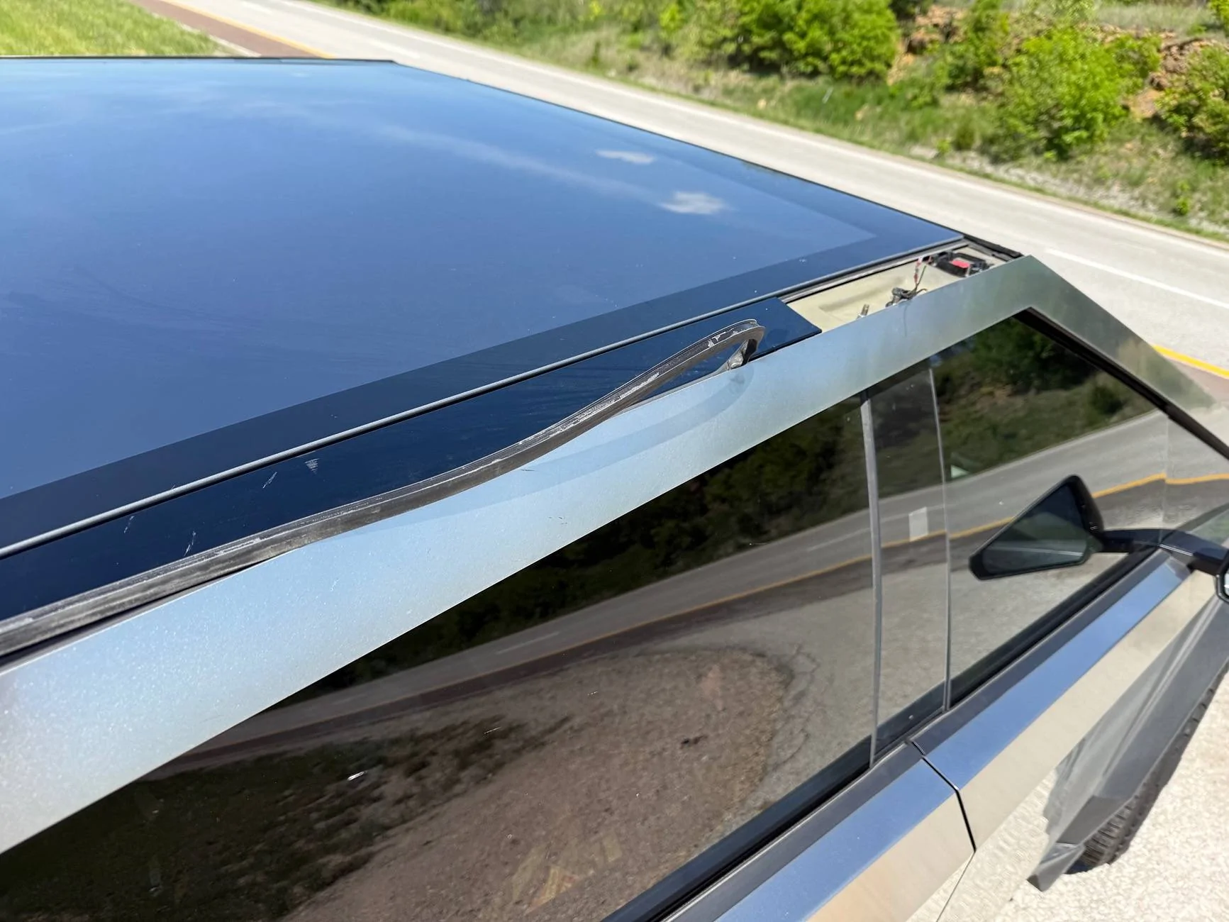

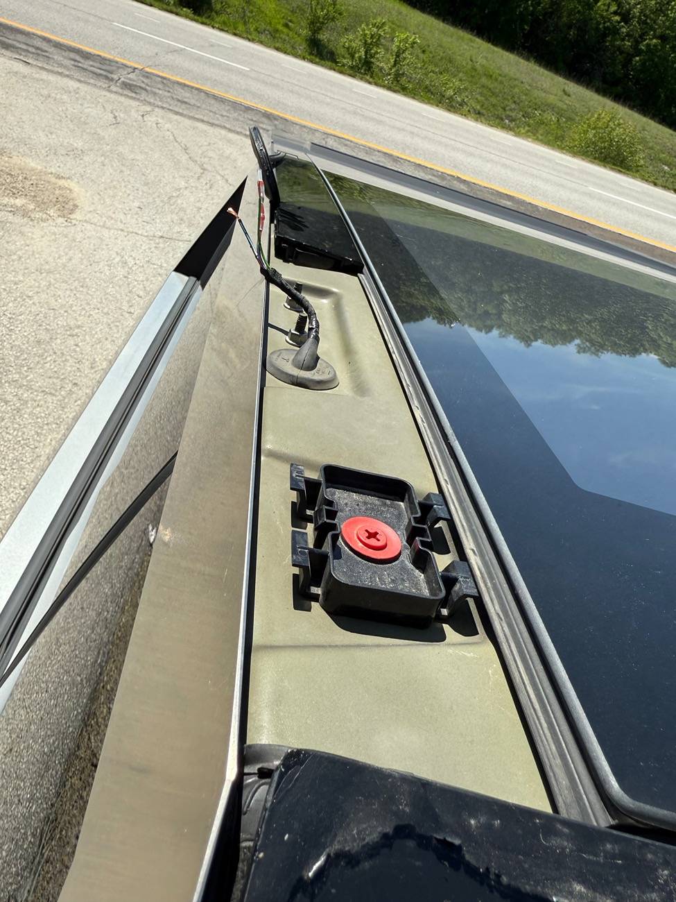

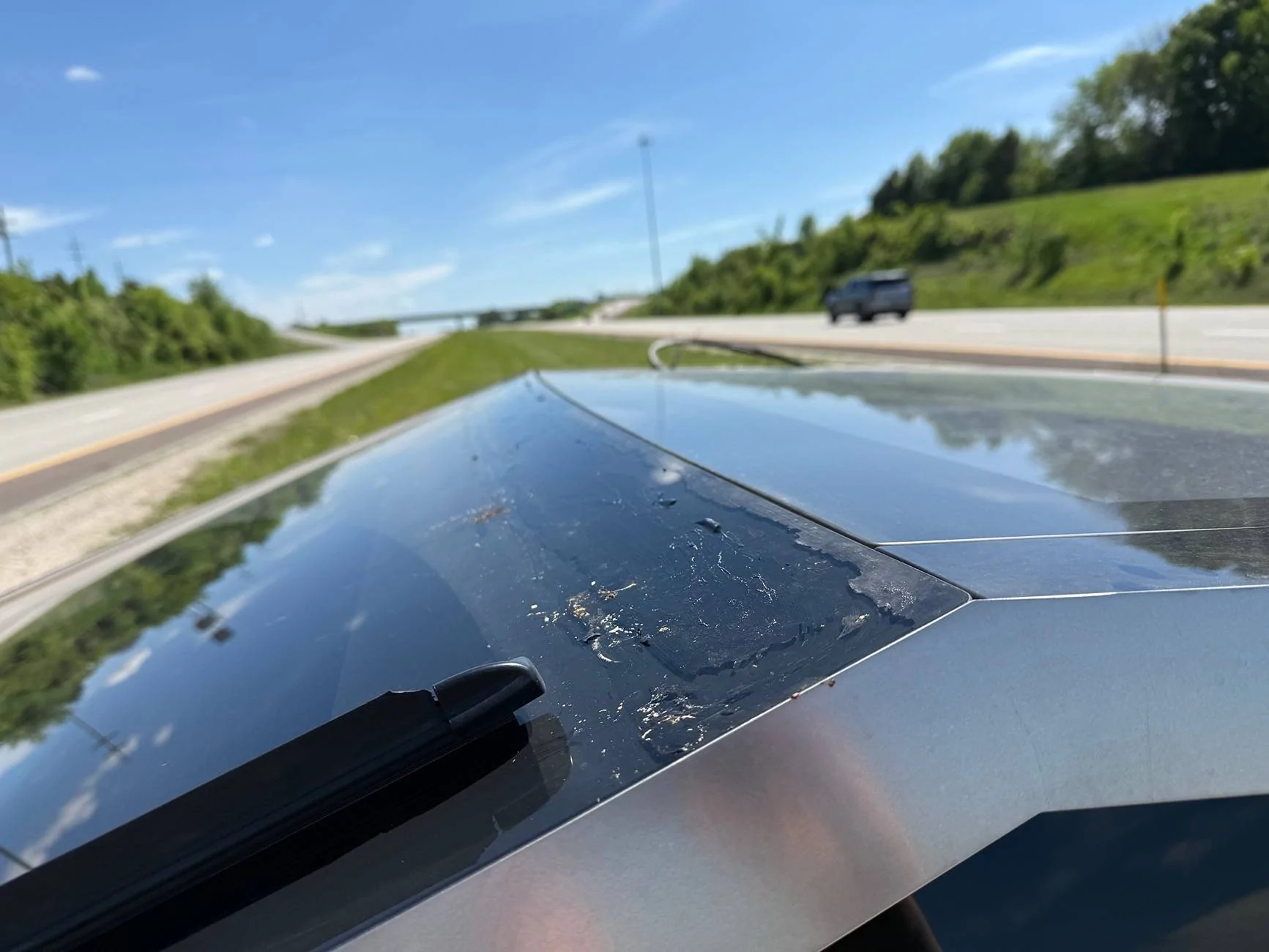

OP here, pictures attached.
To me this is not the issue of the epoxy more of an institution issue. Perhaps something as simple as not using alcohol wipe on the light to remove any oils from manufacturing. Looks like it had no problem sticking to the glass.
It suck when you have a few people at the end of a line of employees that don’t do their part and it makes the whole company look bad.

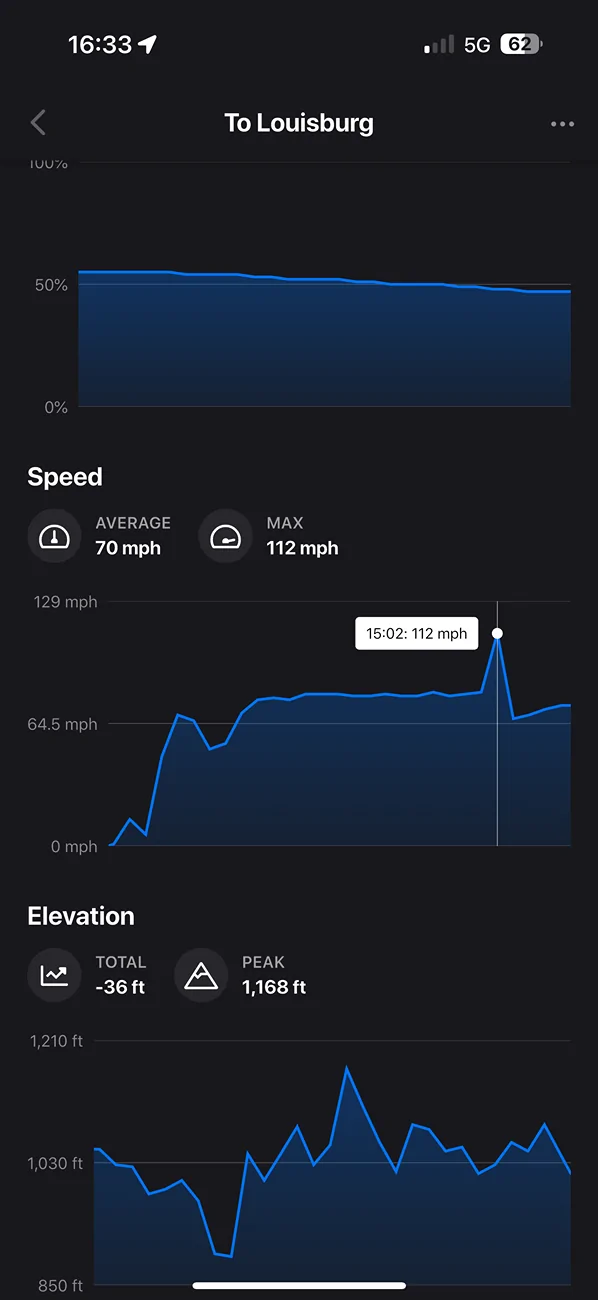

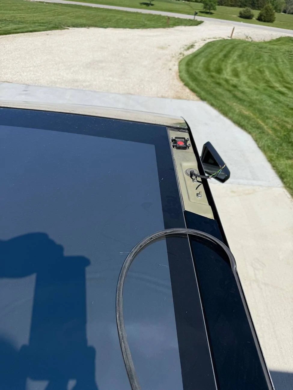

Mine fell off last night 05/12 at exact moment I briefly accelerated to 112 mph for 30 seconds on highway to put some distance between a fast approaching vehicle behind me. It was installed about 3 weeks ago by Tesla SC. AI says air pressure at 112 mph is 1.98 pressure at 80 mph. Fractured upper trim when wires were yanked out.

BETASEAL 43533 for lightbar
NOT BETAPRIME 5504G which is only for the windshield.
Well, I shall soon find out if the correct primer for each was used! Thank you for this info!!

Mine flew off a couple weeks ago. Was passing someone on the highway, hit about 110mph to pass and it flew off. Luckily it didn't hit anybody. I went back and couldn't find it on the road. It didn't break the trim, thankfully the wires just snapped outside the trim. Mine came off the glass, not the light, opposite of OP. I have a service request in with Tesla, they have been reviewing it for two weeks now. They have not said how they will handle it.

Good to know. Of the now four that have been reported here that I’m aware of you’re the only one that had it separate from the glass. Just to be clear your windshield was completely clean no adhesive on it?

Looks like the adhesive to windshield held and the lightbar adhesion was the problem.
