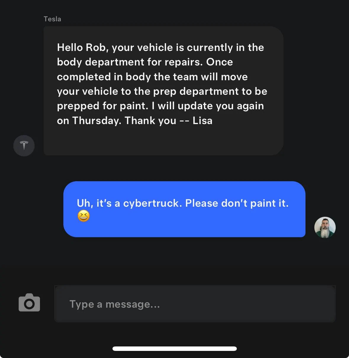

Dropped the truck of May 6, and they opened it up and provided a supplemental quote to my insurance co. Total cost is estimated at 13,268.90. Yikes.
I also received this funny message from the collision center. Thought you'd all get a kick out of it.

I want to see their response!
It looks like Tesla needs to update their service software to account for the unique construction of the Cybertruck.
Inner frame is painted/ e-coated. Depending what was replaced, it may need some paint.

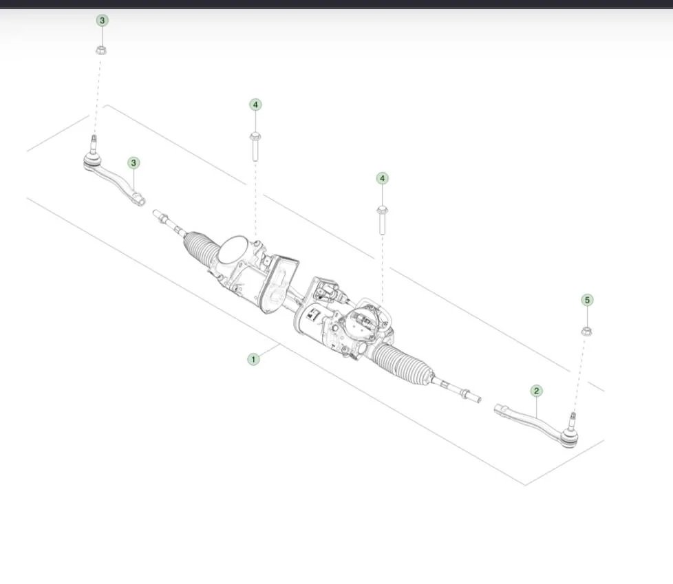

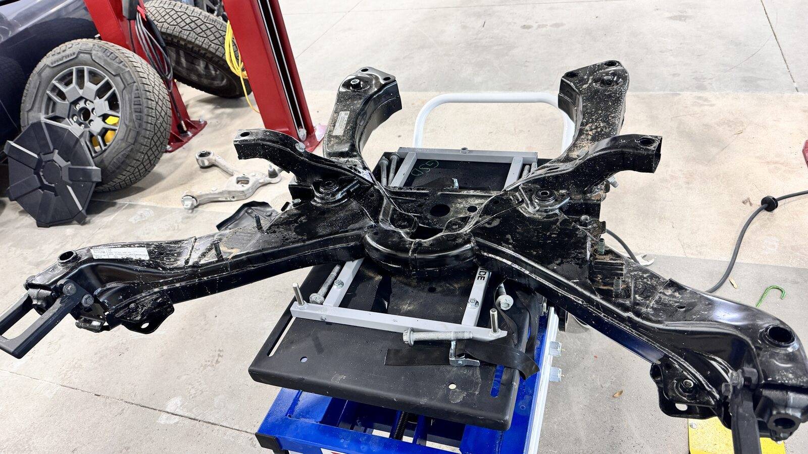

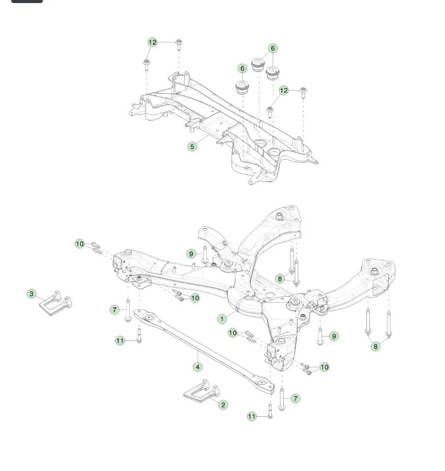

Quick update: they found the subframe is twisted and steering needs to be replaced, so had to order additional parts. New completion date is 5/30. So, they'll have had the truck for almost a month by the time i get it back... They need to sort out their parts delivery process...
Wow. Subframe is twisted and steering needs to be replaced? I must have hit my deer at a different angle, or the deer was much smaller. My fix was just a right panel (bent), front frunk panel (dent) and a cracked bumper. A subframe twisting seems so extreme and more common with hitting things like a car. Yikes! Sorry it's taking so long...it seems to be the story these days with any Tesla. Shoot - Gruber is the only place that fixes my Roadster these days.
Pardon my ignorance……but if the subframe is bent, then that means that frame/unibody is damaged too, right>?

So, picked the truck up last week and it is perfectly repaired. Invoice attached. There was a delay because the deer knocked the wheel alignment out and some parts in the steering needed to be replaced. Then, they had trouble getting the alignment done. They were really upfront about the difficulties - they brought in a senior service manager from another collision center and then used my truck as the guinea pig to train the team on how to align a Cybertruck. Cost me a few days, but I'd rather have it done right.
