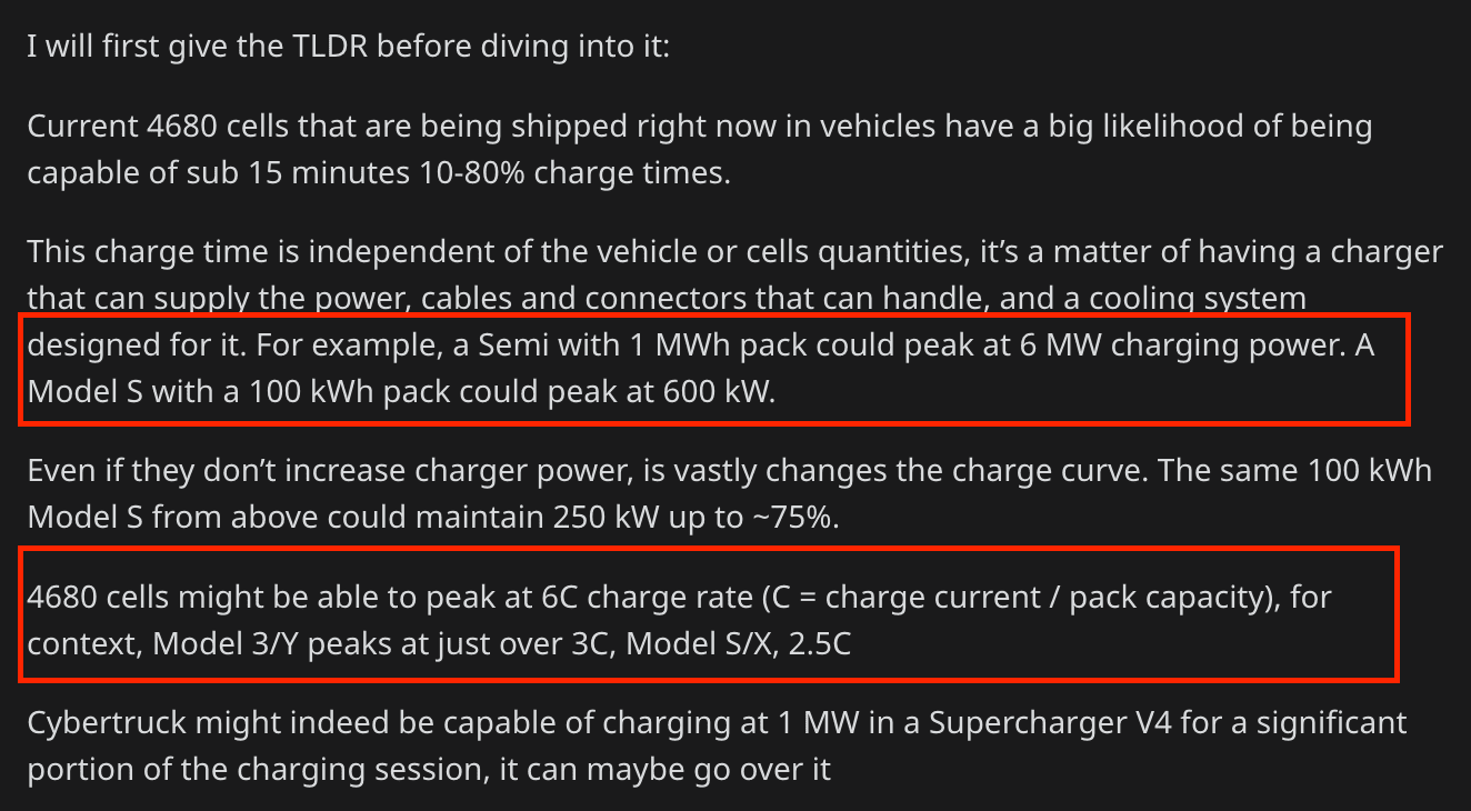

I've seen quite a bit of wrong info here about C rate, limits and so on
I actually went and did the math using real data that we have from current 4680 cells
You say 4680's could achieve 6C rate, what real world data do you have to support that?
Tesla Cybertruck Cybertruck 1000V Architecture + V4 Supercharging Confirmed!! ⚡️ "It's Going to be Used for Cybertruck Too" - Elon Musk 1670041340763
You can try charging these cells at 6C and they will degrade very fast, even with the major advancements in cell chemistry and tabless. The internal resistance goes down but the volume of the cell is much larger:
Take a peak at his reddit thread, he provided the data there and even in downloadable form.
I looked at the sources, there is no mention or reference to C-Rate Cycle life data. This is very far fetched saying that current S/X can achieve 6C 600kW charging - it's totally possible but the cell will die FAST:
Tesla Cybertruck Cybertruck 1000V Architecture + V4 Supercharging Confirmed!! ⚡️ "It's Going to be Used for Cybertruck Too" - Elon Musk 1670042093715
@GhostAndSkater not trying to pile on you here but you have to provide some data to back up your claim that a 4680 can hit C-Rate 6C without massively damaging the cell. Cell cycle data at 6C
Read the article in whole rather than cherry picking and it covers both max rates as well rates Tesla likely has placed based on safety/longevity of the battery. Thermal management is key here as well, and again Tesla plays on the safe side until it gets more days/months/years or miles for that matter of data. This means if the data comes back looking good or better than expected, Tesla has the option to software push things like unlocking higher charging rates. Likewise they could lower it as well if necessary though I tend to believe they play it safe enough from the start to not have to do that as that would be a public relations nightmare.
