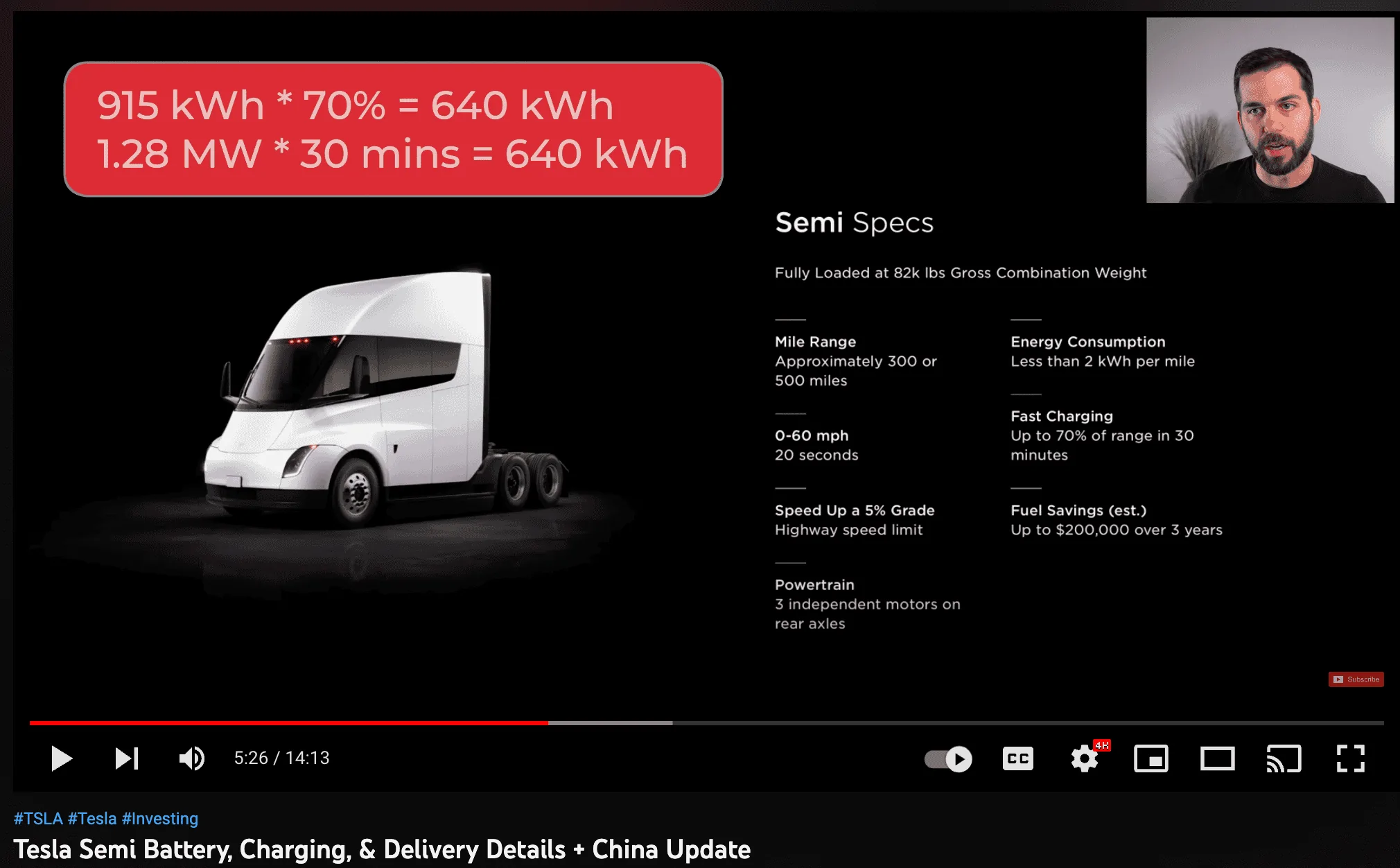

One more stat for the "CT can charge at 1MW" people:
On Tesla's website it says the Semi can charge 70% battery in 30 minutes. Assuming 915kWh that is an average rate of 1.28MW. This is equivalent to 1.4C.
If Cybertruck is 180kWh, 70% of that is 126kWh in 30 minutes... which is an average rate of 252kW (1.4C rate). We are all assuming the CT 4680 cells are going to have more performance than the Semi but I hope this puts it into perspective for everyone...
I mentioned in an earlier post on this thread that I believe the Semi Truck can actually hit peak rates of 2-3MW ~2.2C - 3.3C. And again that would put the CT at 400kW - 600kW absolute max with so many other headwinds like cooling capacity of the pack, increased volume of the cells, limits in the on-board charging hardware, limits that Tesla puts on it for longevity/warranty sake.

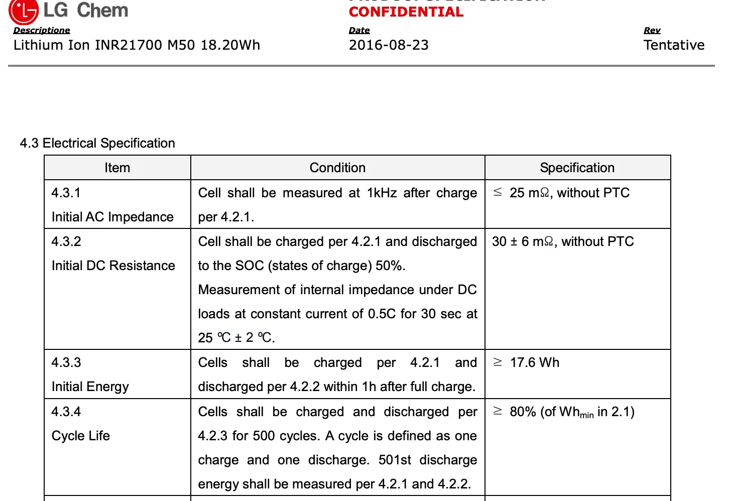

So 4680 has around 4-6x less internal resistance than a 2170 cell. But a 4680 cell has about 5.5x the volume of a 2170 cell! That will directly correlate to heat dissipation!
LG 2170 cell data sheet source:
http://thebatterydoctor.eu/wp-content/uploads/2018/04/20160823-PS-LGC-INR21700-M50_Tentative.pdf
4680 tentative data source:
https://www.batterydesign.net/tesla-4680-cell/
2170 internal resistance 24 - 36 mOhms. Source:

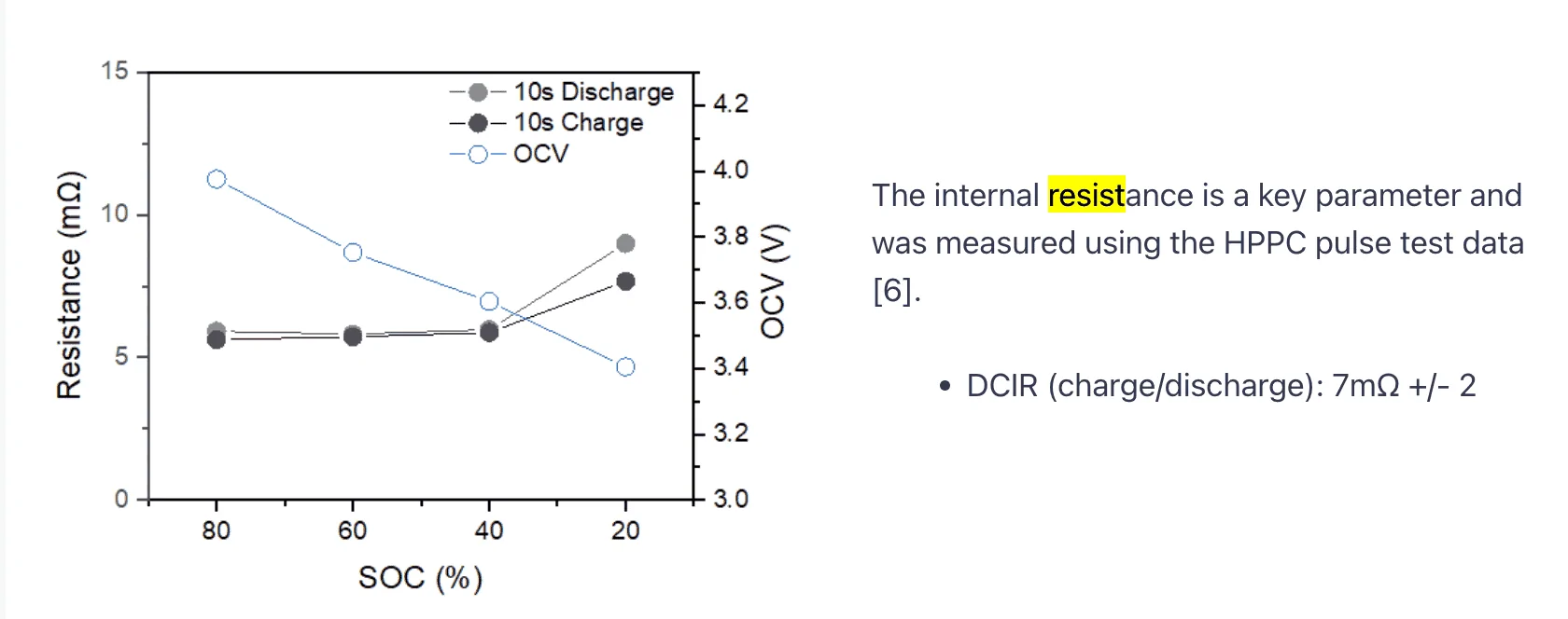

4680 internal resistance 5-9 mOhms, source:
Tesla Cybertruck Cybertruck 1000V Architecture + V4 Supercharging Confirmed!! ⚡️ "It's Going to be Used for Cybertruck Too" - Elon Musk 1670108687218
