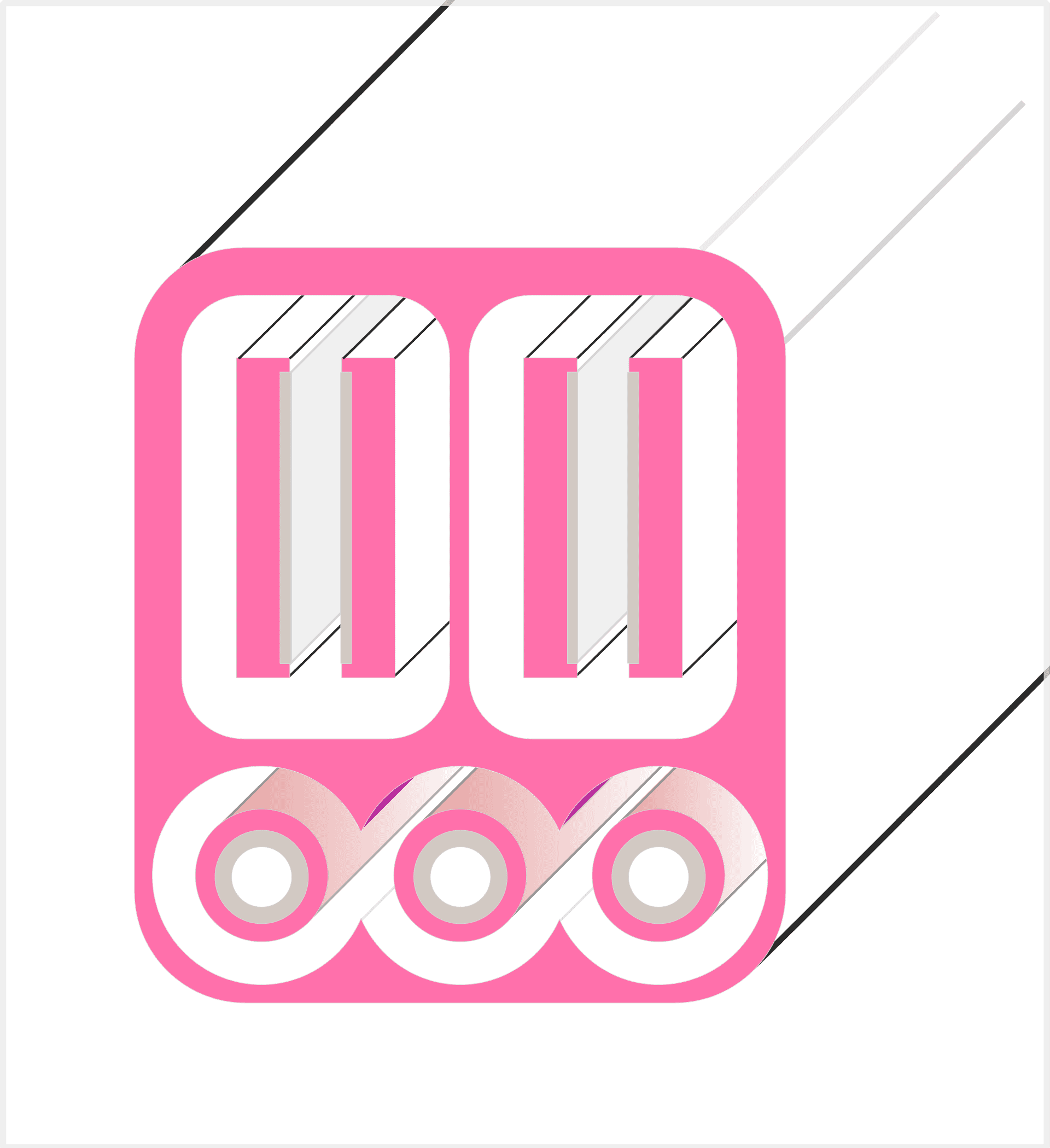

Tesla is also part of the CharIN MCS standard, maybe that will only be for Semi in Europe but from the few photos that we've seen US Semi does not appear to use the NACS connector.
Actually yeh that connector looks identical to an early MCS draft proposal. It's a massive triangular looking thing now though.
