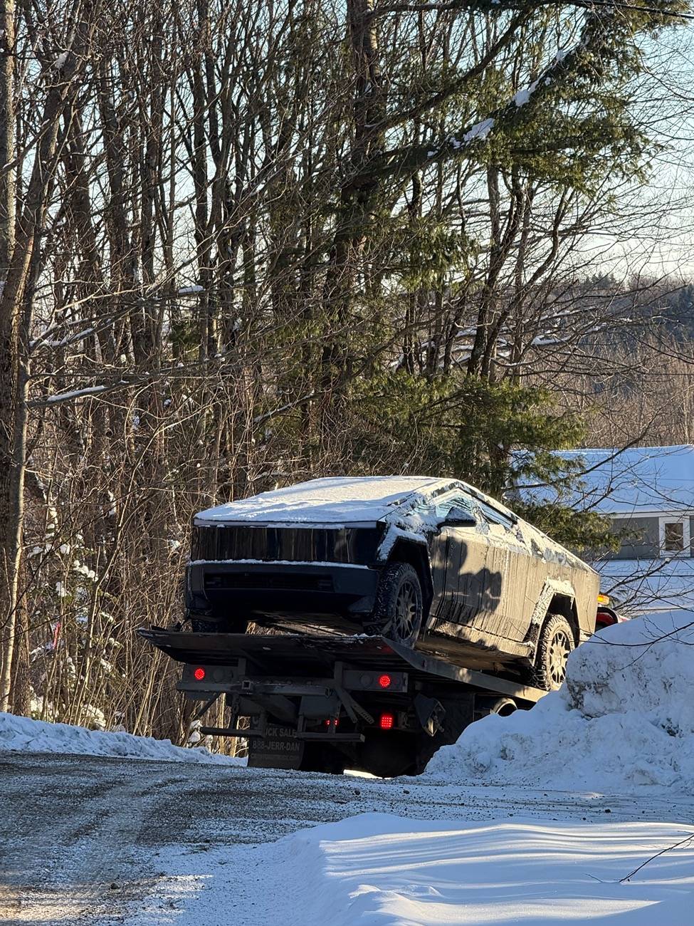

Yes to clarify, I charged the frunk and it opened; appears a clip broke off. Perhaps the plastic is a bit brittle in negative 1 degrees temps...?
I got the driver-side door open. Took a while and the screen turned on. Tons of electrical errors came up (infinite errors scroll)

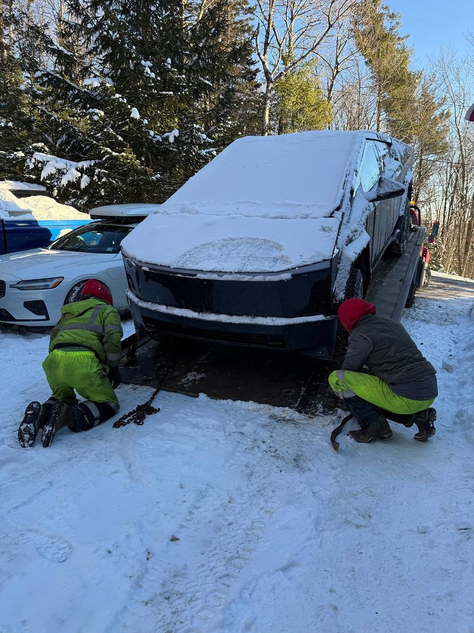

I had a tow guy come but he could not take the truck away. The electrical issues are preventing the truck from entering into "TOW MODE".
We tried everything in terms of charging, etc to get the TOW MODE button to activate but no go. Also, the truck is sitting on snow and ice isn't helping his confidence. The tow truck left, and he seems to be thinking about how to solve it / if he can do it.
I'm pretty patient at this point. I am 24 hours in. Last night's tow truck never came. This morning's truck didn't show either. Missed a ski day with my kids, sadly. But it is what it is and honestly not surprised to experience this once or twice.
But I am getting the feeling the Cybertruck isn't mean for the cold and snow.
To cap things off, the door won't power the window totally closed so its sitting down an inch or two! Fortunately, no snow in forecast until Tuesday :-|

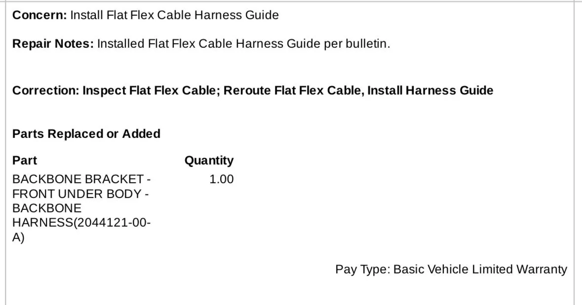

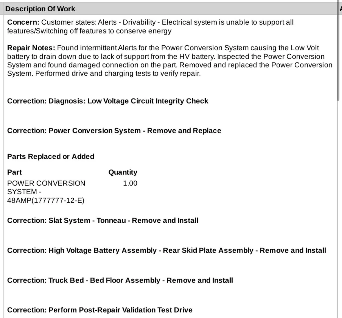

I had the exact same issue. Here are some screenshots of the fix required for my truck. Took about 10 days at the service center. The good part is I got the new wiper motor part number and sail appliqués on the top side of the truck bed on the same visit.
Wheel dolly or
skid plates (or drag) and flatbed.
