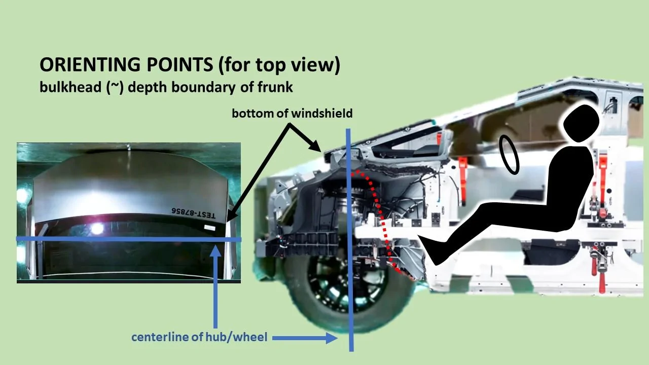

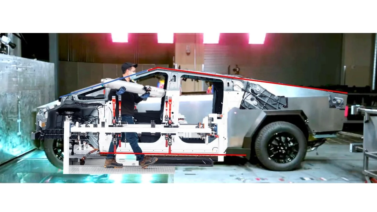

No time for more today, but from Joe T’s video of earlier today:
Tesla Cybertruck Cybertruck Front Casting Analysis (and Frunk Implications) - 3 vs 2 Chickens 72383BBC-3C1B-41EE-8B3D-B9AC028A7281

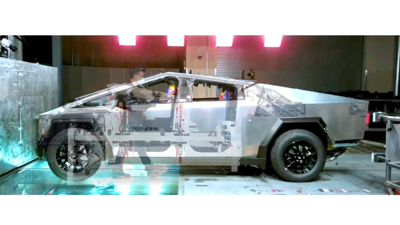

The thing about the CT’s shape and proportions is how hard it can be to have a sense of scale.
A helpful touchstone of scale are the CT’s wheels, which we know to be 20”
And this photo is shot from far enough away that perspective depth plays little-to-no role between the wheel and the frunk
the green lines below are identical length
Tesla Cybertruck Cybertruck Front Casting Analysis (and Frunk Implications) - 3 vs 2 Chickens 94547094-73B5-4558-9C02-F7C573415A15
back of napkin, 12”-14” deep or so (but more concretely, *not* 20” deep)
For comparison, that’s roughly the same depth as the Model Y at the floor
