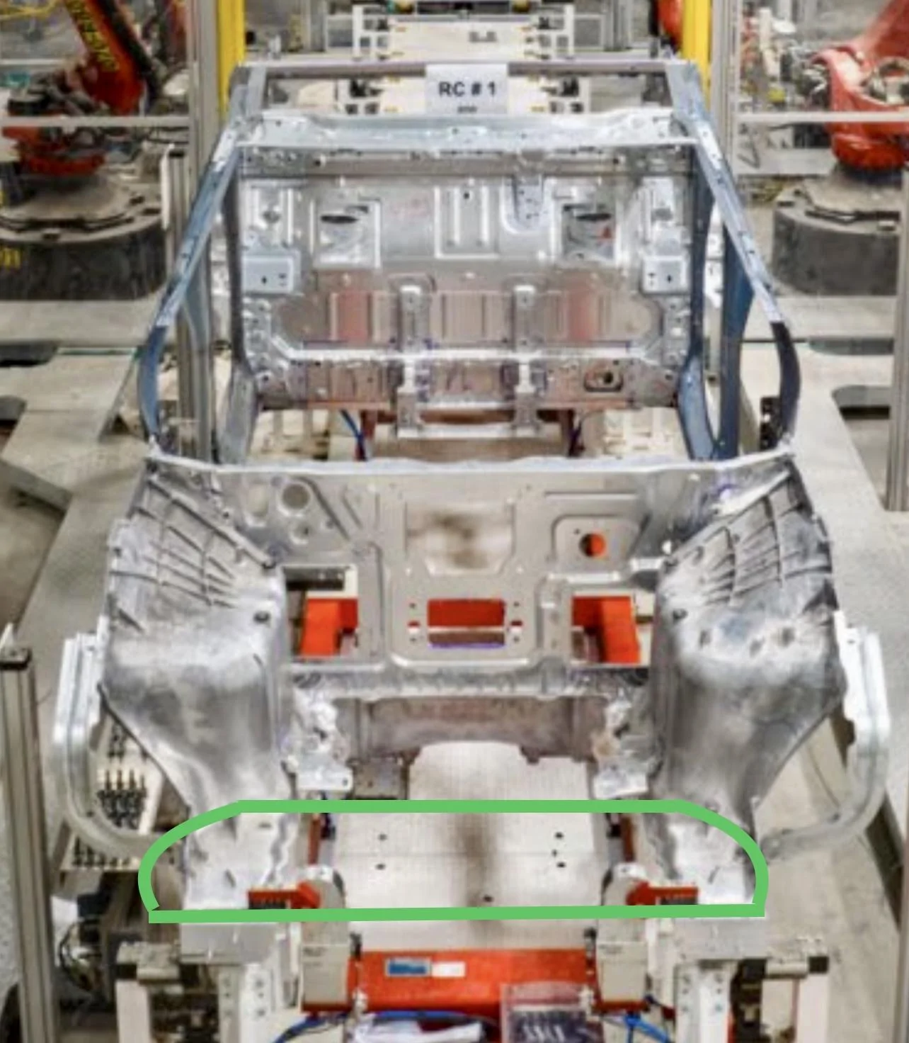

Great shot that gives a sense of the max width of Frunk floor space between wheel wells
just forward it those wheel wells, it could widen, but quickly hits the front of the hood or trim left/right

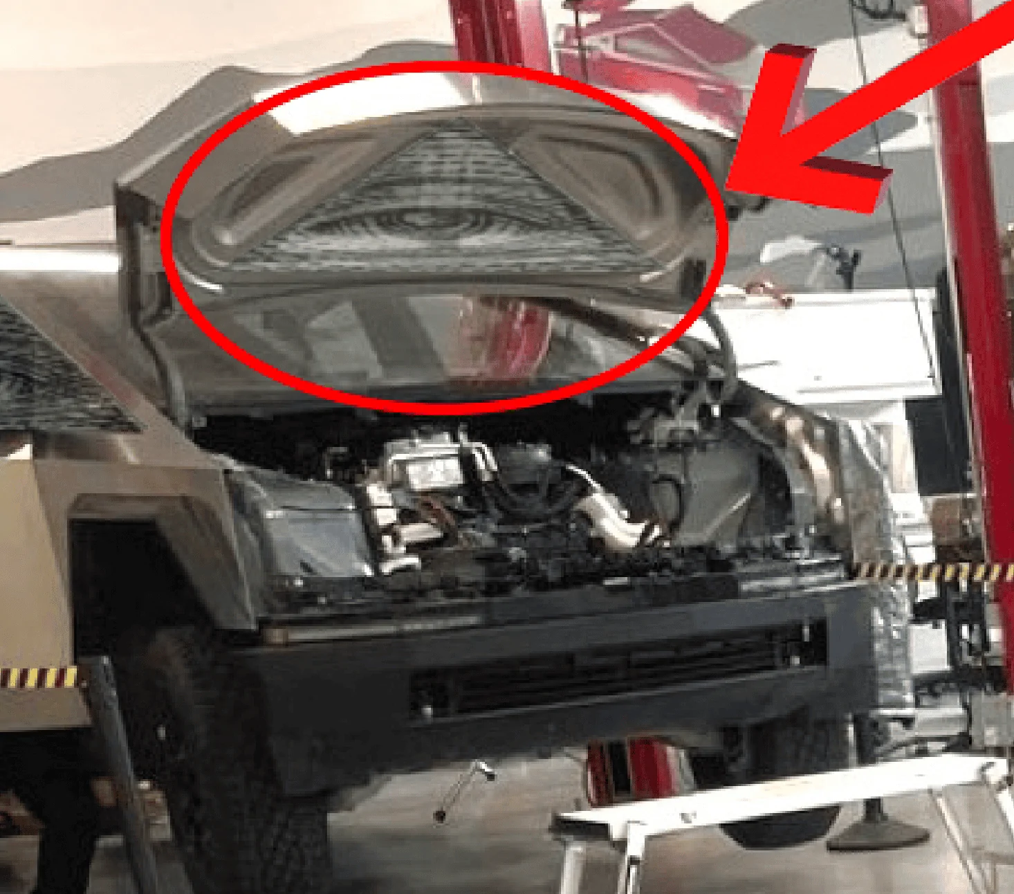

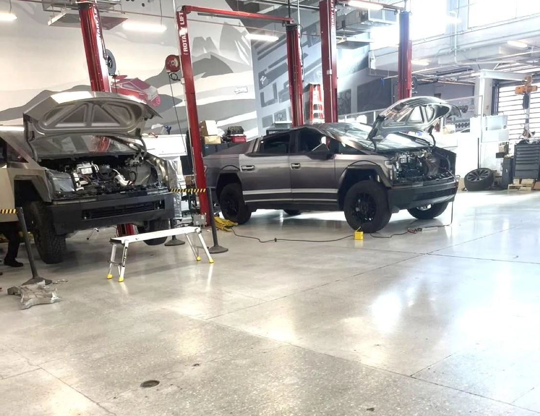

Can’t not put these here for posterity!
Tesla Cybertruck Cybertruck Front Casting Analysis (and Frunk Implications) - 3 vs 2 Chickens 8E77A816-DD3B-4AE8-B7FB-43A4AF4558B9
Tesla Cybertruck Cybertruck Front Casting Analysis (and Frunk Implications) - 3 vs 2 Chickens 1E802A15-84EC-47FD-AEED-321ABC1FC8D4
Tesla Cybertruck Cybertruck Front Casting Analysis (and Frunk Implications) - 3 vs 2 Chickens E5A71CBE-7098-42BD-AA81-E5E2422BA6AC

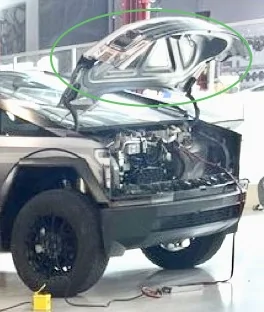

notice the rough shape of the upper rim of the “tub” that will be the Frunk trim. The likely gives a feel for what will be the uppermost widest/deepest portion of the Frunk, slightly reducing in size as nears the floor of the
also interesting to note the underside of the Frunk hood appears to have a stamped steel backing with bracing - also at its front forming the cavity where RDL wiring/housing etc sits forward of

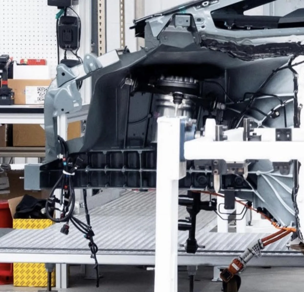

so basically the frunk does start several inches forward of the windshield seam, basically with the foremost faces of the wheel well forming the 1/2 the back wall of the frunk
Tesla Cybertruck Cybertruck Front Casting Analysis (and Frunk Implications) - 3 vs 2 Chickens CEC40760-A26D-4295-AF5B-EF2EFB5B695C
Tesla Cybertruck Cybertruck Front Casting Analysis (and Frunk Implications) - 3 vs 2 Chickens 4212A5FA-30B4-4EF4-864E-970940AAC79C
the trim tub width would be bounded by the panel brackets in each front corner
unclear if there will be a whole lot of sub-frunk, given the location of the air-intake/radiator

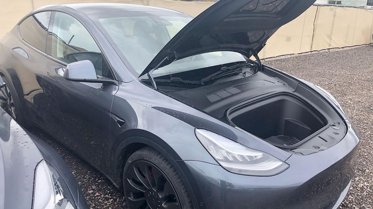

Thanks to the stubbier front end the frunk will most likely be on the small side. Hopefully it can double as a cooler with a water drain on the bottom.
charliemagpie
Charlie
Jul 6, 2021
2,982
5,369
CybrBEAST
Extends into front left and right cavities, as speculated.
Perhaps the lining will also snugly follow the hardware and create extra space under the windshield ?
charliemagpie
Charlie
Jul 6, 2021
2,982
5,369
CybrBEAST
Yeppo
But it is open at the front, not quite a tub. Extended space unlikely.
