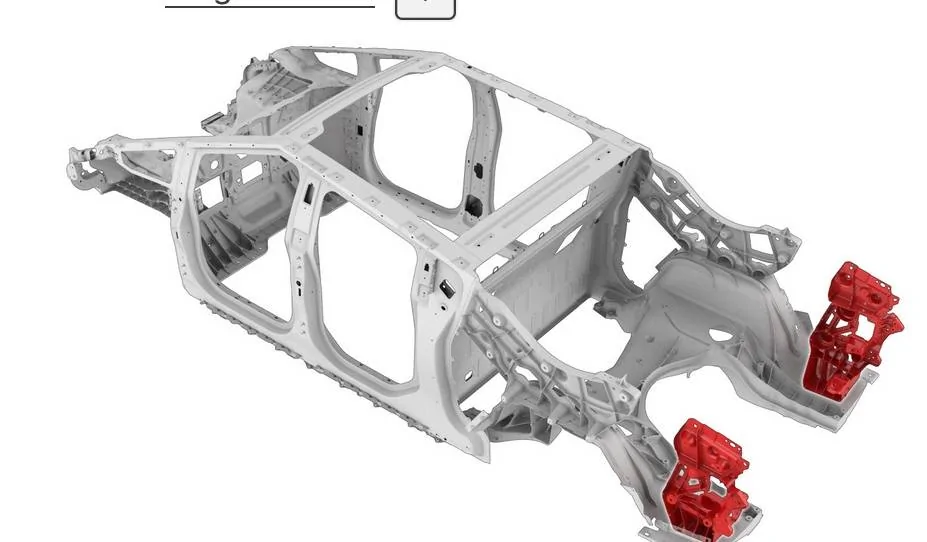

The castings and cabin inner/outer are the main structure. Of the body panels, only the sail panels have any notable structural addition.
The stainless on the doors is the crash barrier, but that's not vehicle stiffness/ main structure.

So you think a diagram with a component shown in red qualifies you to know how all the forces in the Cybertruck, through all its compenents, interact with each other?
Show a detailed 3D model rendered in RISA 3D or other structural design software (I am sure Tesla uses software way more advanced) and maybe it will be worth some consideration.
But looking at diagrams of how the Cybertruck is put togther and "guessing" how loads are distributed everywhere, under all concievable loading circumstances, is futile. It is way too complicated to guess at it. I don't care if you're a SpaceX rocket scientist. You can't know. (BTW a SpaceX rocket scientist would be too wise to even attempt a guess at it).
The AI summary said 60-80% was from the skin "primary". That's just plain wrong.
The image is the frame. The red just happens to be the sub page I was on. Look at the shock towers and the structure compared with load path.
