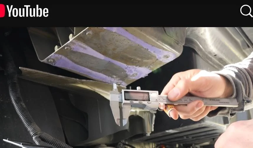

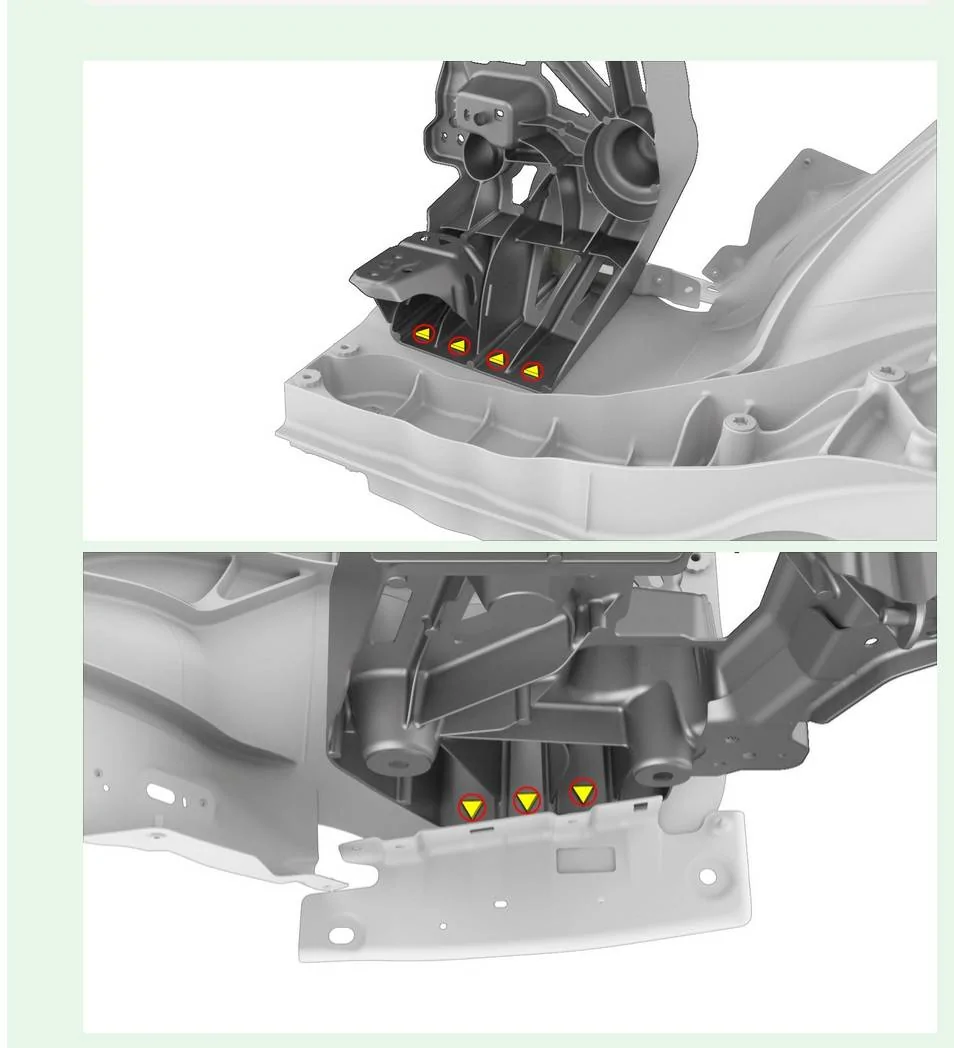

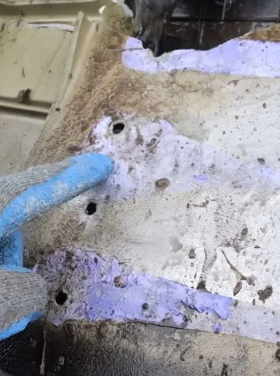

Want to take a crack at quantifying the holding strength of these aluminum casting spot welds, (plus it looks like some adhesive)? I don't see any tearing so it looks as if the welds just let go cleanly at the surface interface. I assume there must be some sort of material/welding strength tables for this sort of thing. 14 total welds x ___ lbs of adhesion force each = support provided.
There is tearing, the entire weld nugget broke off the casting. Assembly unzipped, you can hear each weld break (at least until the end when they blend together).
The 6.5mm (1/4 inch) repair rivets are probably good for ~1,000 pounds if they are aluminum, more if stainless. So that's 14,000 pounds which lines up with the failure vs lever arm.
