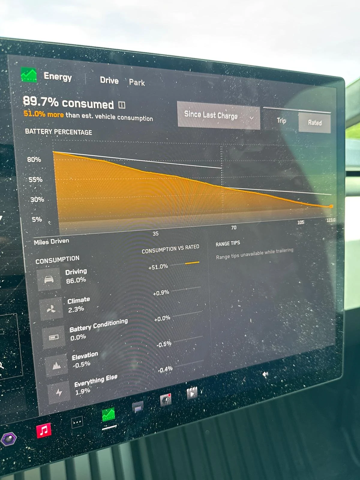

How much did the Ramps eat into my efficiency? 10% maybe?
and @chris90702L said he drove “into the mountains” I was doing mainly freeway driving in flat Houston!
Sounds like I have a defective battery! ??
I don't know. Your numbers do sound low, even for an EV towing. Surprising to me at least.

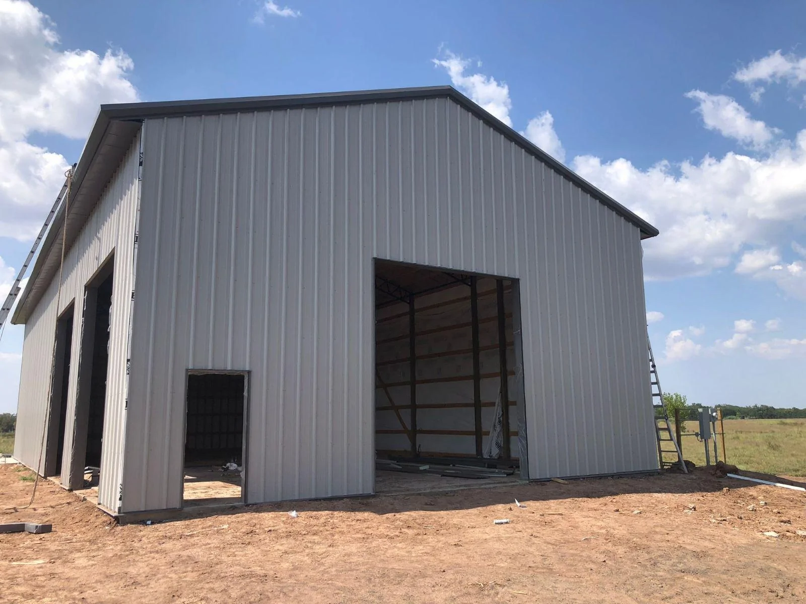

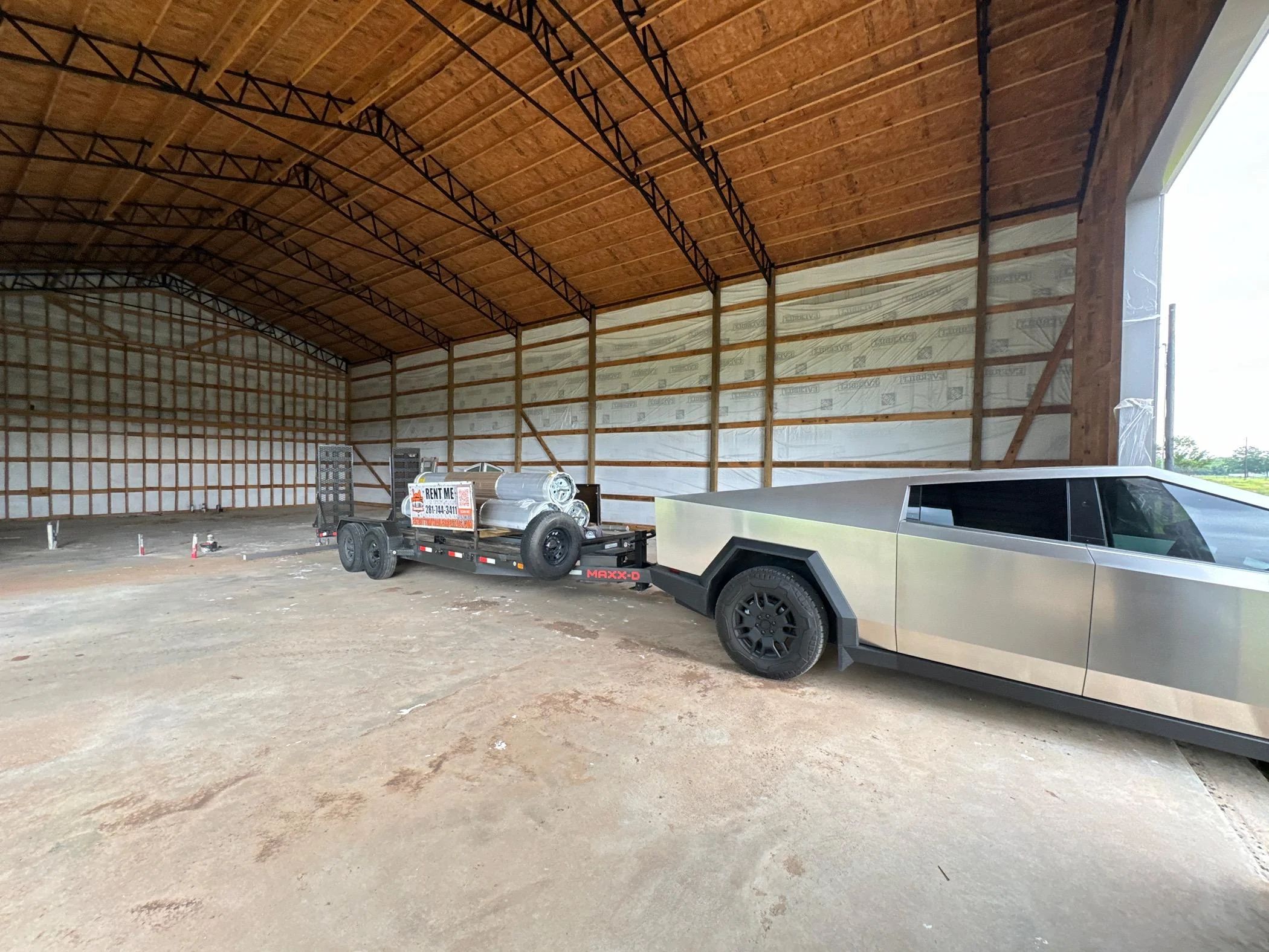

I wouldn’t call 14x12’ commercial roll up doors exactly a garage door. ?
True, plus you called out the load as 1,500 pounds and I mistook the trailer size as the door size.
That's an interesting truss spacing, do the doors go on the wall we can't see?
cyber_moonlight
Apr 15, 2024
68
85
Houston, Texas
2024 Cybertruck
Yeah, I've built a 80x40 building where the first half will be a guest house and the other half is a workshop where you see the 3 x 14'x12' doors. The building is about 27' at it's highest peak.
The odd spacing for the first few trusses is to accommodate for the roll up doors.

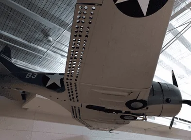

Those ramps in vertical position make a huge difference. Way more than 10% and every 1 mph speed increase significantly increases the drag effect.
Those ramps in vertical position are acting like large drag creation devices, aircraft speed brakes which significantly increase drag.
Even some aircraft dive bombers/fighters had deploy-able perforated speed brakes they called dive brakes.

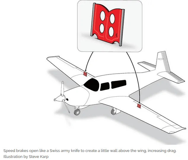

How it Works: Speed brakes
How to stop on a dime, or at least a dollar
October 1, 2016
By Alton K. Marsh
https://www.aopa.org/news-and-media...t-training-magazine/how-it-works-speed-brakes
Precise Flight - SpeedBrakes for the Aviation Industry - Double parasitic drag on the aircraft.
for Cessna 210
for Piper PA24, PA28, PA30, PA32, PA39 , PA46
for Beech 33 / 35 /36
for Mooney
for Lancair Legacy
https://preciseflight.com/general-aviation/speedbrakes/

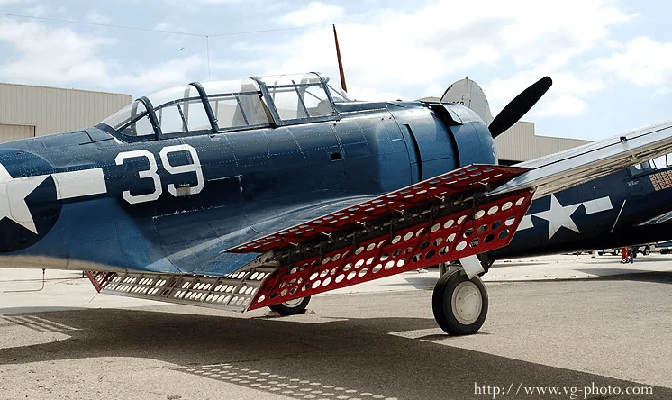

QB-36
1940–1944 Douglas SBD Dauntless
Orders were placed by the US Marine Corps and US Navy for the SBD Dauntless in April of 1939 to satisfy the need for a new dive bomber. ....
This Dauntless is an SBD-5 that is owned and operated by the Planes of Fame museum in Chino (CA USA).
https://www.vg-photo.com/airshow/qb36/sbd.html
Flightdeck Friday: Smoke and the Battle of Midway
By SteelJaw | September 26, 2009
https://blog.usni.org/posts/2023/12/21/annoucement
Even pilots of other services have a minimal understanding of dive bombing. All military pilots have put aircraft in vertical dives, and many have dropped bombs from a diving plane, but our Navy’s dive bombing was different from the diving attacks of conventional aircraft.
The unique features engineered into the 1940–1944 Douglas Aircraft Company (now Boeing) Dauntless SBD enabled the pilot to fly a controlled vertical flight from 10,000 feet or more to sea level, tracking a moving target ship as small as 40 feet wide which was taking evasive action. Of these features most important were the split wing trailing edge perforated dive flaps or “brakes” to retard diving speed and allow more abrupt pullouts. Wings were strengthened to withstand the high G forces at pull out. A yoke was designed to throw the bomb clear of the aircraft’s propeller when the bomb was dropped in a vertical dive.
Ideally the dive bombing aircraft, in a vertical 90 degree attitude, plunged at a 70 degree flight path because of the remaining lift on the wings. The target, at 24 knots would travel 1,214 feet while a plane dived from a two mile altitude. Wind was also a factor. The aircraft was literally flown down the dive path at constant speed, using ailerons and elevators to continually adjust the point of impact until bomb release and pull out. Neither the Stuka nor the Val was designed for bombing with extremely high dive paths.(5) Instead of trailing edge split wing dive flaps their device was a flap that dropped vertically from the center of the wing spar. This also affected lift and the trim of the aircraft. As a result they were not as accurate as our Navy’s dive bombers without descending to lower altitudes.
