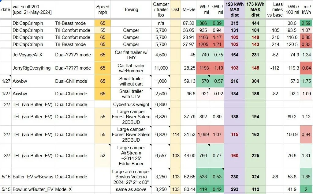

FYI, this has been talked about for months around here.
Tesla Cybertruck Cybertruck range while towing is HORRIBLE! vZQlUqq

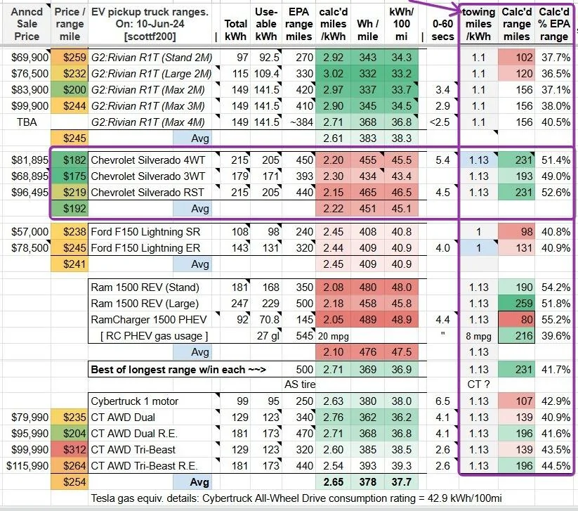

Silverado EV on paper looks like it checks all the boxes. However, the tech is questionable.
The great thing about Tesla is the continuous updates. I cannot say that with any other manufacturer other than Rivian. ...
Rivian's OTAs frequency and implementation is impressive.
The long known issue is integrating with suppliers and can you build the infrastructure in the vehicle from the start (ie. can you communicate and change the behavior of all electrical parts ... eg. wiper system/motor in one clear example).
The OEMs *know* this. Jim Farley has done interviews on it. Certainly new vehicles will have this infrastructure but can they implement it well like Rivian has. Tesla's is a bit of a mess anymore and you can see 50+ versions https://www.teslafi.com/firmware.php
Tesla Cybertruck Cybertruck range while towing is HORRIBLE! ay6wPZ

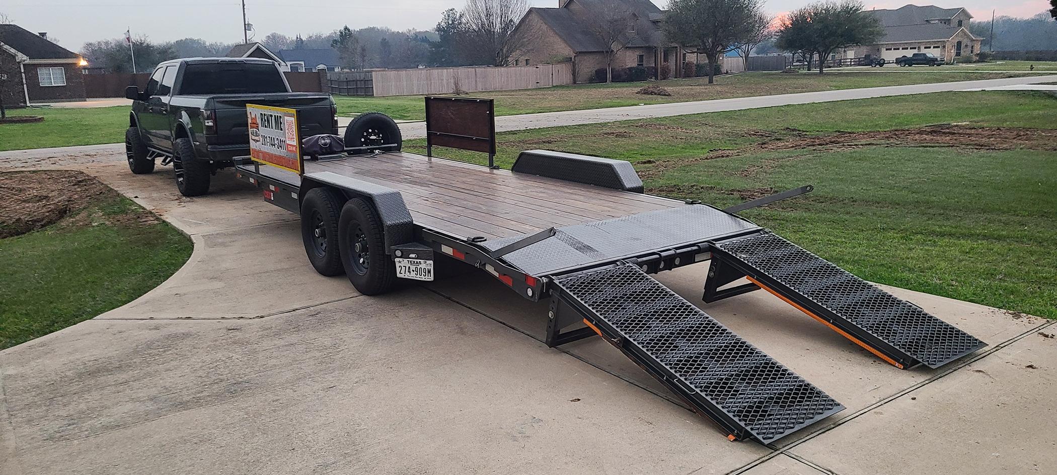

How much did the Ramps eat into my efficiency? 10% maybe?
and @chris90702L said he drove “into the mountains” I was doing mainly freeway driving in flat Houston!
Sounds like I have a defective battery! ??
Way more than 10%.
Aero force is proportional to drag coefficient and crossectional area times air velocity squared.
So for the same setup 70 MPH uses twice the energy per mile (for aero) as 50 MPH.
While expanded metal drains water, it's not so great at flowing air, especially at speed, plus those ramps have solid crossbracing. Call them 2.5x5 feet each or 25 square feet of crossection. Flat plates have a drag coefficient (Cd) of 1.28 so 32 for that part of the formula.
Cybertruck itself has Cd of 0.34 and crossectional area of ~35 ft², so 12.9 for that part of the formula.
This means the trailer ramps have 2-3 times the aero drag of the Cybertruck.
Rolling drag and vehicle accessories are also part of the mix which softens the aero impact on overall range.
Another factor that makes range impact worse is initial vehicle efficiency. If a trailer adds 400Wh/mile of load and the towing vehicle on its own uses 400, that's a 50% drop in range. However, if the tow vehicle were 50% less efficient on its own (600 Wh/mile) then the drop in range would only be 40%. If the vehicle is 400 on its own and 850 with trailer, that's > 50% range loss.
In general, you can determine what the impact will be after a short distance towing (if vehicle is already conditioned). If you test at a few speeds, you can even estimate rolling vs aero impacts to map out the energy vs speed curve.

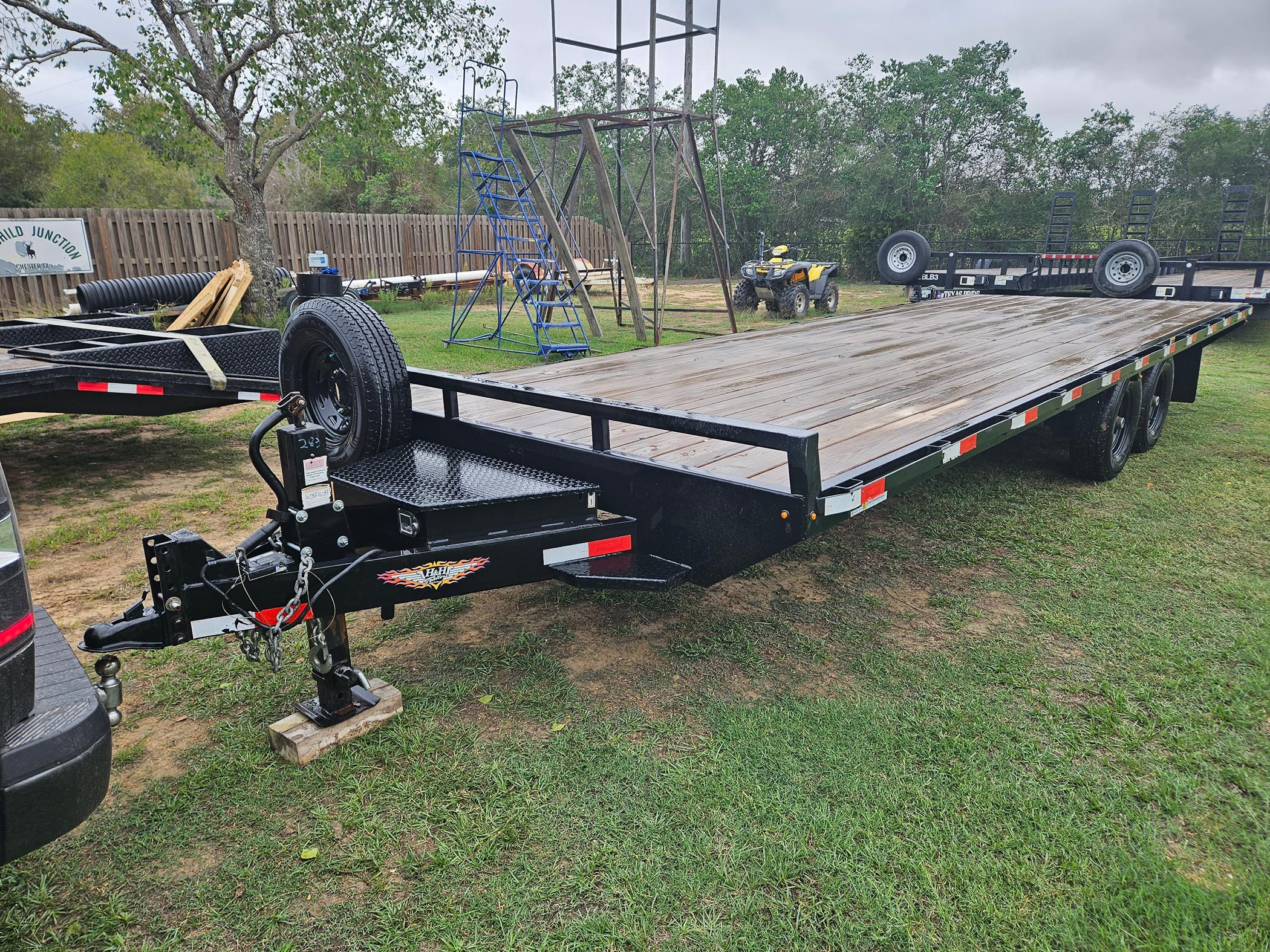

I appreciate @mongo even checking the place I rented the trailer from… I needed something without rails so I can load what I needed so this is the only option.
I'm confused, the trailer you rented has rails, the flat deck doesn't. One option in general is cribbing under the load to raise it up if rails are an issue.
Tesla Cybertruck Cybertruck range while towing is HORRIBLE! 267
Tesla Cybertruck Cybertruck range while towing is HORRIBLE! 774
