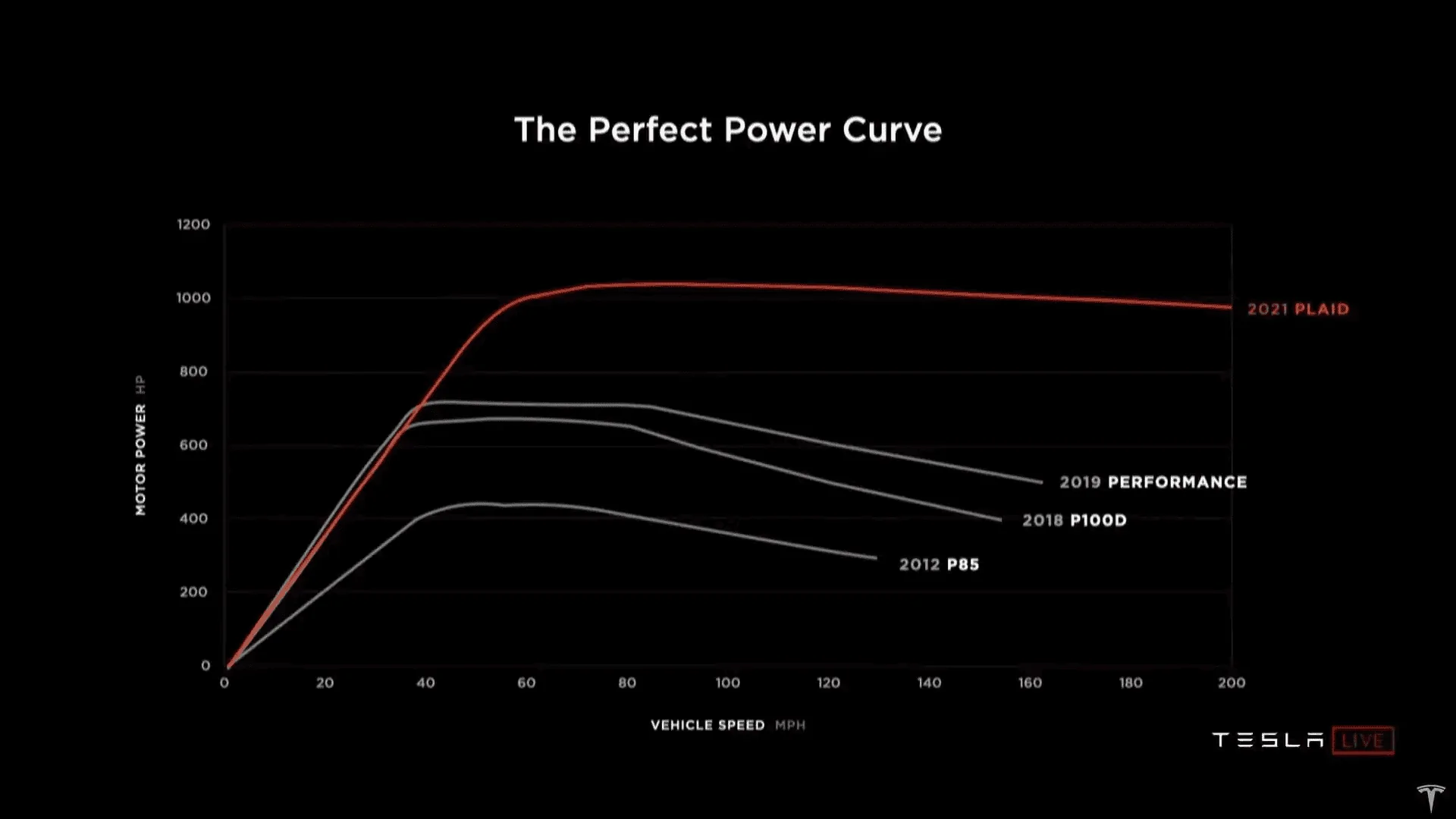

  • Further the Plaid power band now holds linear throughout most of the RPM range which no other Tesla models ever did. Power stays up even at high RPM/vehicle speed. Remember this from the Plaid release:
    Tesla Cybertruck Cybertruck timeline schedule prediction -- Agree or Disagree? 1660566971038
  • The taper no longer occurs because of CF wrapped motor that can operate at higher RPM without tearing itself apart, and with the higher gearing used.
  • Seeing there is only one fixed gear in Teslas, the graph above also demonstrates how the power develops with motor RPM. Now imagine the same motor, but with gearing configured to vmax out at 120-140MPH instead of 200MPH in a CT. The power curve will be steeper in the beginning and not quite so long, with oodles of power to run a CT at the traction limit (did you catch why I said that in the previous post?)
Anyways, hopefully you can see from the above that there is a lot more to it than just "adding motors" when it come to vehicle performance and in particular cost. 3+1 ≠ 4 or Plaid, especially not if one doesn't consider the motor types used.
Whoa! Not so fast. Backup.
Tesla Cybertruck Cybertruck timeline schedule prediction -- Agree or Disagree? 1A661024-8183-41D7-BC91-7DEB1305BA23
We’ve both played around with power, traction, speed and load. I’ve blown up my share of Chevrolet transmission casings, ring gears and traction components. From auto to 4x4 to truck drag racing, tractor pulling to field work we can tear shit up.
The linear supposition put forward that torque can gear down for “more” flies in the face of broken housings, traction arms, spun bearings and broken axels. I draw your attention to the “slope” of all plotted Tesla variants. That’s no accident - that’s engineering “margin of safety”. Put bluntly, don’t tear shit up slope.
Gearheads like us play either on a higher schedule curve or earlier and steeper the better. Tesla can’t. Well it can, but opens up warrantee, claims and service stats.
For that limiting factor, expecting Quad CT to regear torque, reduce motor design and increase rpm is inviting SHTF carbon fibre all over the highway. A trail of broken Quads out the Service doors is not the picture of success Tesla is aiming. “Quad” nameplate gets Tesla 90% way to top of class. Engineering can drop weight as you’ve documented getting Tesla another %. Software is the BIG win for Quad enabling true 4WD traction control without 4x4 driveline penalties.
THUS, color me surprised the day Quad is launched with a steeper slope, earlier rise in torque and more continuous horsepower. Because from my experience how much HP doesn’t buy you anything but straightline speed. How HP is delivered, controlled and applied determines the 4x4 winners. Cybertruck shouldn’t need 1000 ft. lb. torque unless its going to perform wheelies from standing start over 1/8th mile track. That’s one hell of a visual selling point but nah. That gearing, slope and torque as suggested would totally have wheelie races on weekends in the desert. Imagine FORD et.al. lining up to watch. I’d love that visual. But it ain’t gonna unless one of us gear heads makes it.

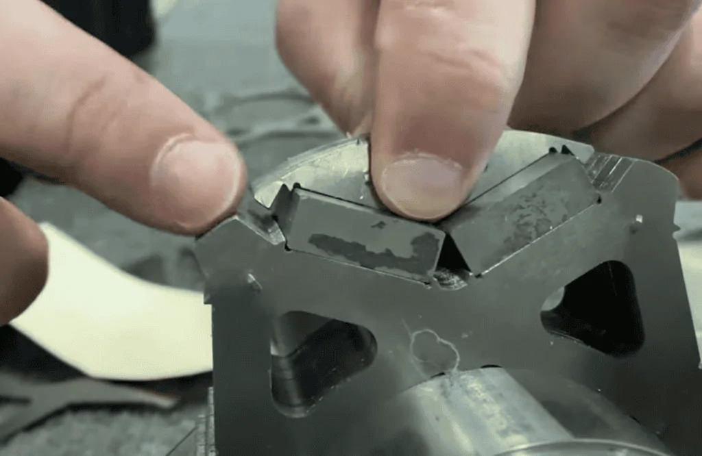

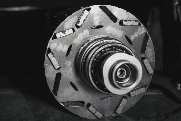

The plaid motors are very different than the non-plaid motors. Typical iPM motors use a circular laminate where the PM's are inserted into slots. The circle holds the magnets in when spinning.
Tesla Cybertruck Cybertruck timeline schedule prediction -- Agree or Disagree? 1660581775383
The Plaid PM motor laminates are a star shaped laminate. I have limited (but some) background in iPM motors. From what I've gathered, the air gap created by using separate spacers to hold the magnets in (and carbon wrap to hold the spacers) instead of using the continuous metal of the laminate to hold the magnets in is a big part of the "secret sauce" in Tesla's Plaid motors. So, although subtle to the lay eye, very different and significant.
When did CT3 die?
The graph is a power curve not a torque curve.
So no need to backup just yet. :cool:
I know about the star layout, didn't want to make it too technical, but how much extra cost will it be for the Plaid magnet/plate layout? "Secret sauce" doesn't mean expensive, and also doesn't invalidate the idea of only QM CTs using Plaid rotors. Let alone the silly $30k price for one motor.
They need the performance and efficiency it achieves to save weight and batteries for more range. That is also a cost saving, as its a total system balancing act.
