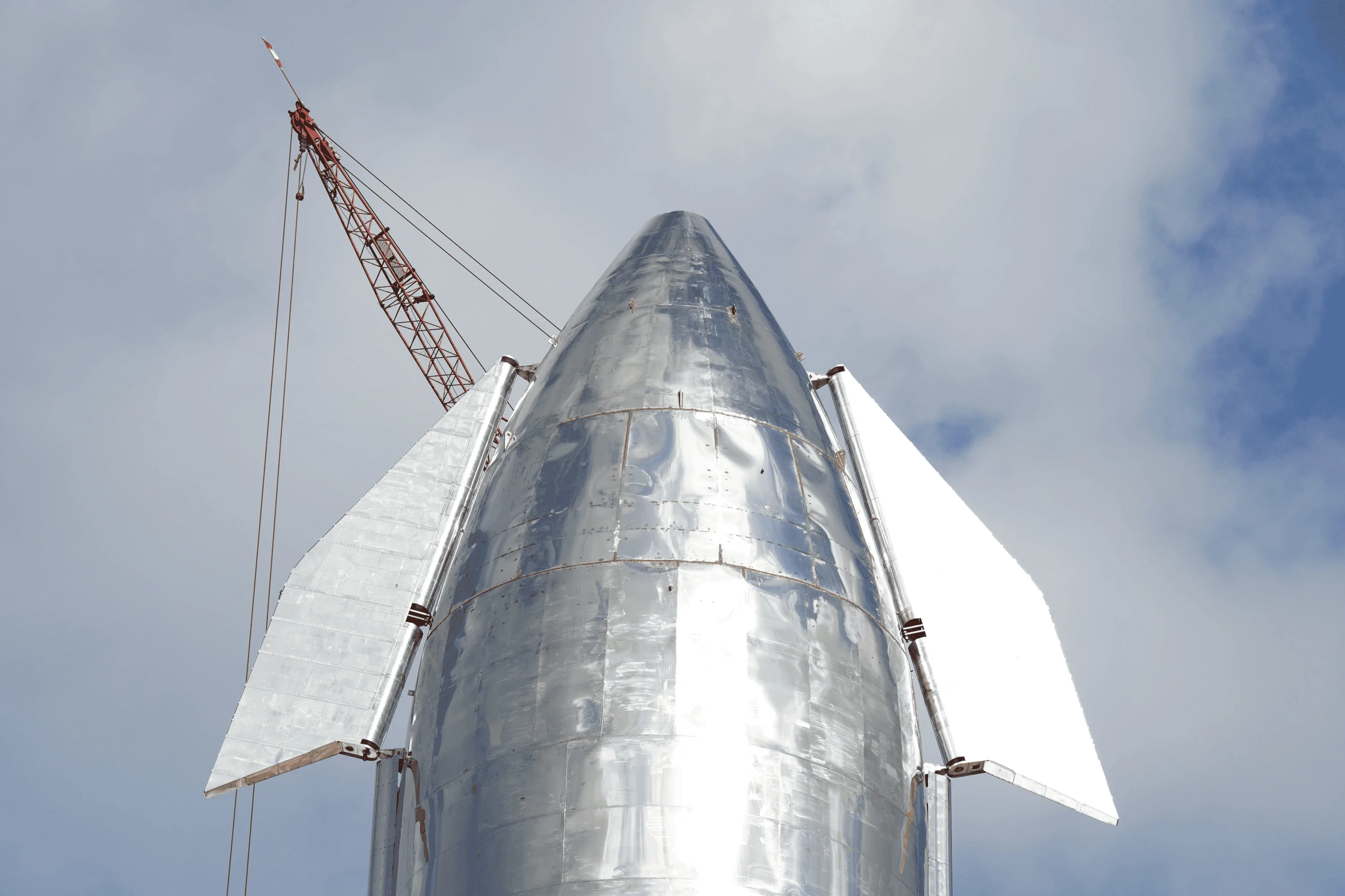

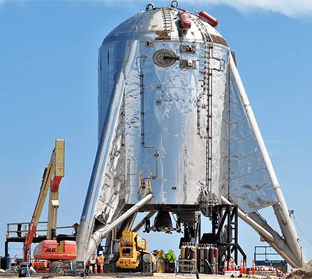

Star Hopper
Tesla Cybertruck Cybertruck Vault Sides 1683647534797
Early starship prototype

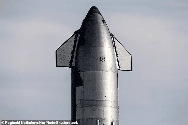

2023 Starship
Tesla Cybertruck Cybertruck Vault Sides 1683647466776
