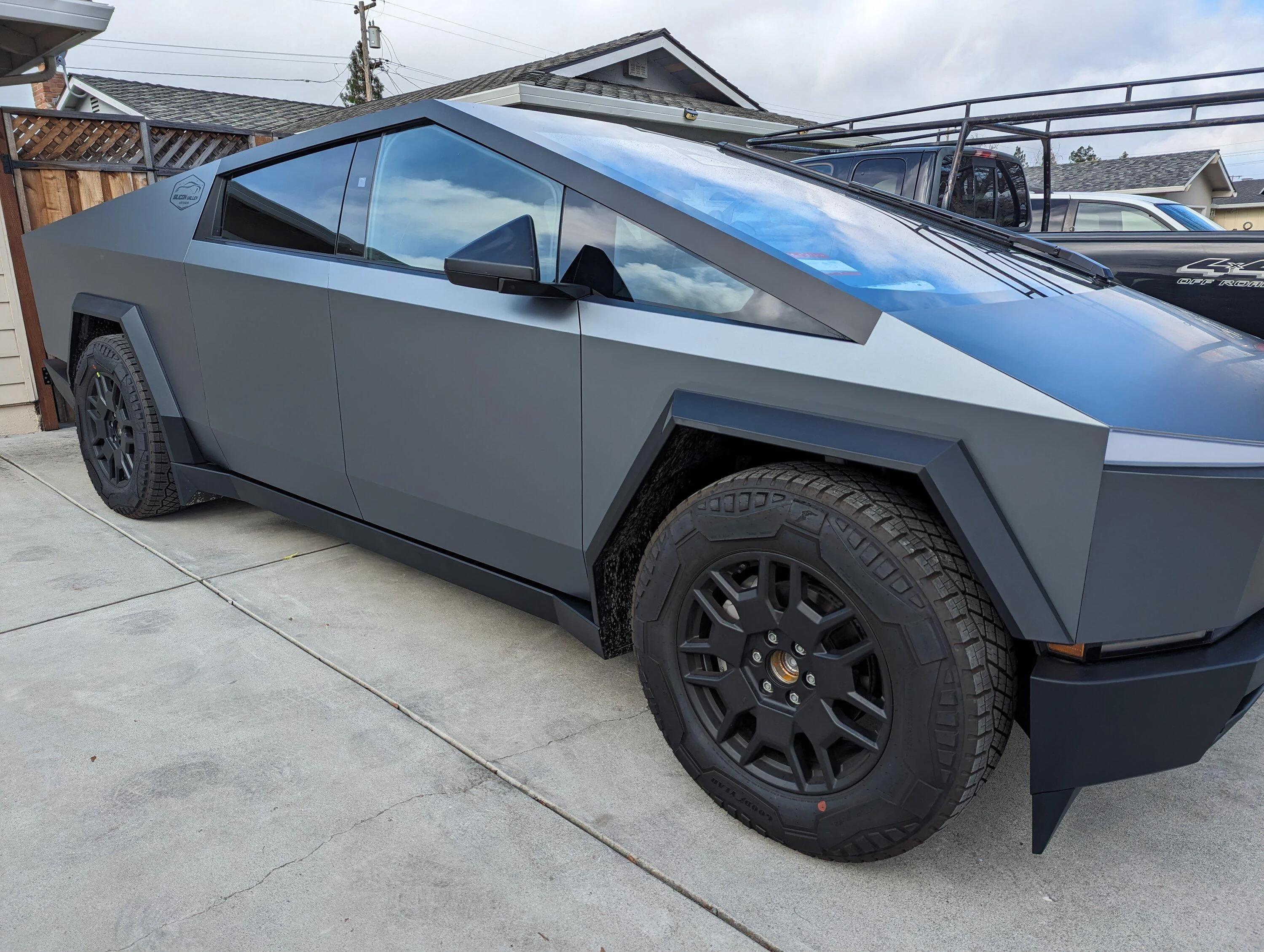

SanJoseNinjya
mikio
Dec 9, 2023
104
95
95118
CyberTruck
Love it! Looks very classy. This will definitely be in my top list to consider.
Thanks, I liked it a lot. its like silver and grey with a little blue-ish under the sun. PurePPF has a lot of Satin option. check it out.
Definitely. Thanks! It’s a weird coincidence - today morning I was thinking of how a grey silver with dark blue/copper tinge will look like. I think the universe has spoken. :love:
10,420
20,945
thanks! its Satin Bullet from PurePPF. I started enjoying rain with this wrap:)
