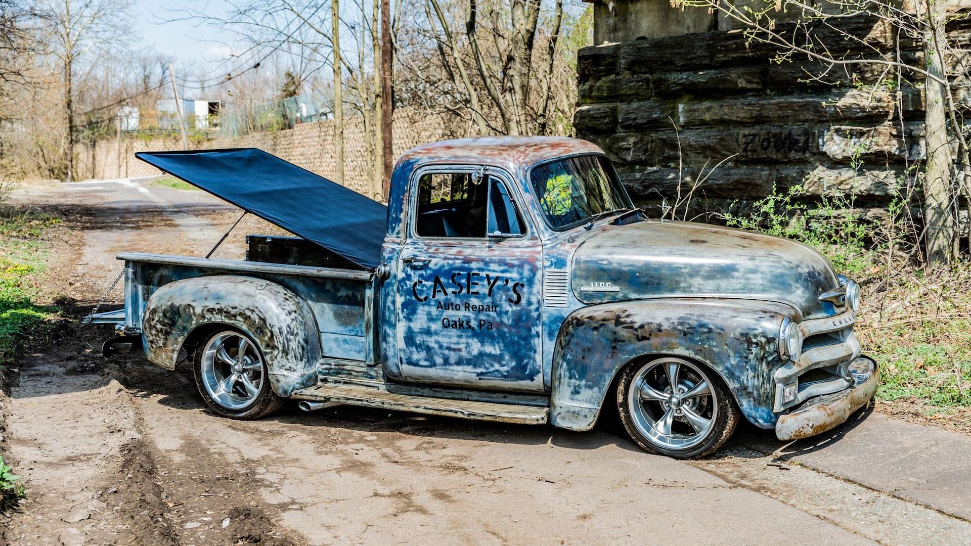

ALL metals oxidize…rust. Just because it meets the definition of being called stainless steel because it contains over 11% chromium does not mean there won’t be rust. The chrome oxidizes to make a protective surface. Often getting very dull and flat. It is simply the degree and rate of oxidation and how it looks over time. Based on the experience of new CT owners the stainless on the CT is easily marked up from finger prints, bird poop, dead bugs, etc….and should be cleaned frequently base on the CT manual to keep from becoming more difficult stains to remove, which may require repolishing the whole truck periodically. If you have ever polished a large stainless surface you would not say it is quick and easy. Getting a uniform finish is a bitch.
I understand that an unkept look won’t bother some die hard macho truck owners because it’s a truck and trucks should look like trucks. . Some people like patina too.
Personally I am learning toward a clear flat PPF to keep the stainless look and low maintenance on mine. My preference … not right or wrong.
Some people love patina……..preference.
OK, twist around the common meaning of words to try to say the Cybertruck will rust.
I will say it again, the panels on the Cybertruck will never rust in normal useage! Never. Getting a dull finish over time, developing a patina, is not rust! Unless if you want to redefine the common meaning of the word "rust". And it can be brought back to like new condition easier than getting it re-wrapped. About 80 times easier. No comparison really.
And, no, I don't consider myself "macho", I have just never wanted to spend a lot of time polishing my pickup. It sits outside and serves me, not the other way around. Most truck owners I know are like that. Yes, I know some truck owners think their truck is an extension of their masculinity, and if it doesn't look absolutely flawless at all times it will detract from their social standing, but that is delusional.
