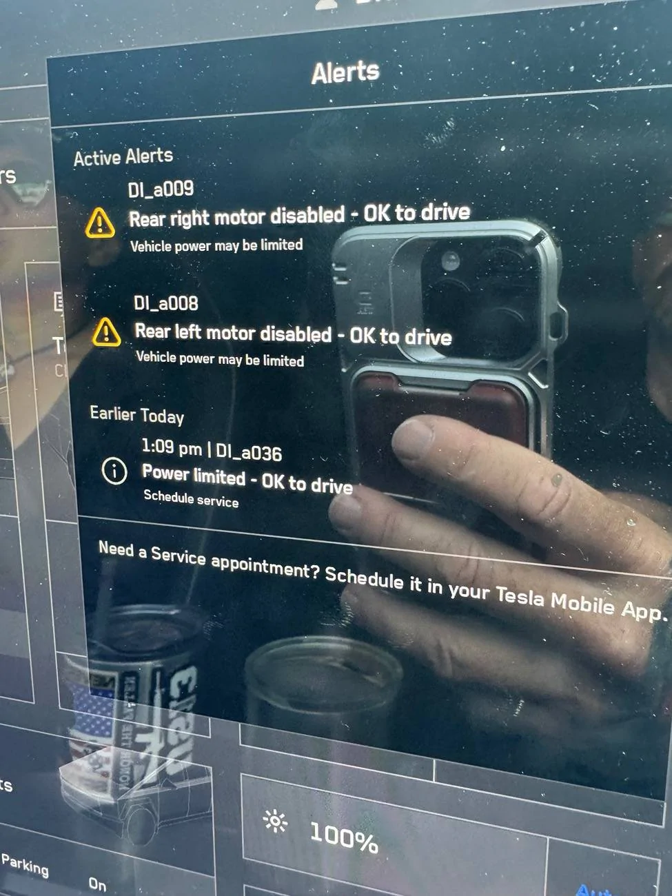

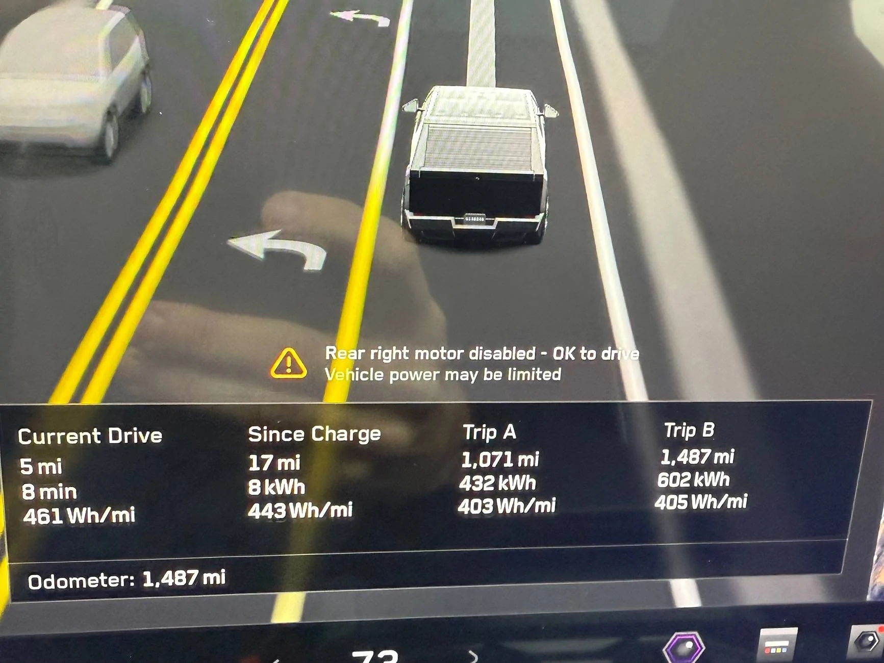

Truck has 1,487 miles on it and got the dreaded “Rear right motor disabled - OK to drive” alert and truck lost a significant amount of power. ?

This is a beast Im guessing? I believe this was the exact error that Kyle from Out of Spec received before his bricked. I would drive it to a service center and leave it there..

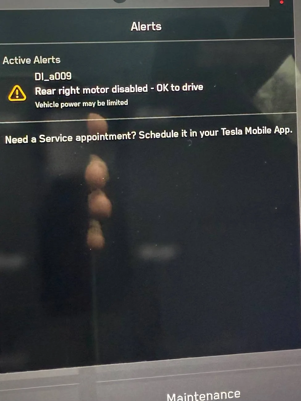

Just got my truck back from service with this note:
Repair Notes: Test drove vehicle and alert did not populate. Inspected vehicle vitals and found an alert for rear motor disabled. This issue is a known characteristic current firmware and will be fixed in future updates.
So apparently I am supposed to be ok when my truck goes into “limp mode” driving down the highway……

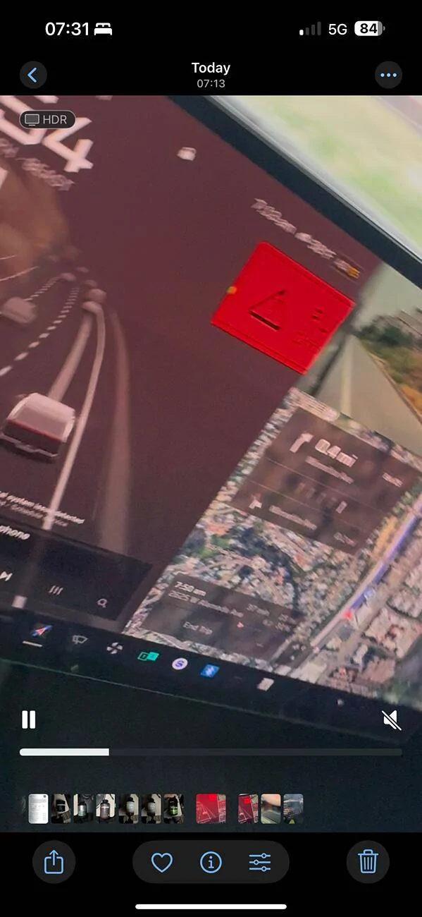

So I took the Beast to the TO Service Center on April 2. They inspected it a said it was fine. Got the RSOD “Red Screen of Death” yesterday while driving on the 101. Ended up completely powered off in Victory Ave during morning commute. No Hazard lights. Not a place to be during this political environment compounded with morning commute road rage. I suggest carrying flares. I carry them in my other vehicles but hadn’t any ordered for the Beast until yesterday.
Gigi over at the TO SC checked me in and I had reminded her I was there for the DI Faults on April 2 and they inspected it and said there was no issues. Before I left the SC she told me the DIs will be there on Monday? I love my Beast. TO SC has been good so far, Mike the Tow Truck Owner / Operator was awesome and knowledgeable as he owns two Teslas himself. Roadside Assistance Agent and the process was Terrible!
If any Tesla gets the “RSOD” it oughta connect to Roadside assistance immediately much like OnStar instead of me trying to give them an address (which there wasn’t any on Victory between Winnetka and Desoto). The app ask to confirm my Map position, which I did but the Roadside Service Agent asked for and address again! Meanwhile Hazardous Lights aren’t working, cars are honking and she tells me it’s a 60-90 minute wait for a Tow Truck.
This is unacceptable response time in a Major Metropolitan Area with one of the highest density of Teslas in the World!
Word of advice: Carry Road Flares.
Not only to place on the street to redirect traffic but also to carry as a Torch to fend off a riotous mob when they surround you so you can escape to safety.

Got the error again. Sending it back to service on the 7th. App shows “parts on order” so I’m hopeful they have a solution after reviewing the event logs.
