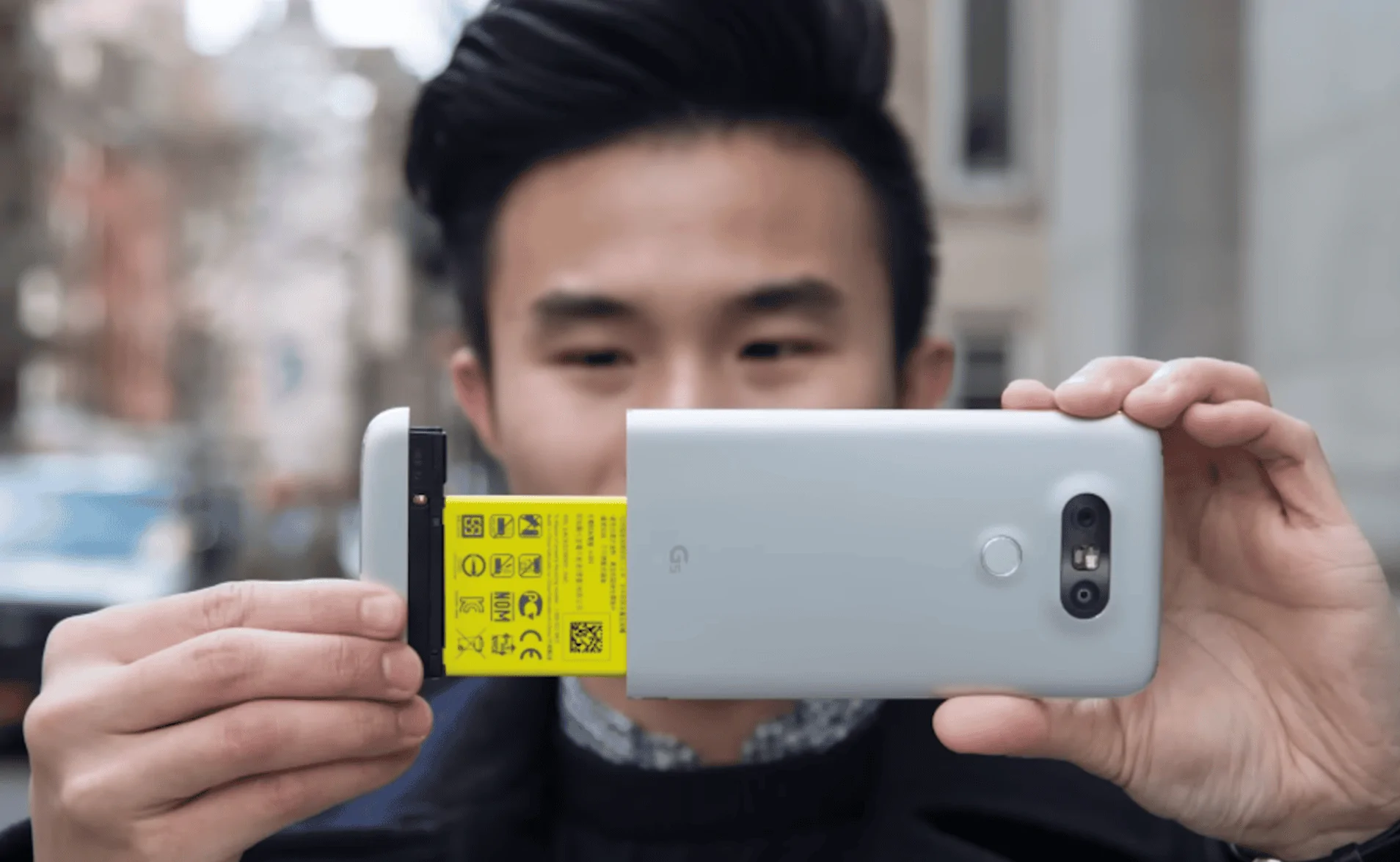

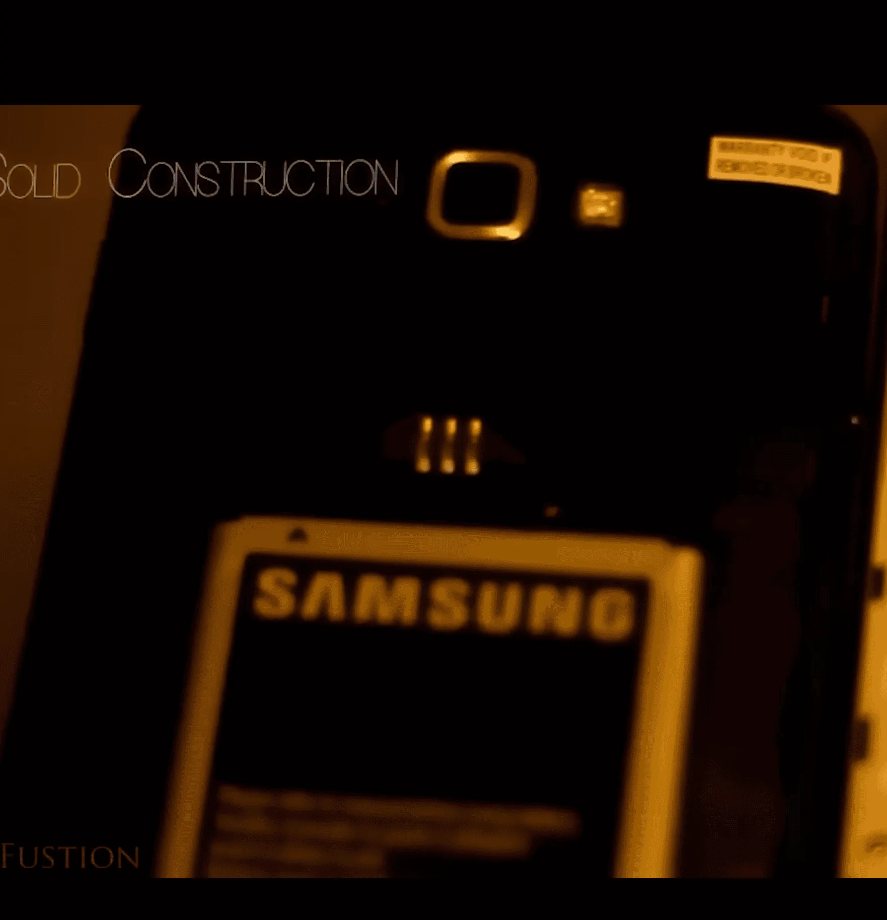

Replaceable batteries can't be used as structure,
Assuming you are correct, why do you think they should? I have owned phones with replaceable batteries and have never had a problem with their structural integrity. remember like this:
Tesla Cybertruck 20/80 Li Ion Charging 1698026994181
but If you don’t like this design, there are newer options to comply with EU requirements:
Tesla Cybertruck 20/80 Li Ion Charging 1698027111526
Even with EVs there are a Lot of them on the road with serviceable batteries. Granted, not serviceable enough for an average joe like me yet but serviceable enough so they are not all or nothing deal.
we can argue over whether one design choice is better for consumer or manufacturer but we can not deny there is a choice (At least for the manufacturer). I personally don’t mind paying a little more upfront to make sure my device is a little less disposable.

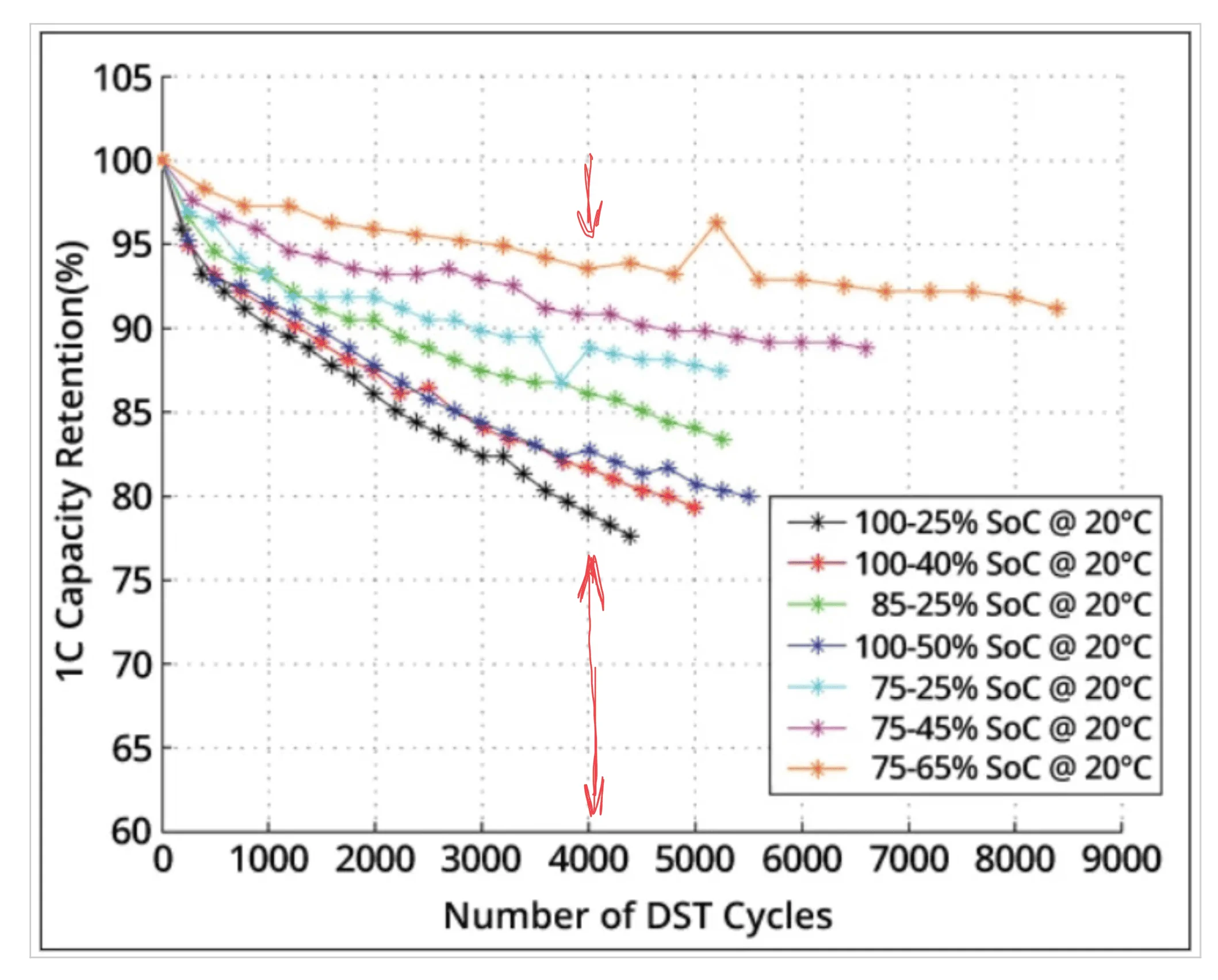

The less you cycle the battery state of charge the longer it lasts. The cycle life can be orders of magnitude more if you do this.
So recharging it often for small percentages is better than charging it seldom and only when at 20%. Same for driving it from 80%.
It's worth noting here that the 20/80 isn't a hard rule or point, it's just from where it gets considerably worse in comparison. Other factors like rate of charge/discharge and temperature also play a role in how often you can cycle a battery.
Basically the less extreme the conditions and state change, the longer they last.
But all this should be taken with a grain of salt, as many new batteries haven't even been around long enough to test full real-life life cycles. There's some data to support this though, and that has been extrapolated.
