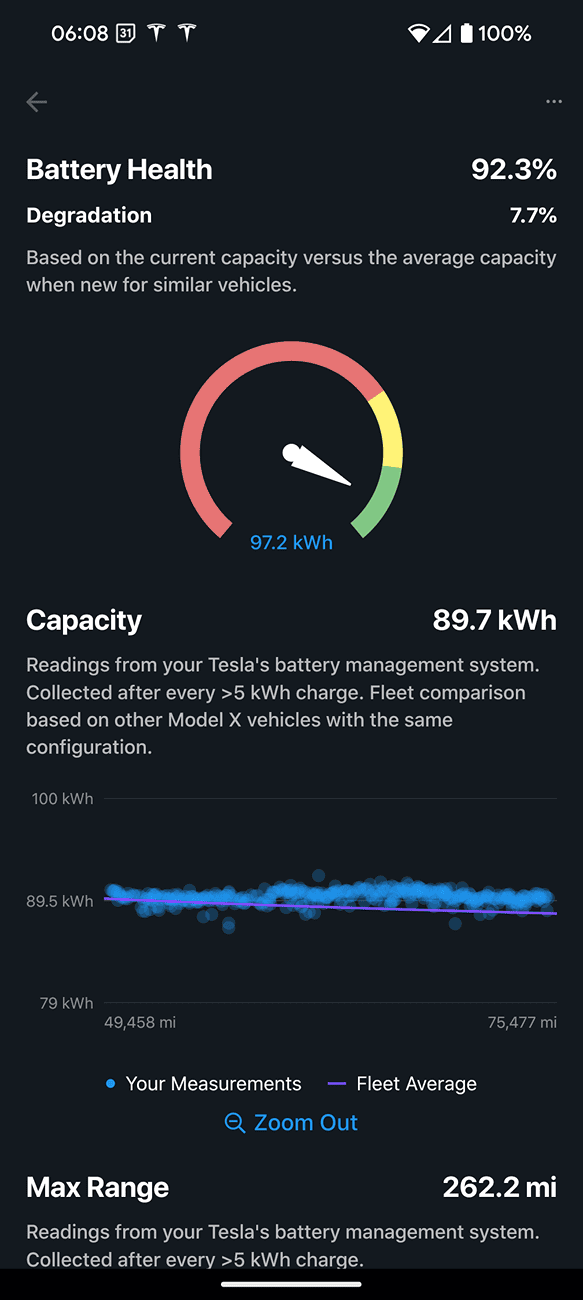

Yep no problem with occasional full charge. On my S I have 173 charges at 95% or above. 11% degradation after 290k. Enjoy the car/truck.
2018 model X, my wife charges to 90% every day, 100% charge for trips 20 x year = 100+ charges to full. 75k miles on it. 7.7% degradation.
Tesla Cybertruck What's the problem of charging your truck to 100% instead of 80% once in a while? Screenshot_20240713-060816
