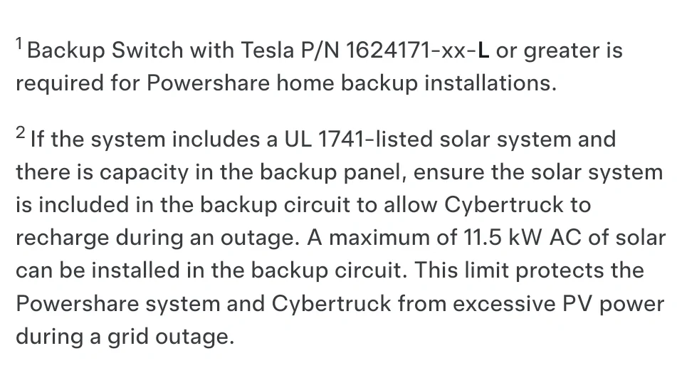

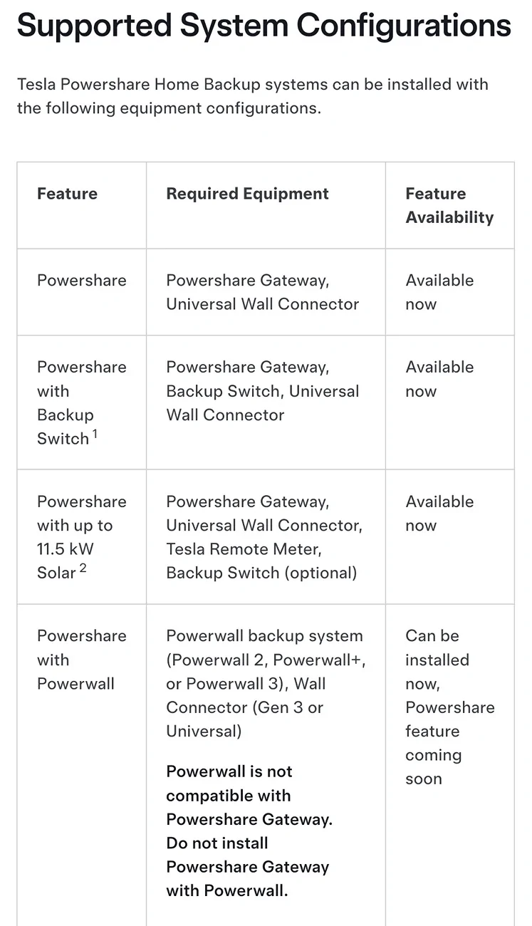

To confirm: you do not have Powerwalls, and they wired a backup switch to the UWC?
UWC, Powershare Gateway, Backup Switch, and 11.5 kW or less of UL1741 solar should be a supported configuration.
But the panel with the meter socket that it's plugging into is all ready outside the requirements from PG&E for the gas meter vent distance.
I'd also removed the gas meter from the property. So I'm full electric now.
Yeah, I didn't say they were right, just the only thing I could as a reason. Meter pulling is done by the PoCo who would know to check for gas. The backup switch could toggle at any time.
Not having a gas meter at all really should solve it!
Tanquen
Dec 9, 2023
394
235
You had said that a PowerShare gateway was required with the backup switch. That doesn't appear to be the case.
Sorry, not sure where the confusion is but I have the powerwall 3 with a backup switch with solar. I asked them if the universal connector was needed for powershare and then they added it but it wasn't originally in there and now that I've looked it up I've seen a couple different places that say it's not required for PowerShare when you're using a Powerwall 3.
