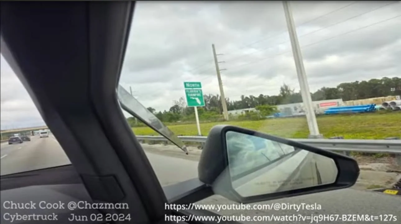

What's a cantrail? That part is called a roof rail trim and is held on by screws and nuts.
Tesla Cybertruck Driver-Side Roof Rail Panel on Our Cybertruck Was Loose – Fixed by Tesla in 20 Minutes rail
Tesla Cybertruck Driver-Side Roof Rail Panel on Our Cybertruck Was Loose – Fixed by Tesla in 20 Minutes nut
