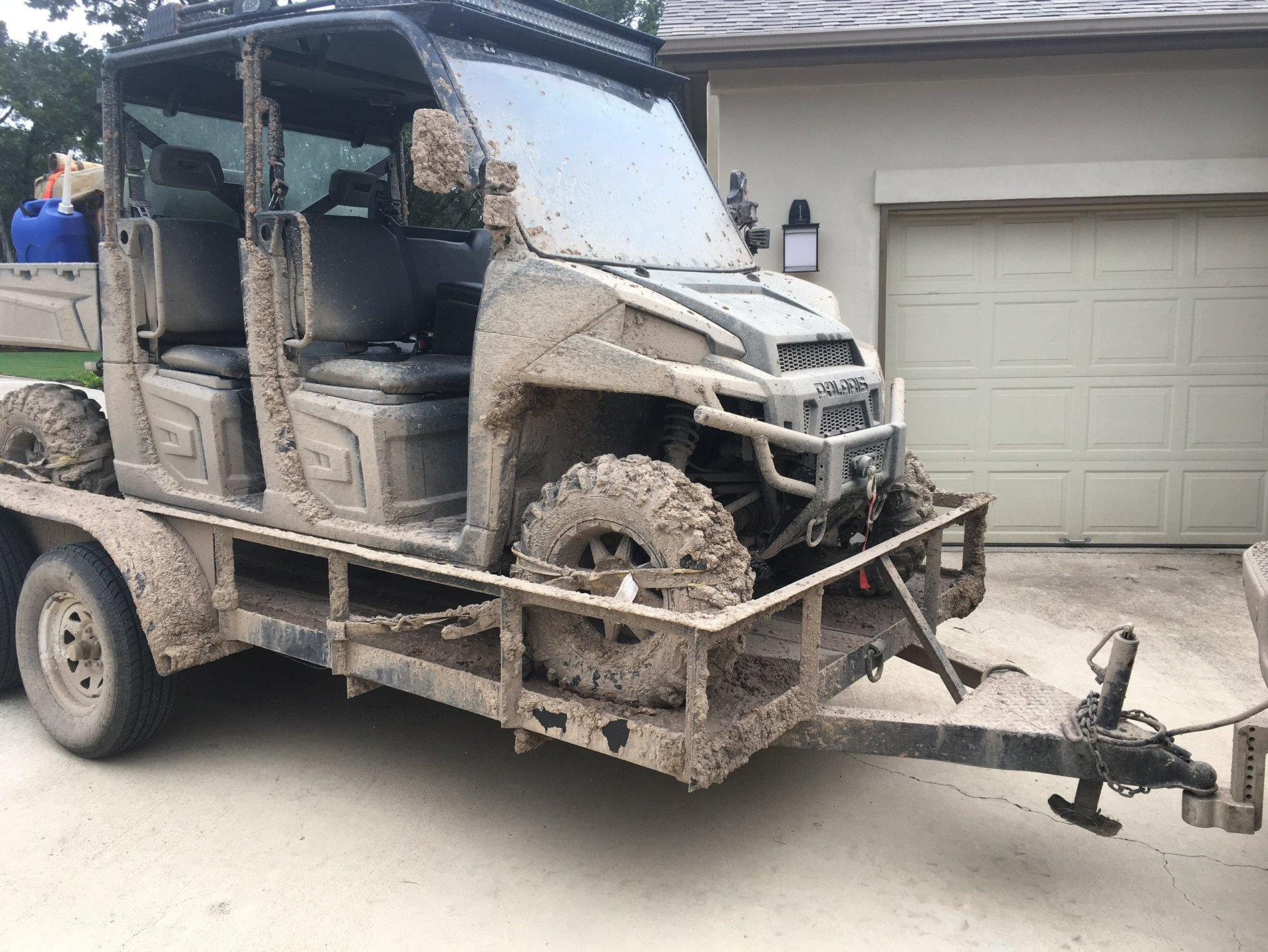

If you are talking about a 10k to 14k lbs travel trailer, I feel it would be out of my comfort zone to use the CT often for something like that for concerns about range. I don't tow that heavy ever with my current 3/4 ton so it's not an issue for me. For my purposes, I'm looking to pull a 16' low boy utility trailer with a side by side UTV and / or hunting gear, deer feed, etc on it. Most of the time that would be 6k lbs or less. Other times I would want to pull my duck boat, which is even less weight. With my current 3/4 ton truck I get about 70% of the mpg when pulling the trailer in the pic vs. not towing. If that translates to about 50 to 60% range for the CT, then I'll be golden...250 miles to 300 miles for the trimotor gets me anywhere I'd want to drive in a day without stopping to charge. On the one off occasion where I want to tow long distance in a single day, I would plan the trip to have a supercharger in the route and make lunch of the stop. If the self driving features for highway use are allowed while towing, that would be such a nice trip. I'd be way less road weary after the drive.
