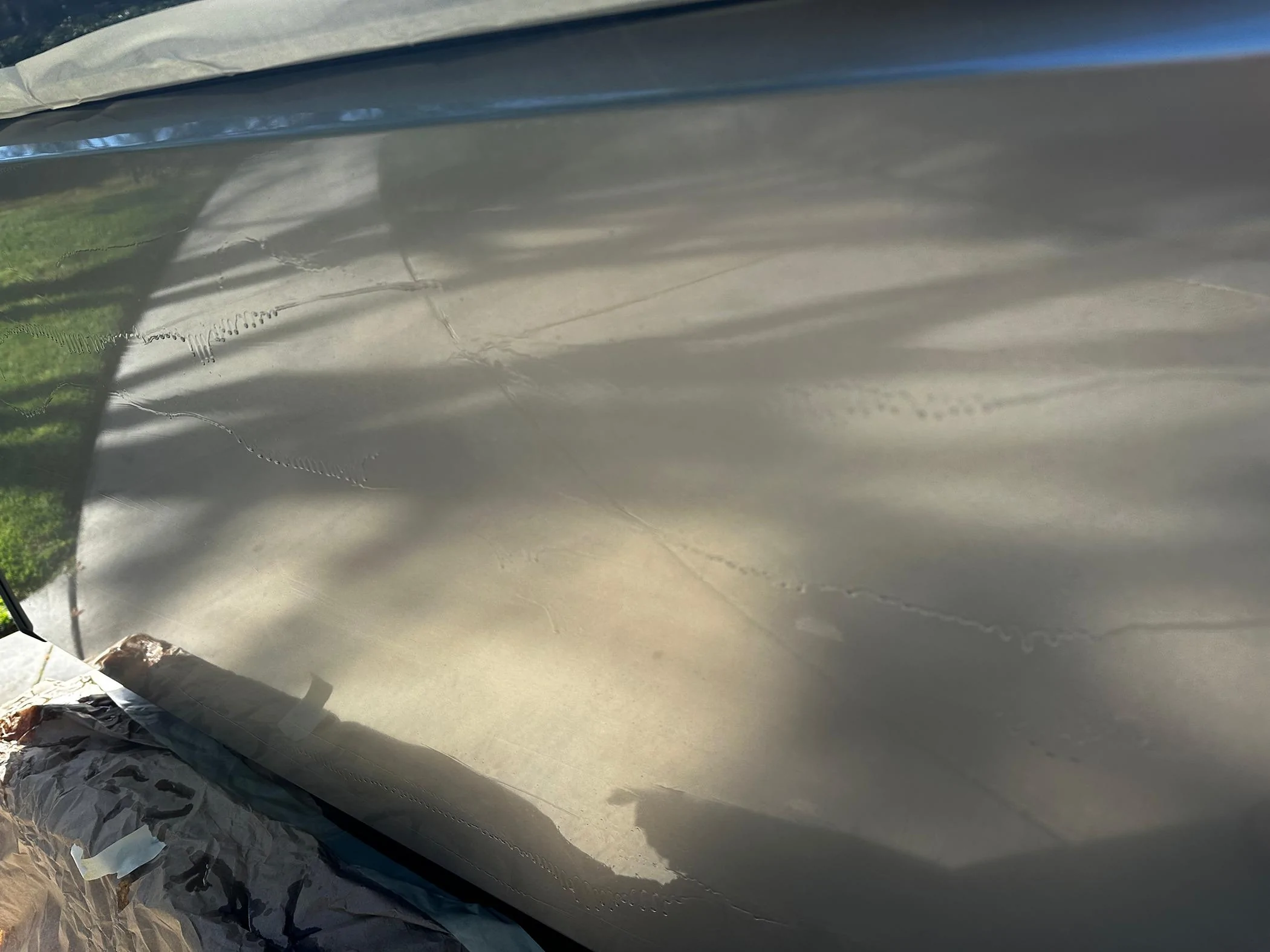

That is going to be hard to remove... (just looking at your photos) I feel sorry for you, because yes, that is a mess.
Mask the plastic and try some Lacquer Thinner. Also get a proper mask and angle a portable fan to blow the fumes away.
Or hire someone to do it...
Thank you ??? one of the worse mistakes I’ve made. Thought it would be fun. But I’m done putting more time into it.

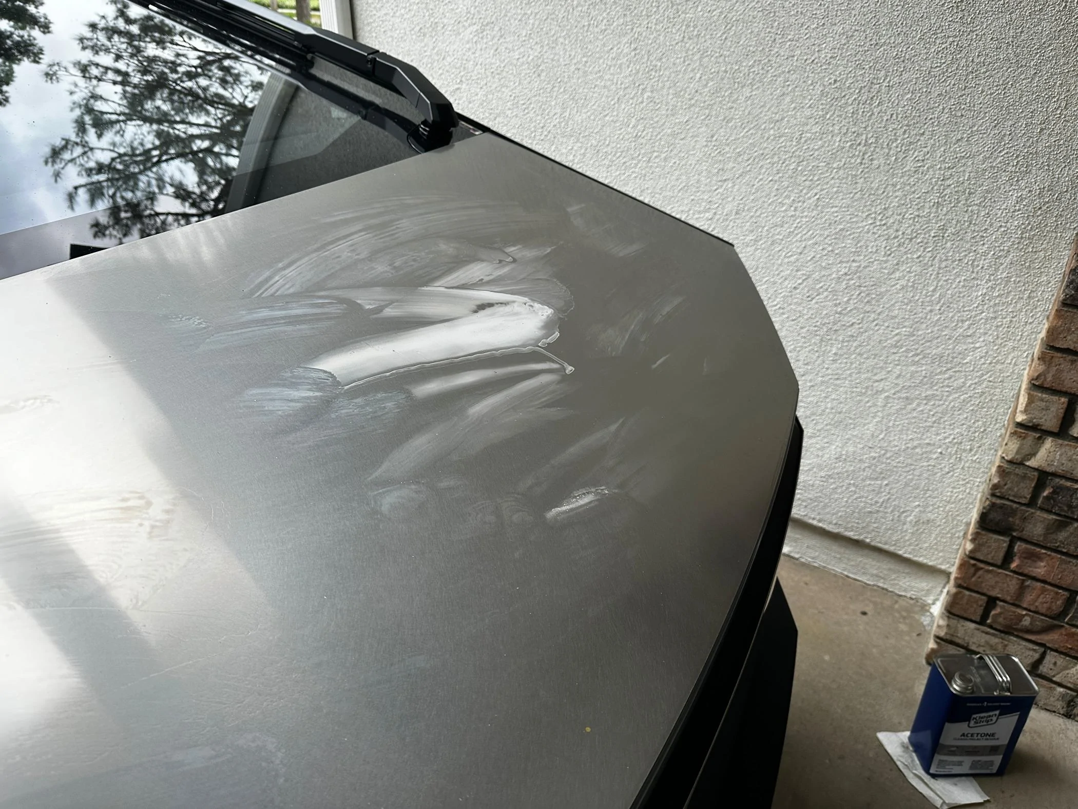

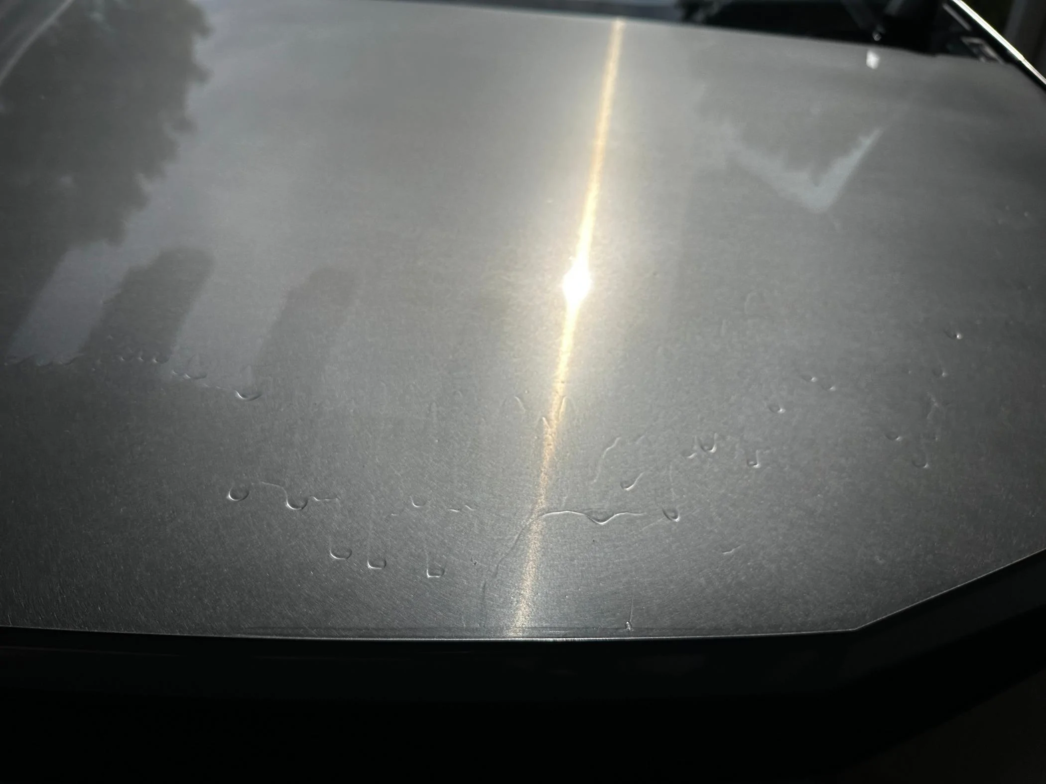

I absolutely love the stainless look and intend to keep stainless, but the fingerprints gave me nightmares. As much as I was excited and wanted the Everbrite product to work, it’s simply too much brain damage and way too much effort to apply. After over two months of fixing, stripping, re-applying, and trying all types of cleaning prior to application methods, I finally gave up. Here are my thoughts on each step of the process:
Prep
  • The EZP cleaning included did not clean the surface well, smudges, finger prints, and discoloration still exist afterwards
  • Rust remover was irrelevant as I started application right after taking delivery
  • This may not be the same barkeepers friend as the one I purchased from Home Depot, it left horrible streaks and did not remove everything
  • Windex and acetone prep was such a joy having to polish again and again for hours on end
Application
  • Saw the Everbrite video, saw the video from Bearded Tesla Guy and it looks so easy gliding on
  • In reality, it was like quick drying honey that dripped, smudged, and was impossible to keep an even coat
  • The balance between "rainbowing" from not enough coating and dripping from coated areas above was impossible for me to achieve
  • Coating looked perfect when coating but started to move and drip while curing - trying to fix it at that point was a huge mistake
  • When I contacted Everbrite with photos, the response “Was the coating poured directly onto the truck and spread?”
  • A bit disappointing after spending another $50 at Home Depot on gloves, two solution safe pans, Acetone, paint stripper, N95 mask
  • Xylene is not sold in California, Everbrite is located in California. They probably should have known.
  • The final product shown in the photos looks like I took a paint brush and went avant-garde on the truck
  • The coating dried way too fast with 68 degree weather under a tent, there’s no way to go back and fix anything while coating, too thick, too thin was the norm
  • Bugs loved it and a few decided to make the coating its final resting place while drying
The fix
  • Everbrite provided a few solutions, 1. use acetone to lighten the coat and re-coat 2. spot fix as it self heals 3. use the new applicators they sent
  • They sent another video on how to strip it (with no sound because it wasn’t ready yet) - same as before, looks so easy. It's not.
  • The two microfiber applicators they sent was even worse at spreading the coating than the original micro suede applicators

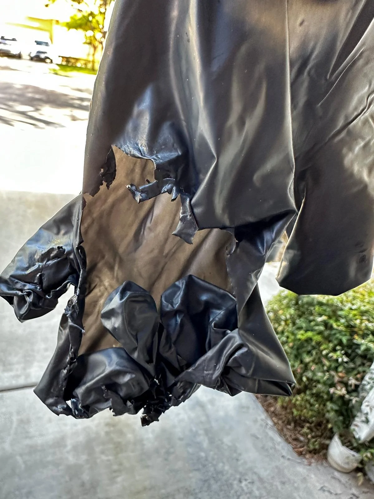

  • With application of acetone to fix, the coating turned into a sticky mess reminiscent of old bumper stickers at removal
  • Acetone melts your gloves, makes me nauseous, and as I’m writing this after trying to strip one panel, I feel sick
  • After a month, I just gave up
