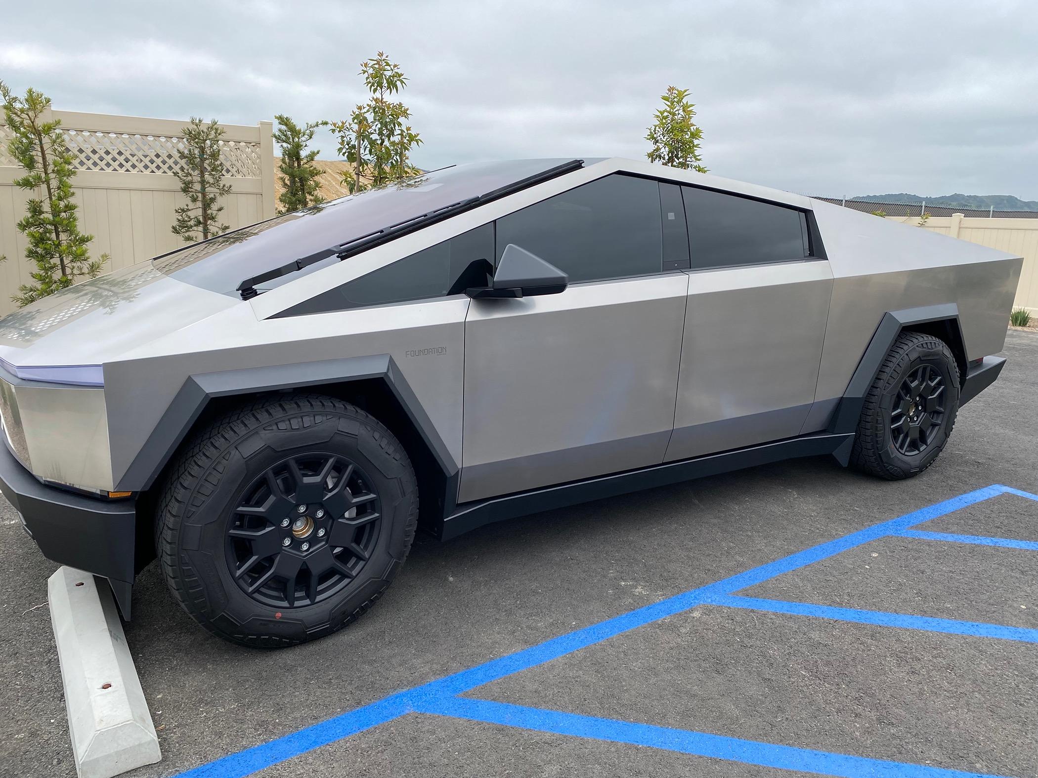

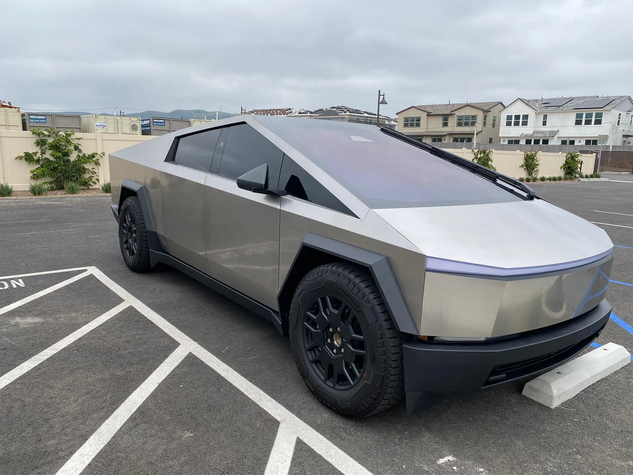

I just finished my second coat on my truck of protectaclear. Goes on really pretty easily. Takes about 45 minutes per coat. After the first coat I thought I might need to rename my truck "My little pony" with all the rainbows, but the second coat cleared it up. I did apply the coats light to avoid runs and such. Will see if some areas need a touch up here soon, but overall after the second coat it is looking great. Used a drywall mud pan to hold the liquid and bought suede applicators from Adams. You definitely can do this with one can, I did not come even close to finishing one, even though I protected some of my concrete floor with it when I dumped the open can over.....oooff!

Here are a couple photos. Maintained the stainless character well. I opted not to over polish the truck before application. It does look unlevel at times after application, but does seem to level out pretty well. There are a few spots I can see a ripple, I will probably hit them again with a new applicator sometime in the future. Curious to see how well it washes now. I plan to let the truck sit 4 days to cure well before driving. Not sure this is necessary.
