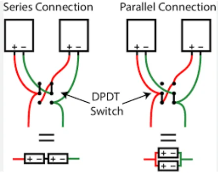

One thing I wonder is why can't you RAID 0 a battery charge. Meaning if you treat the CT battery as say 4 separate batteries where each can take say 80kw sustained charge in parallel, and get effective 320kw throughput charging?
That’s what I was suggesting too but it sounds like the smaller batteries heat up faster based on what I was told above.
The CT already does this. The 800V pack is actually two 400V packs.
That is not done for faster charging, it's done because an 800V pack could otherwise never charge at all at a 400V charger.
The limiting factor is each individual cell. Most EVs, on most 250 kW DCFC, quickly reach the maximum C rate of the cell. Splitting the pack isn't going to change that. The C rate limit is why bigger batteries can take more kW (at the same 250 kW DCFC), because they spread that over more cells.
