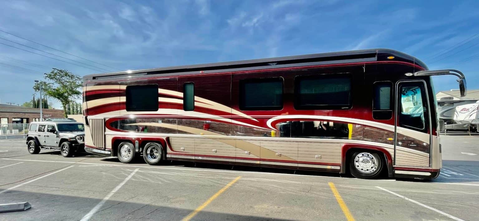

Do you guys think it is possible to flat tow the Cybertruck behind an RV?
Tesla Cybertruck Flat Towing Cybertruck with RV? IMG_1162

Lol. This is definitely a first world problem!
like most of them on this forum! Nice RV!
