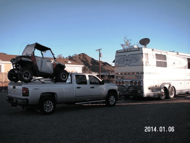

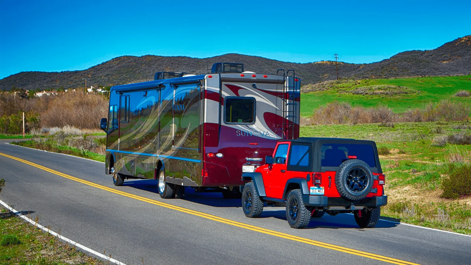

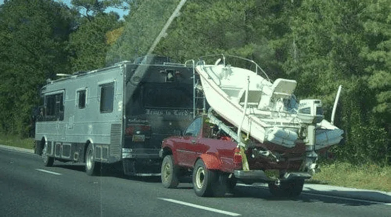

With a Tesla, where they can't disengage the drivetrain with a clutch, as they don't have them,
The Tesla Semi has a clutch that disengages two of the three motors to save energy when max torque isn't needed.
They have it, so they could disengage all the motors if they wanted to compete for the lucrative High Dollar Class A Motorhome segment who love flat towing large vehicles behind.
Semi has a clutch, but none of the current Teslas do, and as far as we know CT doesn't either.
If they go the smaller QM as standard accross the range route, hence also the new gen sub $600 motor drivetrain that has no rare earth metals. Which would mean they seem to be switching to induction motors again, where they simply won't need them anyway on the CT. Induction motors can free-wheel with minimal loses as you can turn off the magnetic feild, which you can't do with a PM as well.
