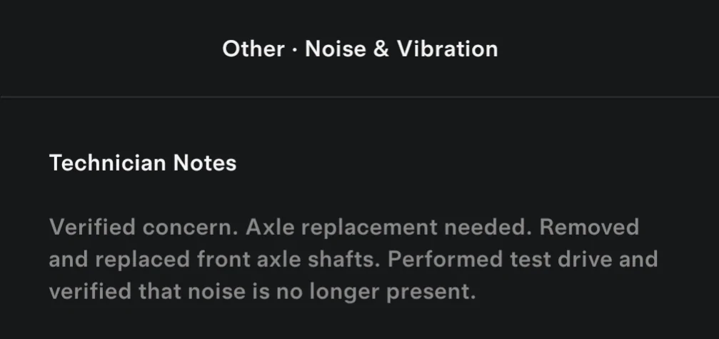

Hey group, just wanted to share some information on my recent problems after a front motor replacement incase anyone else experiences this.
Prior information:
- I originally received my Cyberbeast back in May.
- I experienced the same growling sound and feedback in the front motor that many others have.
- Tesla replaced the front motor in August.
Since the new front motor has been installed, the original growling sound and feedback is virtually non existent. On the flip side some new issues have appeared...
- When going through a load shift (coming almost to a stop and then starting to accelerate) you can feel the front motor engaging and also an audible thump.
- While driving, if you accelerate at any time, any speed, you can hear a clicking sound in the front right of the passenger footwell.
- This one is not reproducible. Occasionally when the truck is cold and regen braking to the first stop, you can hear three loud thumps.
I scheduled a service appointment and the truck is currently there. They said they are replacing the front axles and that those are the cause of these issues.
During this service appointment they are also handling both recall items (wiper motor and sails)
Do you have a dual or trim motor cybertruck?

Interesting. I had my front motor replaced due to noise/vibration. No clicking though. I did have one thump on engagement during my first drive with the new motor but it hasn't returned.
I had my front motor replaced a few weeks ago for the exact rumbling issue at low speeds (less than 10 mph). The problem is less severe but still exists. I’m just not going to push this further. The truck is so silent that these minute rumblings are amplified and audible. If it worsens in a year or so, I’ll get it checked again. It’s definitely annoying. Love everything about CB except this rumbling and sometimes high pitch fluttering from the motor.
