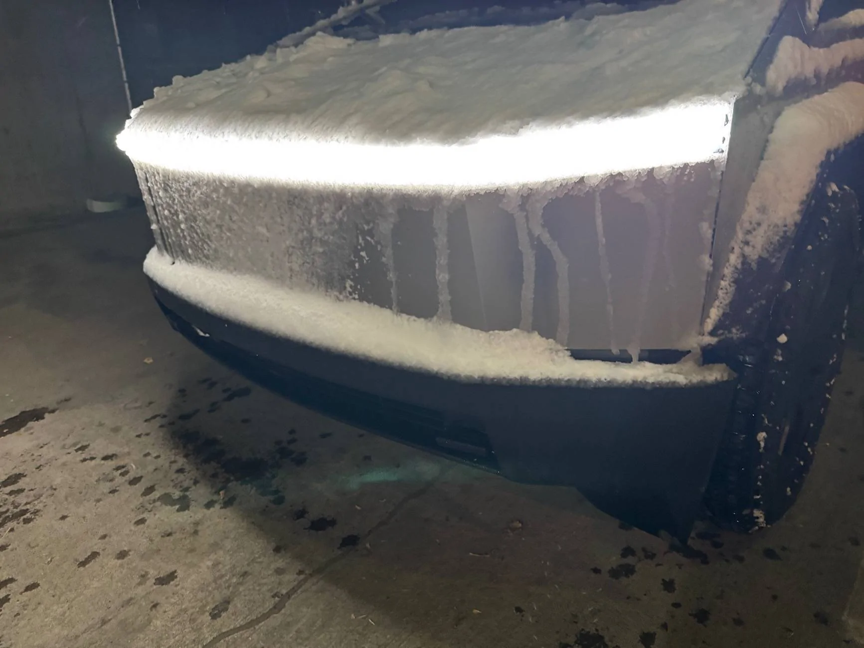

Frozen snow / ice blocked my headlights last night

No chains on the front? That's just... Dumb.
If you can't put traction devices on all four, you shouldn't be on the roads sometimes (California law).

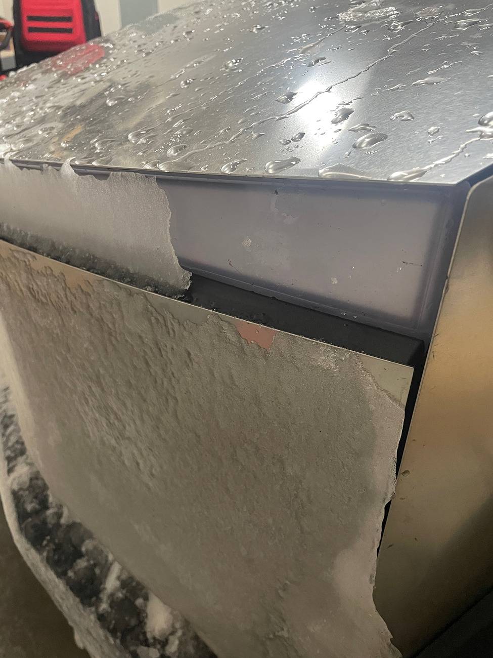

It's the "ledge" that is in front of the headlights that just invites snow/slush to sit there in front of the lights. I think only good solution might be a lower mounted light bar, or frunk mounted one like the ones from UP.
Maybe these from sportline: Tesla Cybertruck CTX Front Bumper Morimoto Off-Road LED Pod Lighting K - T Sportline - Tesla Model S, 3, X & Y Accessories
But you’d have to purchase the bar to use those lights. $5,000-$7,000 is Too expensive for some of us.

I experienced this issue last night without knowing what had happened. It had snowed while we were eating dinner (maybe a .5”), and it was still snowing while we were driving home. We couldn’t see anything once we left the lighted city street and headed onto the dark backroads. Having the DRL on while it was snowing and snow covering the headlights is a dangerous combination. This is an issue that I’ve never experienced with any other LED headlight vehicle I’ve owned.
There should be a way to turn off the DRL. Having it on while it’s snowing is like driving with your brights on while it’s snowing. It reflects off the snowflakes, creating glare, making it even harder to see.
Regarding the headlights, I’m not sure what solution would prevent snow from building up. The bumper creates a large shelf for snow to build up, so heating the headlights may not work well enough to clear all the buildup. Maybe a clear, heated insert that fills the shelf area would work.
We'll check and clear the headlights after it snows before driving next time, but snow building up while driving is dangerous and should be addressed by Tesla.

it’s not the forward facing issue that is the concern. That’s normal. It’s the recession that is unique and looks like it would pose a problem. And people are saying it does just that. It looks like it will fill with snow pack and not just coat with ice like a normal front facing light. Once cleared I’ve never had an issue getting coated by snow on a front facing light while driving, inky in freezing rain/ice storms. But with the CT if slush and snow kicking up in front of you packs in that open cavity in front of the led’s, that’s the problem and 100% isn’t going to happen to a light bar.
My 4Runner and Subarus with LED were not recessed at all and still had the issue, because they were forward facing and not sloped enough. It starts getting covered with wet slush, freezes, then new stuff quickly packed on top.
Solution: don’t drive at night during snow storms. I understand some can’t avoid it, but it’s not worth the myriad of other risks besides headlights.

I gotta tell y'all. I have 3 other ICE trucks. When we get a heavy wet snow, they all have the same issue as the CT. Yes, they all have LED lights. It's generally a problem in Fall and Spring. I cant tell you how many times I had to pull over and clean my head lights. It par for the course with LEDs. I can't tell you even how many times I pulled over to clean my windshield due to built up heavy snow.

Heavy blowing snow and slush froze over my headlight bar last night. It was very difficult for me to see while driving. Turning on the brights had no effect.
I turned on my hazards and followed the road's tire tracks *very slowly* to get home.
Anyone else experience this? What's the solution?
